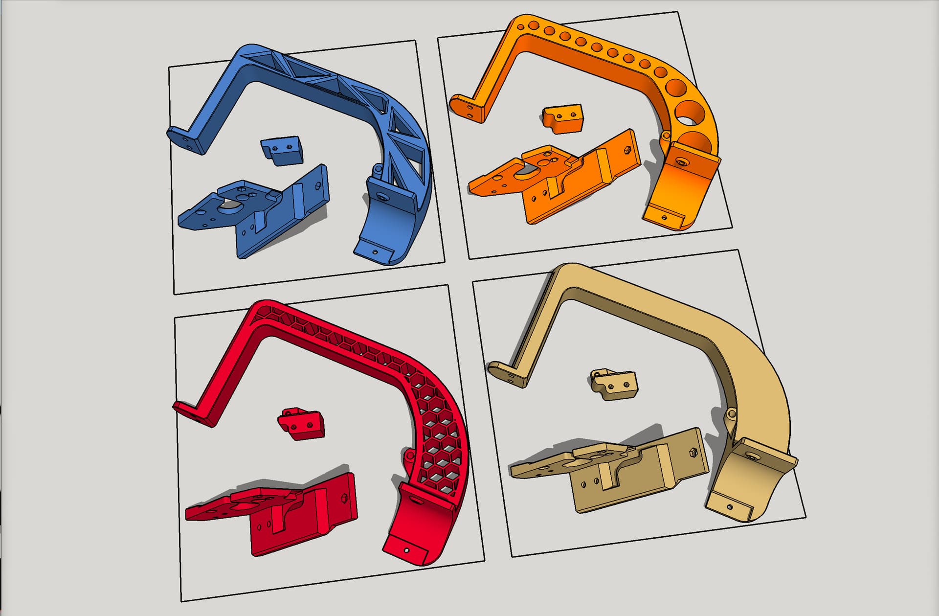

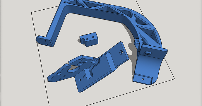

I made a popular remix that includes a side mounted spool holder. The place where the spool holder attaches, takes into account a vertical guard plate from the DIY enclosure, and is made to work without modifying the existing DIY enclosure parts. Note: I am very close to publishing a revision of the side mounted spool holder that attaches with 2 screws instead of 1, for better rigidity and usability.
Also, I remixed a new minimal version of the enclosure, that prints in less time, uses less plastic, and in my opinion is better in substantial ways. I now have three of the AD5M printers, and two have the original DIY enclosure, whereas the third has my new remix of the minimal enclosure, and it’s just nice. It makes any maintenance work easier because the top is so much easier to remove (no wiring ribbon cable threaded through a slit to a relocated touchscreen, and no camera cable threaded through a hole to a relocated touchscreen). It’s better because if you have/get the AD5M camera (which is for the Pro version but can be bought and installed on the non-pro version - and its video feed can be displayed remotely in either of the web-based UI choices available if you do the unofficial Klipper mod) it does not need to have a modified mount to get its wire cable to be long enough to reach a higher position of a relocated touchscreen, and better because the touch screen does not have to be moved – it gets to stay in the stock position, which is nicer in all ways. My new remix of the minimal enclosure made several improvements on the great work from the person whose work I based mine on, and it will have the new side mounted spool holder with it. Watch my account on Printables for this soon. https://www.printables.com/@design8studio

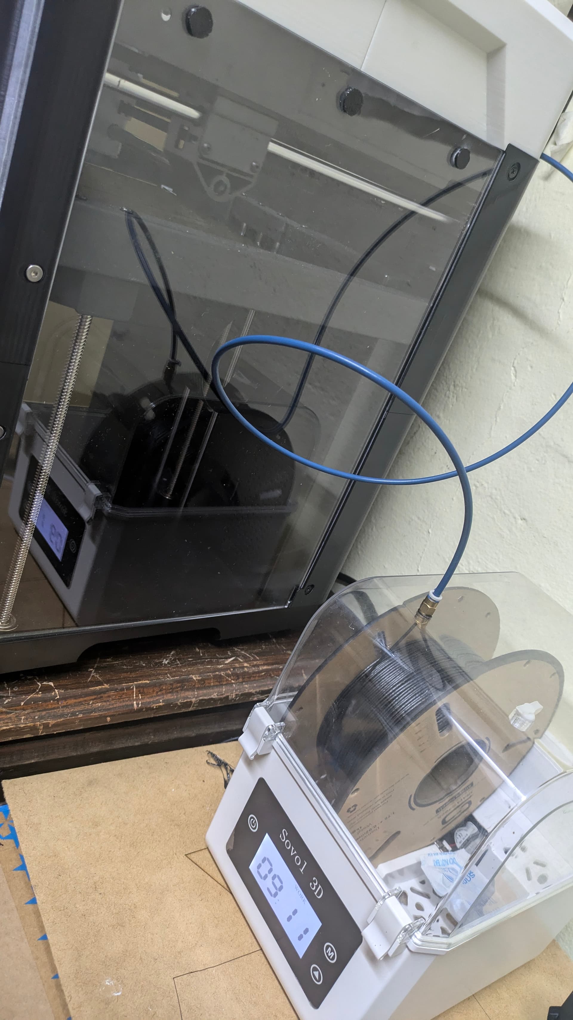

I went the route of using an old capricorn tube to link my filament “dryer” -that’s more a maintainer after you dry the spool elswhere- to the filament runout sensor directly. Planning to use the spoolmount to fix another thing in it

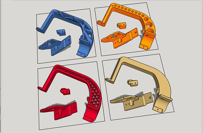

New, improved remix of my popular side-mounted spool holder, four cosmetic variations to choose from. Click for the printable files.
