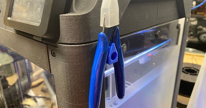

Flashforge Adventurer 5M (AD5M) Side Cutter Mount
This short explainer video is less than 1 minute long:
Printables link:
https://www.printables.com/model/834011-flashforge-adventurer-5m-ad5m-side-cutter-mount-v1
Side Cutter Mount adapted for use on the Flashforge Adventurer 5M (AD5M) with the DIY printed enclosure.
One model suits the front right or left, while another model suits the back right or left.
Choose front or rear (side mount on either), and then…
Print as oriented. No supports needed.
Remove the existing M4 screw holding the top of the printed guard. Replace it with a longer M4 screw so you can mount the holder. Suggest M4 x 10mm, but you may be able to use 8mm or 12mm.

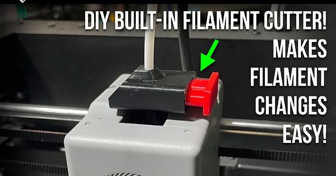

https://www.printables.com/model/886714-flashforge-adventurer-5m-ad5m-filament-cutter-comp
Assembly Video
This assembly video is good. I did not make it, but it’s quite valid for my remix too. It’s one that mine is based on:
Installation Video
Instructions for assembly and installation
Assembly
  1. Print both parts (cutter body and cutter button). If you are unsure which button to print, go with the medium one, marked 0.7 slot.
  2. Take one piece of snap-off blade and put it into upper part. Use some pliers to avoid an injury. There is a small mark near blade pocket which shows you where the tip of the blade should be. Additionally you can use super glue to fix it in position.
  3. Put both screws into the holes.
  4. Put ball point pen springs into the holes.
  5. Place the button on the main cutter body and press it fully.
  6. Tighten the screws. Be careful not to over tighten.
  7. Release upper part and check if blade is not visible inside the filament hole. If it is, then loosen the screws a little bit.
  8. It is recommended to put some lubricant inside to keep the mechanism running smoothly. Here’s an affiliate link to some lithium grease, which is a good choice.
Installation without DIY enclosure
  1. Withdraw the PTFE tube from the AD5M extruder / hotend assembly.
  2. Cut the existing filament using your side cutters that came with the AD5M.
  3. Insert the assembled filament cutter, with the button facing to the left.
  4. Insert the PTFE tube into top of the new cutter.
  5. If the PTFE tube is now too long, cut some off, and then reinsert.
Installation with DIY enclosure, assuming you are using my drag chain termination part available here
  1. Loosen and remove the two screws that hold the drag chain termination in place. Save the screws for re-use. Temporarily place the drag chain termination to the side.
  2. Withdraw the PTFE tube from the AD5M extruder / hotend assembly.
  3. Cut the existing filament using your side cutters that came with the AD5M.
  4. Insert the assembled filament cutter, with the button facing to the left.
  5. Insert the PTFE tube into top of the new cutter.
  6. If the PTFE tube is now too long, cut some off, and then reinsert.
  7. Reinstall the drag chain termination using the two screws you saved.
