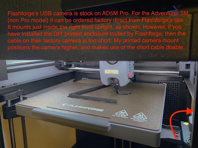

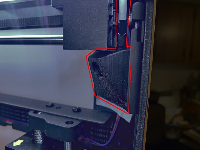

The camera I ordered from Flashforge for this printer… was initially out of stock, but it finally arrived. One hiccup is that the DIY printed enclosure they offer files for, raises the LCD up some, and the USB cable on the camera is not long enough to reach to the new location. However, I was able to model a printable mockup of their injection molded camera holder, and then make a modified version of it, that raises the camera up just enough to make the USB cable long enough. Klipper is working great with Klipperscreen, Mainsail, Moonraker, Fluidd, etc.
I also worked out a modified print profile for the one and only brand of PLA that had trouble at the full speed settings, so now I’m getting good results with all the filament I already had, and almost all of it prints at the super fast settings.
Above, I mentioned I designed an extended camera mount that allows the too-short USB cable to reach the LCD even when the DIY printed enclosure is installed. I’ve now published the design for that on Printables: Printables

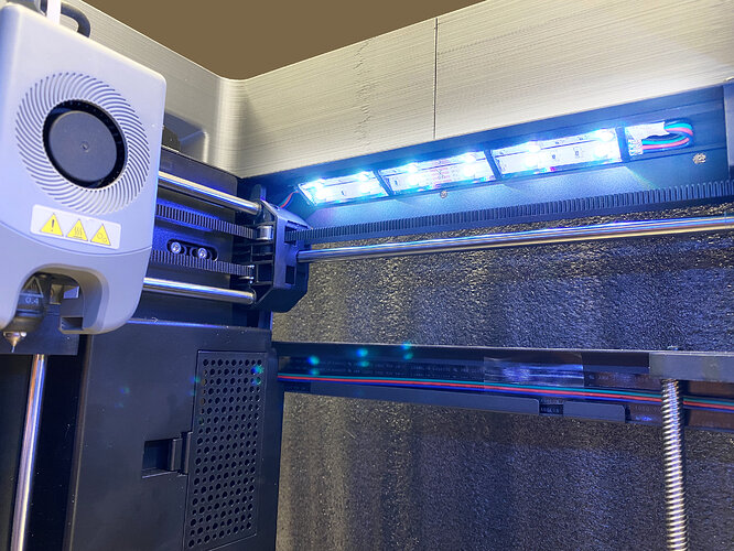

Speaking of DIY time, I’ve added LEDs to mine on front and both sides, and I had to DIY a mount to get their USB camera installed. But really like my setup. Only thing I wish I had done differently was use “warm white” LEDs. The ones I had laying around here and used, are a cool white, and it puts a bluish tint on everything. But at least I can see in there.

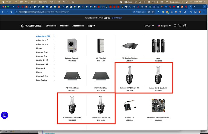

I was looking at theses as well. Since you have one can you answer a question? Can you just change the nozzel( metal end only), or do you have to replace the entire removable part?
As you may know, Flashforge has a nice quick change feature for switching between nozzle sizes and types:
The AD5M printer comes with the 0.4mm nozzle as stock. The Pro model comes with both 0.4mm and 0.6mm.
When I ordered my AD5M, I ordered separate 0.6mm and 0.8mm nozzles to have also.
If the question you are asking here is, “If the nozzle end of this removable quick change assembly needs replaced, can I replace only the nozzle and keep the rest still intact?” then I don’t know the answer to that, and I have just now posed that question on one of the listings (this one: https://www.flashforgeshop.com/product/0-4-mm-nozzle-kit-for-adventurer-5m-series?cID=31).
Yes, That was my question, Thank you. I like the idea of the quick change, but not sure I’m sold on it.
It the heater included in the nozzle assembly?
Yes. The quick change module has a 4-pin wire connection on it, and a heater is inside each one!
