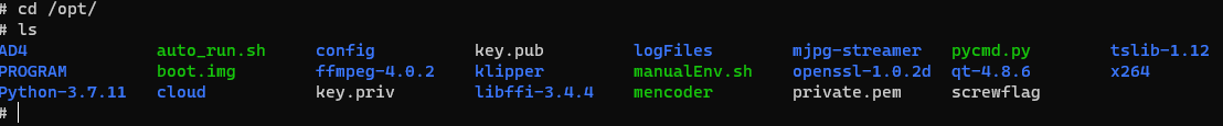

This is a embedded Linux distribution created using Buildroot. this Linux system has some basic Linux commands and applications.
r/FlashForge - Adventure 5M root access
Klipper is located in the /otp folder
