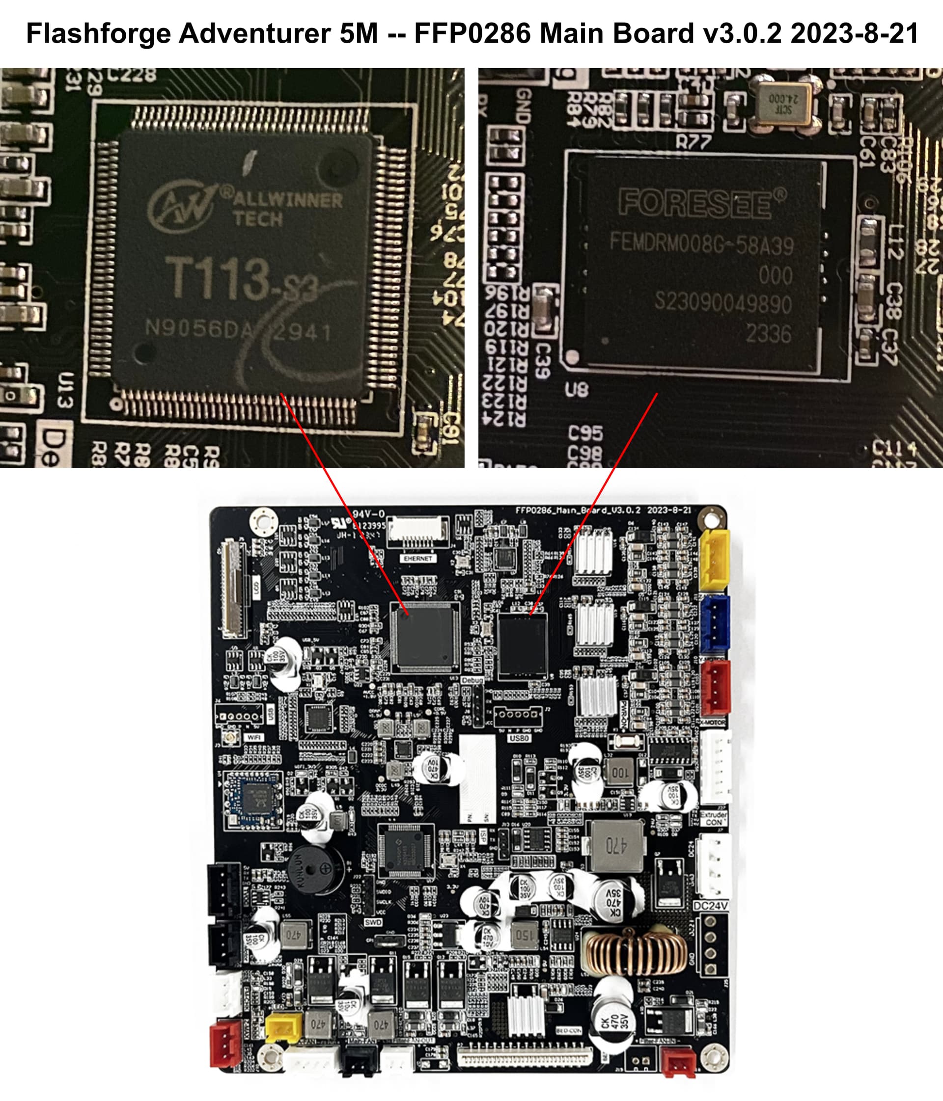

There are main boards that have pico chips on them, that’s the Pi. Or it could have an actual pi like a manta does. I don’t have it in front of me to look at but I’ve never heard of klipper being installed on a standard 32bit board. Its always on some kind of pi variant. It doesn’t have to be a separate board to work. Now in saying all of that I could very well be completely wrong.
(https://www.reddit.com/r/3Dprinting/comments/17oagwu/flashforge_adventurer_5m_pro_motherboards/)
He mentions the hope to connect it to a pi, so I think that is that.
Would it help for me to post pics of the board?
My current thinking is that the part of Klipper that goes onto a main board, as “firmware”, (as in klipper.bin or firmware.bin) is on this thing’s main board, and the part of Klipper that goes into a Pi, is on the LCD of this thing. I could be wrong, but that’s my thought right now.
Pico and full Pi are different classes of compute capability. Pico is a beefy microcontroller, but still a uC.
Klipper host isnt going to run on a pico.

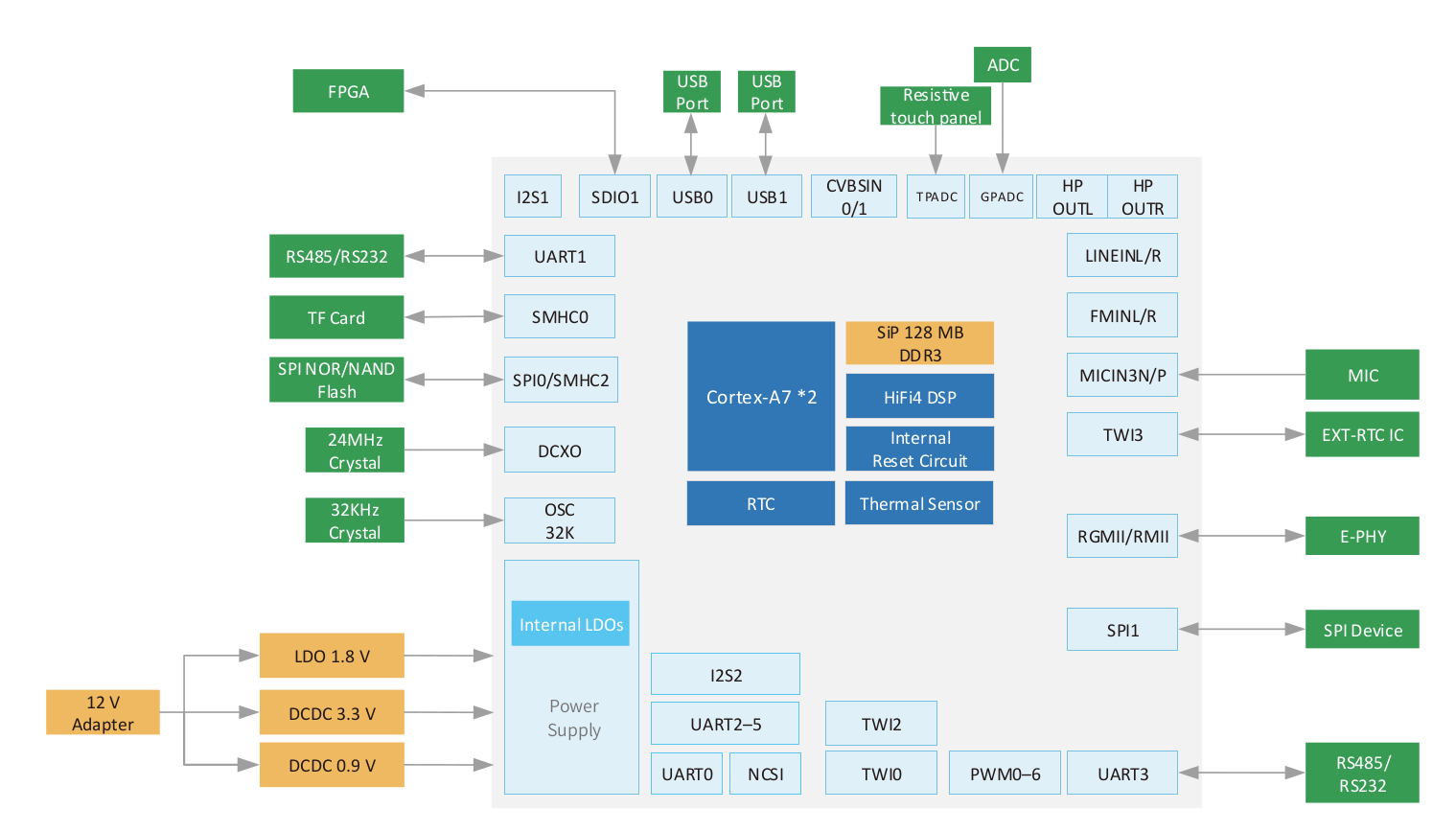

An allwinner T113 is a dual Cortex-A7. There’s your compute platform. I don’t know if it kas a Klipper style host, but its likely this is the application processor.
post a picture of the display mainboard.
Edit: the T113 is targeted at embedded (automotive) applications, and has a long-lifecycle (10 year) support timeframe. It’s a bit short of RAM for a full up Klipper plus extras. Still plausible that there’s additional compute on the touchscreen. Or, this may have some other embedded printer firmware.
