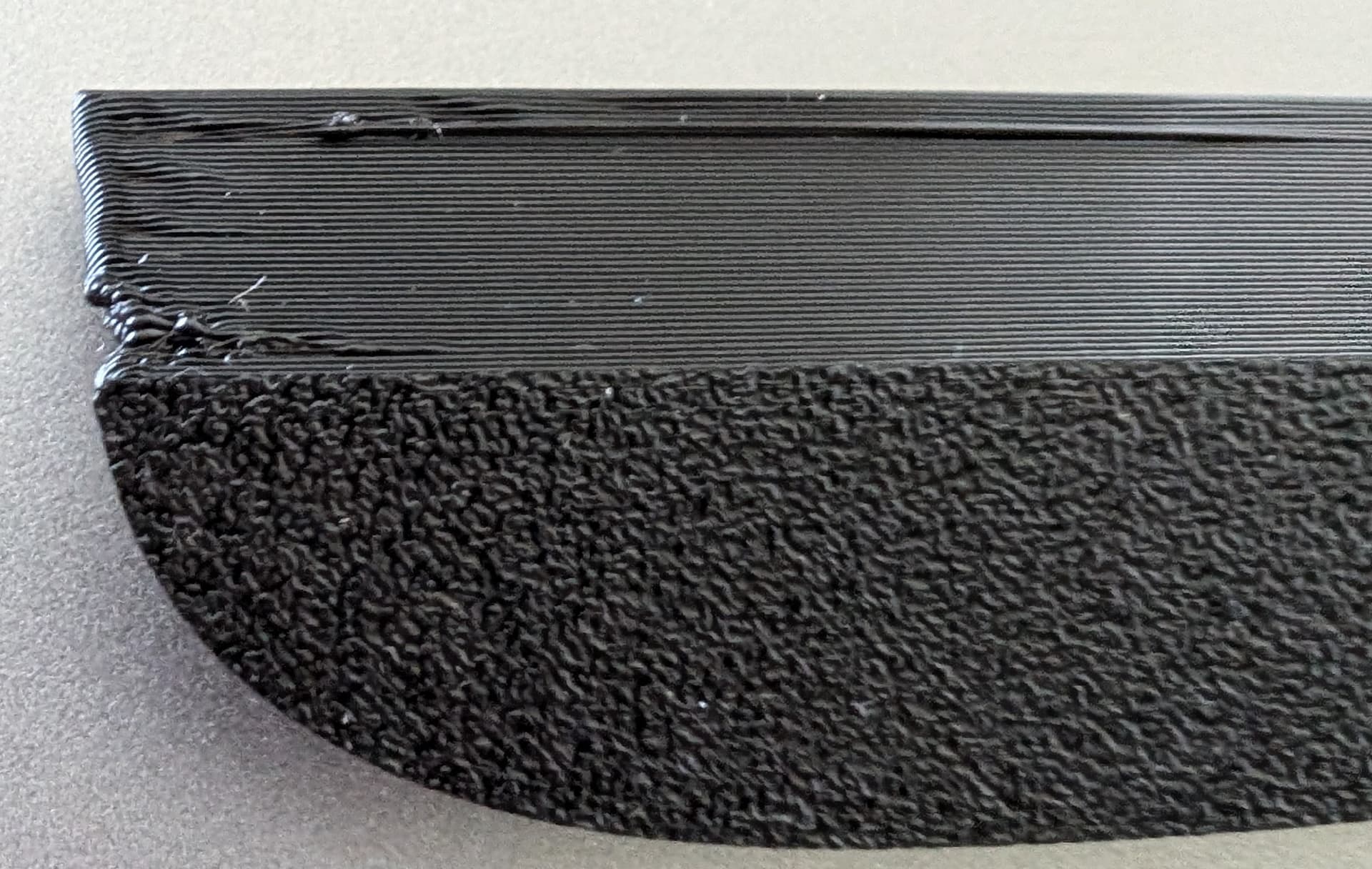

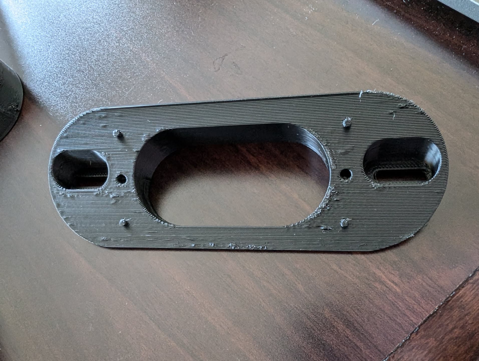

I was excited for this new firmware to try out, which does seem pretty cool, but I might be throwing this printer in the trash if I can’t ever get it to print right again. All of a sudden one day it started printing terribly. These are a couple examples that no matter what I do recalibration wise even where things got way off and I fixed them, still prints like garbage.
@nVIceman24
The printing problems here must have a cause other than the firmware. The firmware on the main board was always Klipper straight from the factory, and remains Klipper on both the Klipper Mod and Forge-X. My point here is that if the cause is not the firmware, the fix has to be unrelated to firmware.
The Klipper Mod was really only about offering additional user interface options.
The Forge-X mod does offer a new, more bug free version of Klipper, side-loaded beside the original. But it’s still Klipper firmware.
In analyzing the possible causes of the print issues… there can be problems with cooling fan being off when needed, or on when not needed, temp of bed being wrong (for a given filament), temp of nozzle being wrong, ambient temp in enclosure too low or two high, loose grub screws on belts, over-extrusion, under-extrusion, partial clog, etc, etc.
In this image:
…It looks like the lower part of the image is the underside of the first layer, having a pattern like it was against the bed. Then it looks like the top of the photo is a steep overhang with long bridging, and that’s always a challenge for any printer. I cannot be sure though, because it only gives me a limited glimpse into what was being attempted.
In this photo,
…I don’t have enough information from just one pic, to be able to know for sure, but it looks like it could possibly have been attempts at printing unsupported overhangs, which is problematic for virtually any normal 3D printer.
Can you share the models you were trying to print here, so we can get a better idea?

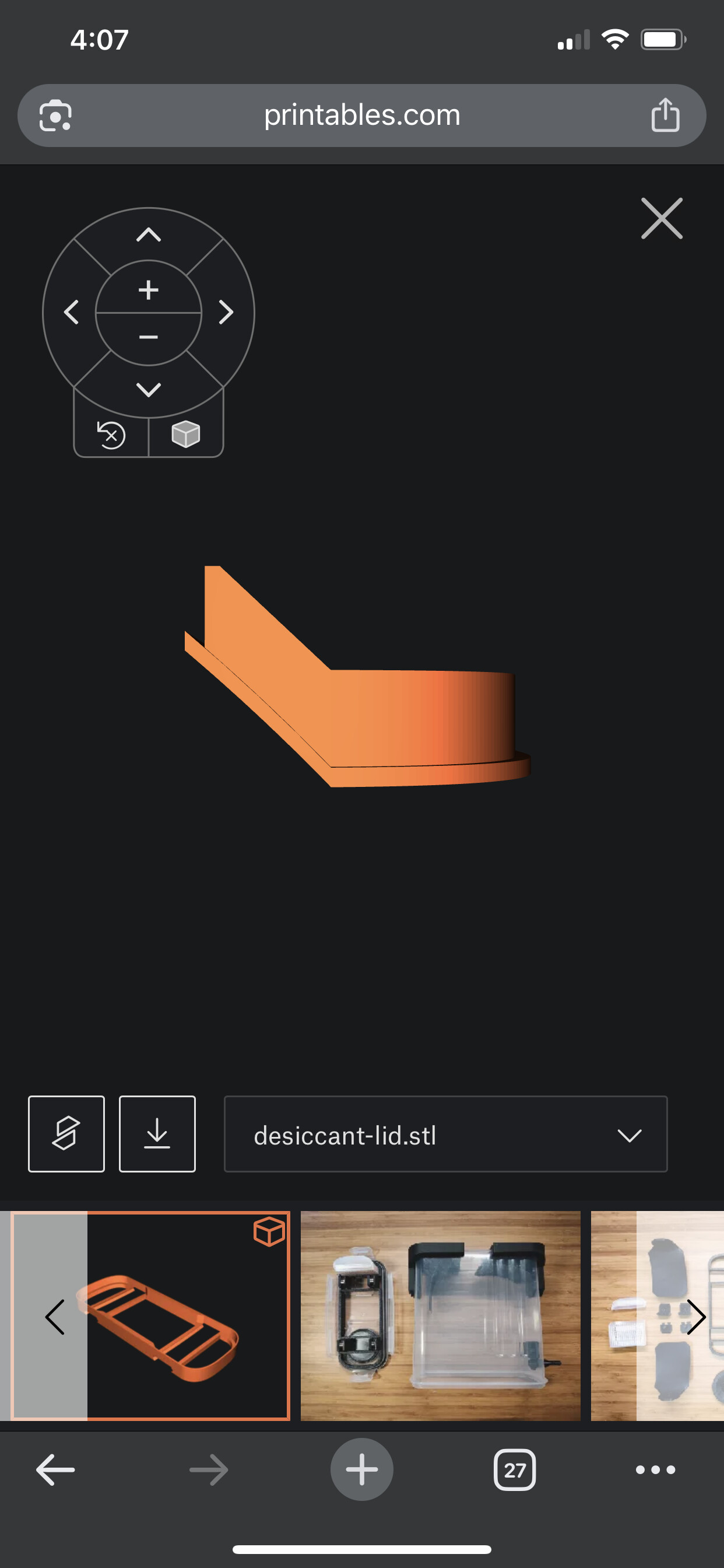

First photo model is this. Printables model #1305684, desiccant lid.

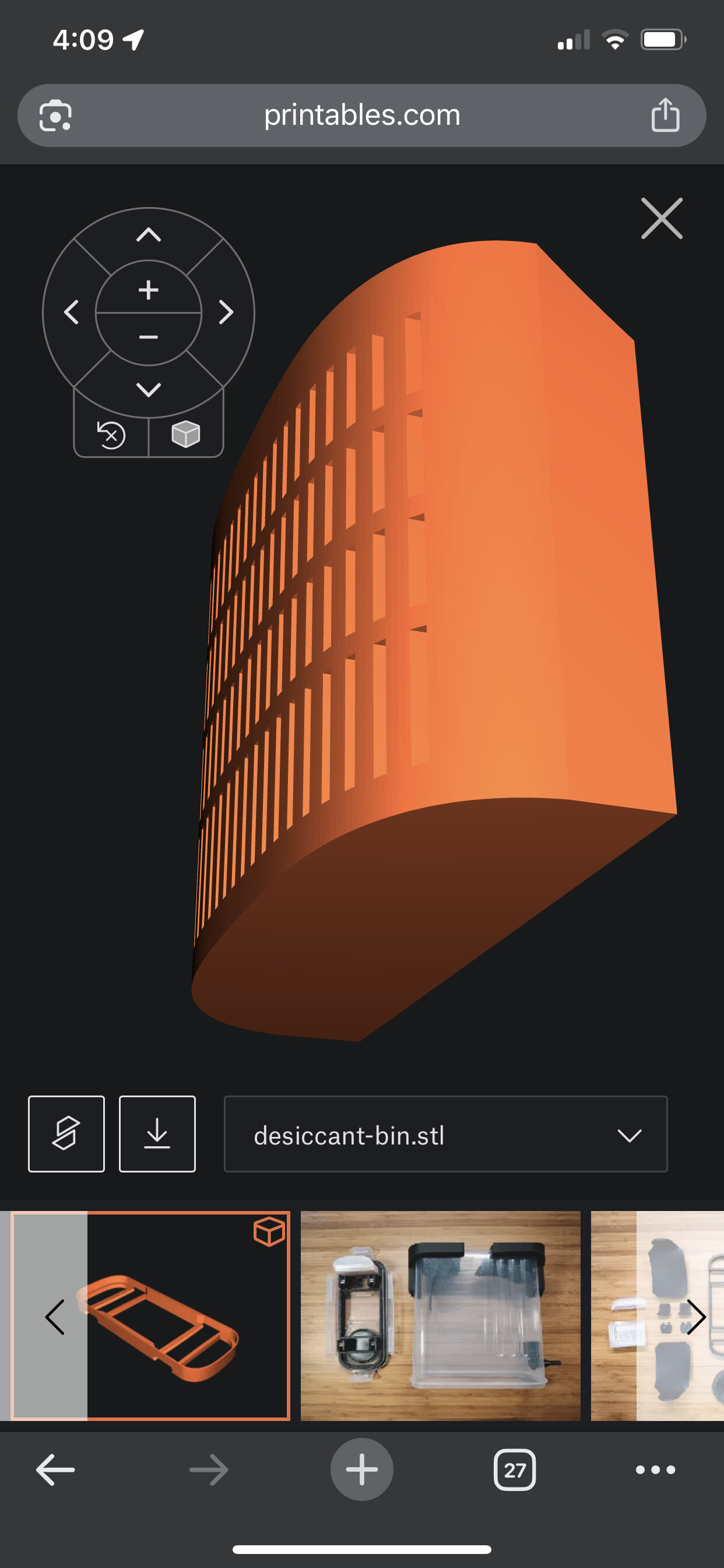

Second is the desiccant bin. I can’t include links in this post for some reason.
In first, I’ve had similar prints go way better and the quality of this has varied through the many times I test printed it.

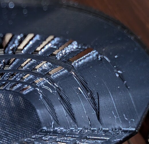

In second, that is inside and I do not know why it has overhangs sticking out like that. That should’ve just been part of the wall.
OK, I looked it up.
That first part definitely has an extensive 45° angle overhang,
…which means you need to have good extrusion (not a partial clog, but good flow), and you need to have a good cooling — part cooling fan needs to be running full blast, — and you need to not have a high ambient temperature, so if you have an enclosure definitely have the lid off and perhaps the front door open and if you’re in a hot environment, it’s going to be a challenge to print a steep slope overhang like that.

Your photo of the inside of this part, really looks to me like you have under extrusion/low flow/possibly a partial clog.
Filament can have impurities in it, including tiny bits of metal, tiny bits of rock, bits of sand, etc.
If you have another nozzle and you swap nozzles and it fixes things, then it was definitely a partial clog.
There are ways to help get rid of a partial clog such as a “cold pull” and alternatively heating the nozzle up real hot and pushing lots of filament through it to try to get a clog to move on through, but it can often be easier to get it back out the top through a cold pull rather than to get it to push all the way through the bottom. Think of the 3-D printer nozzle equivalent of trying to pass a kidney stone.

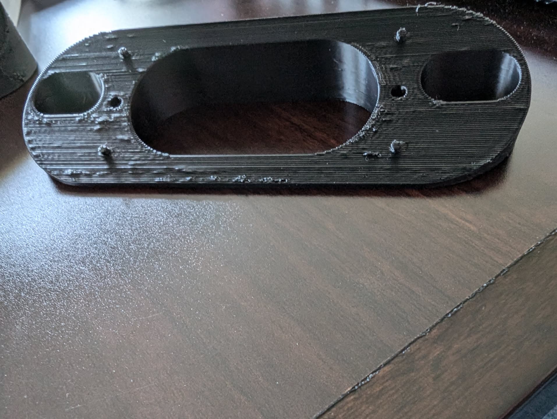

Here is another pic of something I test printed partially almost 20 times. Printables, model #624146. 25 degree version. As it slopes up, the infill it looked like would not lay down right and sometimes from the side I could see bits of it spiked up, it was worse the closer the Z-Offset, but I wouldn’t blame that as I had to raise way too high to get it to not be as bad, so then when the straight layers that would make up what is the top as it sits on bed, front of mount, they would be bumpy as the infill wasn’t laid down well, sometimes I even saw it not adhering well to previous layers when watching from the side.
This should probably go to a topic specific to your printer.
Try doing that print in an entirely different filament.
When you open that topic, tell us What slicer, with what profiles, what firmware and which filament you’re using.
