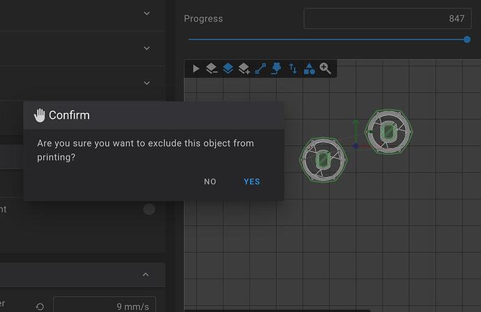

UPDATE re. the above post: I just found out from Alexander (the Forge-X mod’s developer) that in Fluidd there is a separate GUI approach to excluding objects from the print job: “In Fluidd, you can exclude parts from the print by double-clicking them in the G-Code preview” — very good to know! Learn something new all the time.
Also, this feature (exclude objects from a print job) is not specific to the Forge-X firmware mod. I was simply testing for whether this known good feature was indeed still functional within the mod’s included Fluidd and Mainsail instances.

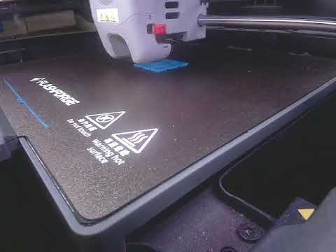

Re. Forge-X Time Lapse via Telegram Bot —hosted on a “server” on my laptop that is running inside a Linux virtual machine (VM)
While I am not an expert in either Linux or networking or Telegram… today I succeeded in getting a Telegram Bot created, and in getting a Linux virtual machine created (on my Mac laptop), and in getting the Telegram Bot server software installed to it, and… I just got my first successful time lapse video from a test print! I will probably try to make a video on it. At first I attempted the “Automatic Setup” shown in the docs, but it failed, and the mod author, Alex, said he will work to fix it later, but for now he suggested I do the “Manual Setup” instead, which I did. Dudes, and dude-ettes, I just got a test print time lapse! SO COOL!
