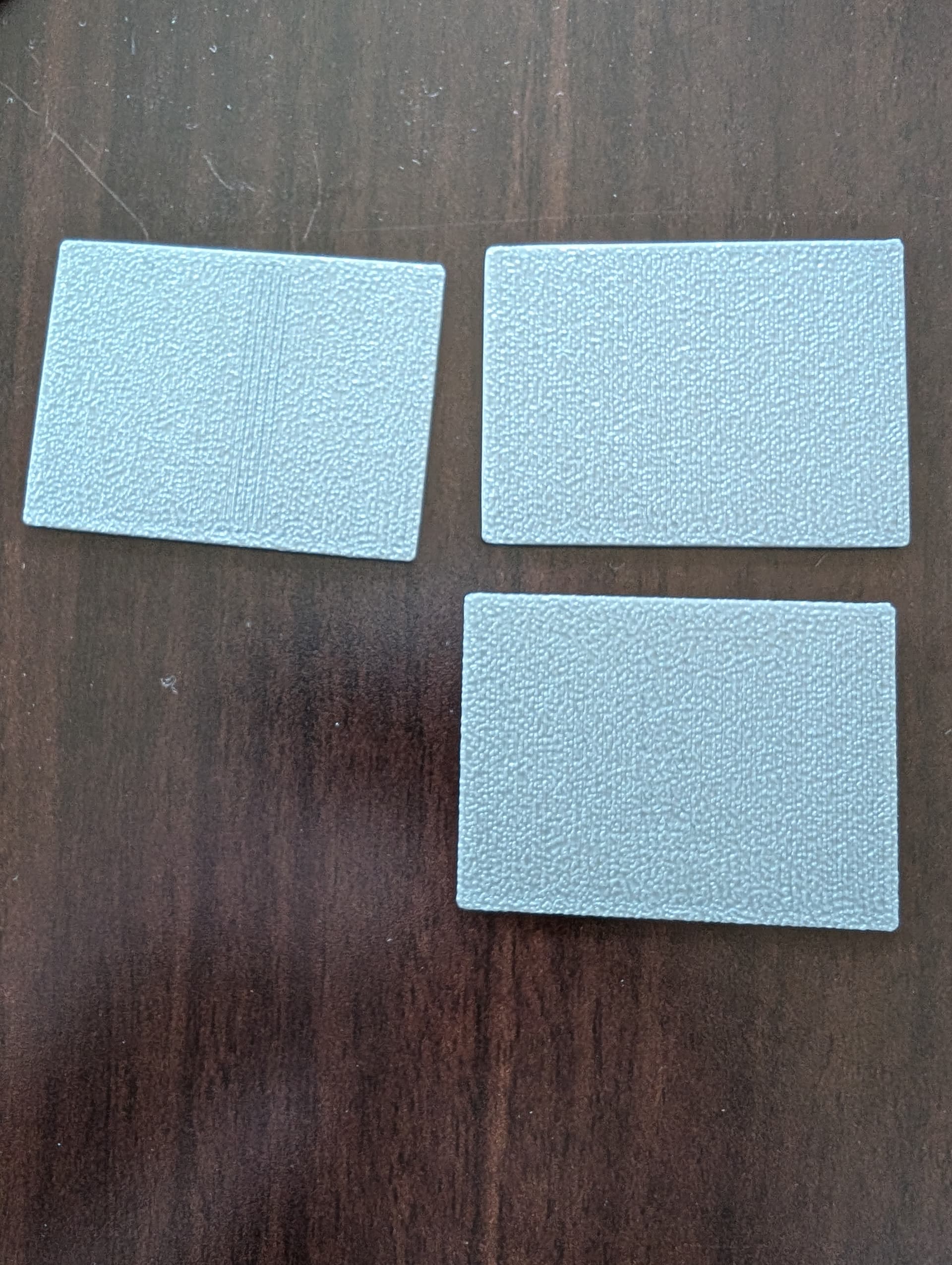

With the stock textured build plate, any of you manage to have no visible lines on the bottom of prints, just the texture? I did for awhile after fixing my z-offset, but i had one corner with a different z-offset after it overcompensated during bed meshes, I might have fixed the inconsistency by adjusting the 3 rods on the bottom, but I have been unable to return to my former glory of no lines. I’m close, but not quite there.
i have just the texture.
You need to balance it. Too much squish and you get elephants foot. Too little and you get these lines or worse.
I had it balanced, but cannot get there anymore, even with tiny adjustments all throughout the range.
If I squish it anymore than this, the top of the first layer looks very rough, it already is slightly rougher than what looks great with a little less squish, but even with some more squish, it more or less looks the same as this. It goes from this to nasty if I squish anymore.
Other factors include what filament type, and even brand, and what temp is being use on the nozzle.
I’m using Elegoo Rapid PETG at 230. I calibrated it. It was fine, nothing changed besides leveling the bed better, so I should’ve been able to find the happy place again.
But, I printed a larger item today and it was all texture, so not sure why smaller things were not quite right, but bigger thing was, as all sizes of things were fine before.

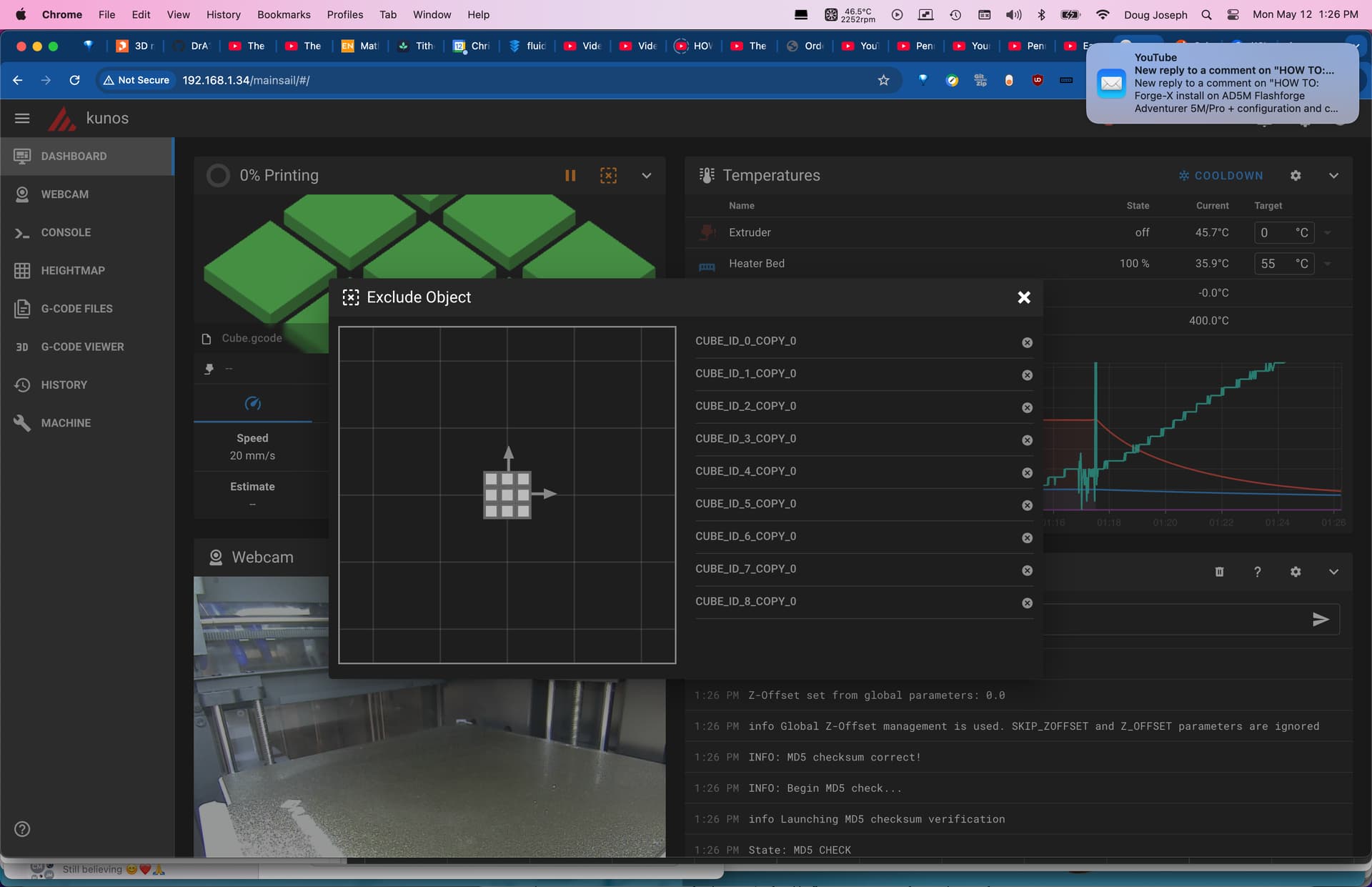

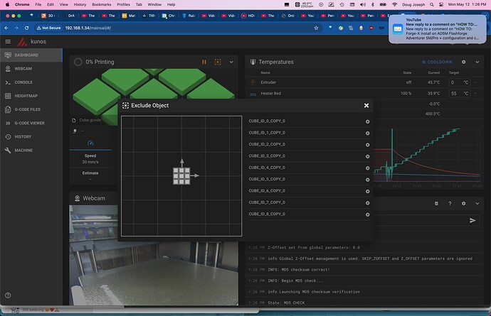

“Exclude Objects” feature tested, works, w/ Forge-X firmware, Mainsail’s was better than Fluidd’s!
I’m running the Forge-X firmware mod (as shown in my recent video) and I just now enabled “Exclude Objects” and tested for the very first time in both Fluidd and Mainsail, and while it technically works in both, the Mainsail version is far superior. The Fluidd version lacks a visual representation of the parts. The Mainsail version has that, and the parts in the visual representation are clickable for excluding. That’s a huge improvement in usability. I hope the Fluidd side gets that kind of feature soon.
Also as an interesting side note on that: on a test print of nine identical parts, I started the print in Fluidd, tested the exclude objects feature, paused the job, switched to Mainsail, and unpaused the job from there, and tested its Exclude Objects feature, all in the same print job, and that seems very cool to me.
