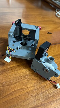

I want to thank you guys again for your help and suggestions for things to try. I increased the temp to 240C and purged the printer several times. I also did several cold pulls. My 0.3mm needles showed up yesterday afternoon and I used them on the nozzle. I started a print and part way through the filament quit feeding. I was hearing a clicking sound when it happened.
The FlashForge tech support had sent me a link to a video to take the extruder apart to check the feeder gears. I didn’t want to do it, but I ended up taking it apart to check the gears. Thankfully the gears weren’t damaged. I ran the cleaning rod back and forth several times through the feeder.

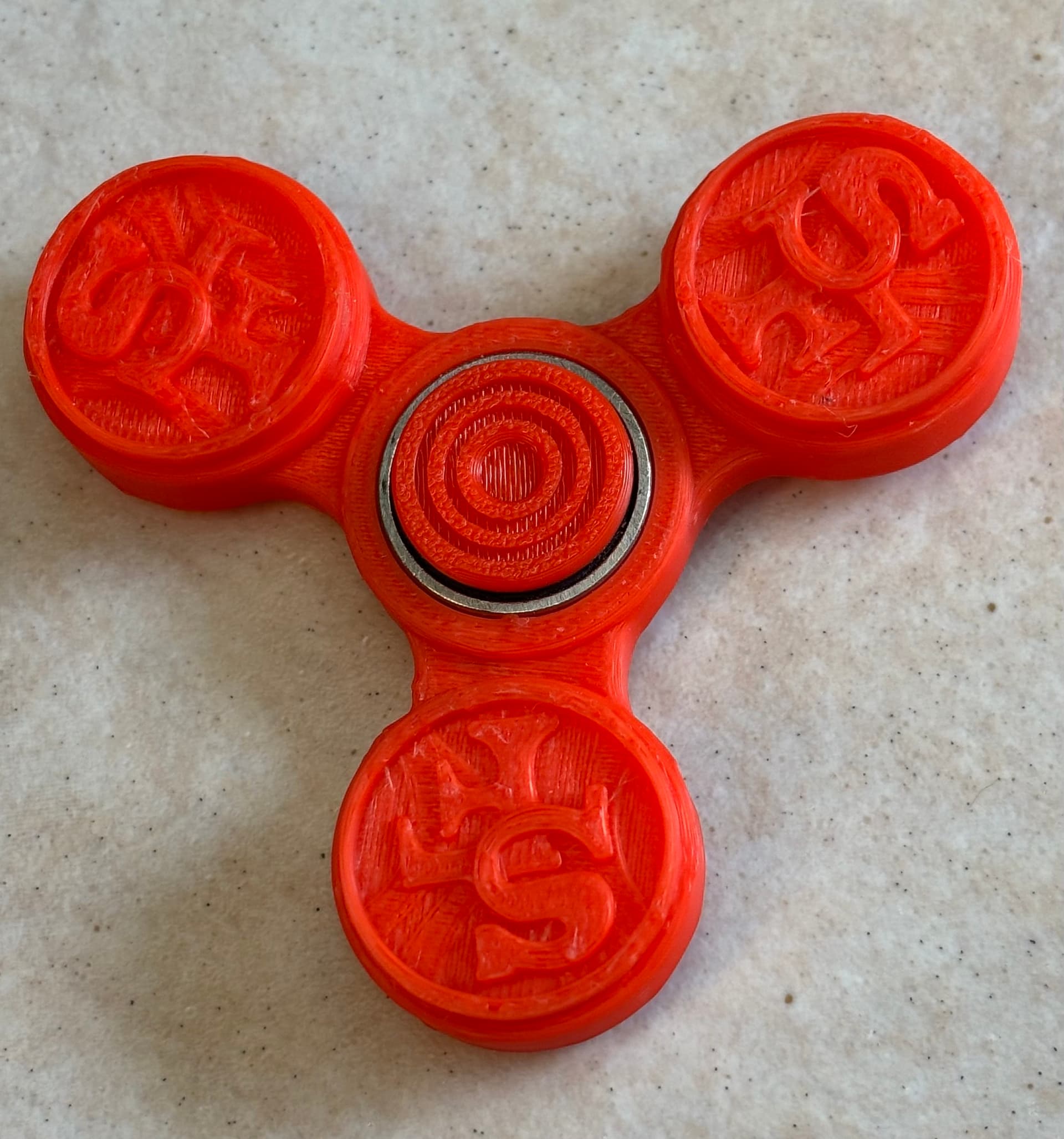

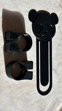

I reassembled the extruder and put it back on the printer. I printed the test cube and it came out great. So I printed a bookmark and 2 more stop blocks. Then I printed a fidget spinner for my grandson. They came out great also. Now I’m back to printing the replacement parts for my MPCNC.
So sorry you had an issue, but so glad you got it resolved! Great looking prints!
