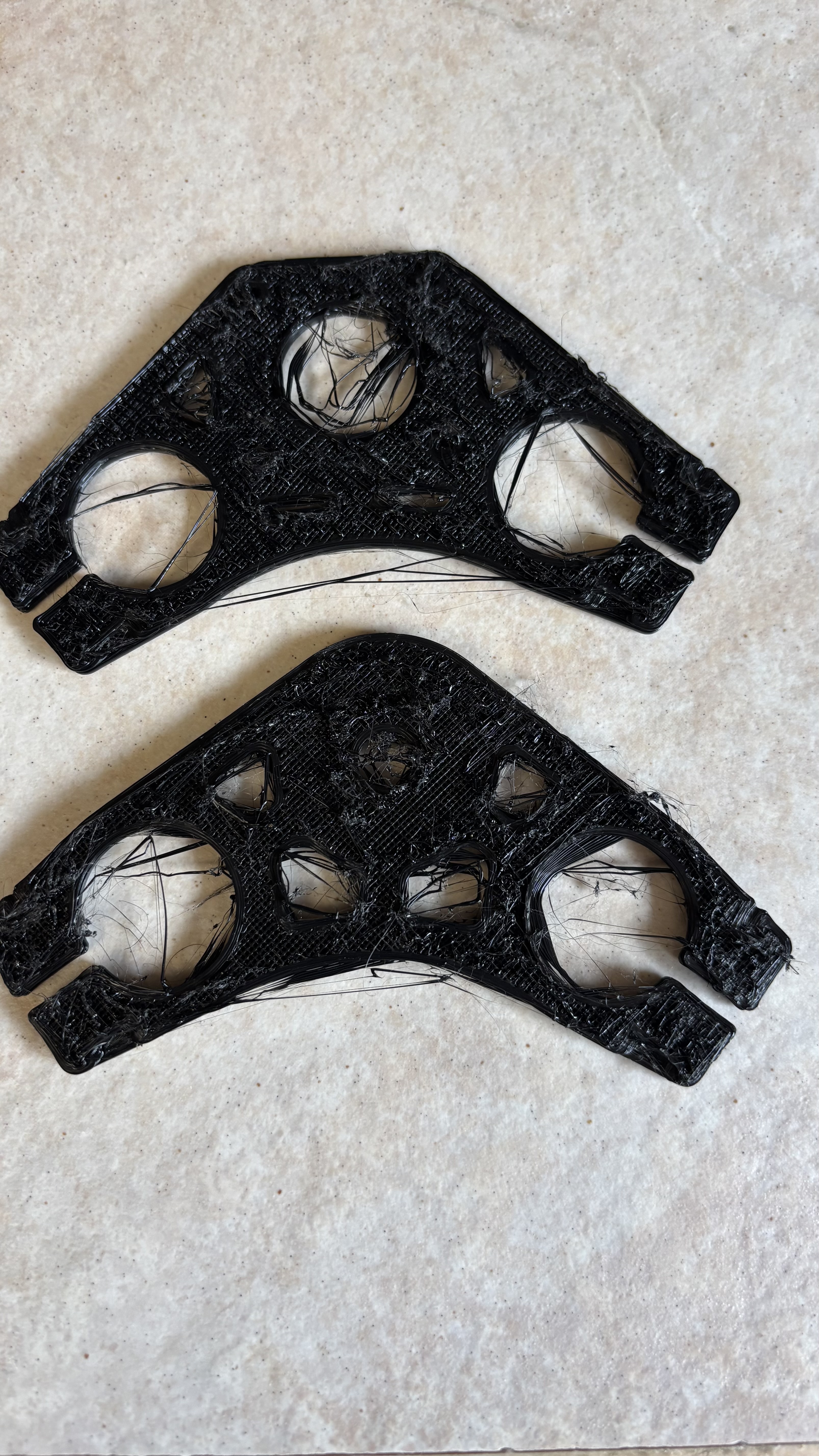

Mmmmmmmm not my case. My 0.6mm have printed 2 full lr4 sets with pet-cf (6 rolls of siraya tech petcf, had a lot of issues at the beginning with the profile, also thats when i modded one of my filament dryers and went with a Bowden tube out the dryer to the filament sensor, problems gone), random parts of petg (2 rolls) more than 5 rolls of pla. Pla has been kind of nightmare with some Chinese brands, the extruder clicking issue and jams. Don’t go over 220° with pla (it softens upwards and causes the jams) I settled with 220/215 for pla temps and the issue disappeared
So, you experienced the clicking also? I hope that means my filament feeder is ok. It started doing it again. I will check to make sure my PLA temp is 220°.
Usually a clicking sound coming from the extruder means that either the temperature is too low, or the spool is tangled and bound up, or there is a clog in the nozzle. The clicking sound itself is made when the stepper motor’s “sections” jump from one magnetic attachment over to the next set of magnets in the circle. It doesn’t necessarily mean there’s anything broken or wrong in your gears or your stepper motor, just simply that it was being commanded to extrude filament, and it couldn’t actually get the job done fully. Usually once the tangle is untangled, or the clog is unclogged, or the temperature is corrected, there is no lasting harm.
As another note on the clicking issue, sometimes during inability to extrude, then the gear teeth will actually dig a groove in the stationary filament, and then the clicking sound goes away, but no filament is coming out, and it’s because the gears no longer have anything to grab onto.
Less is better, also if your sound is coming from the extruser, there may be some rest of filament in there. Not all brands are the same. My issues appears with sunlu branded and other Chinese filaments.

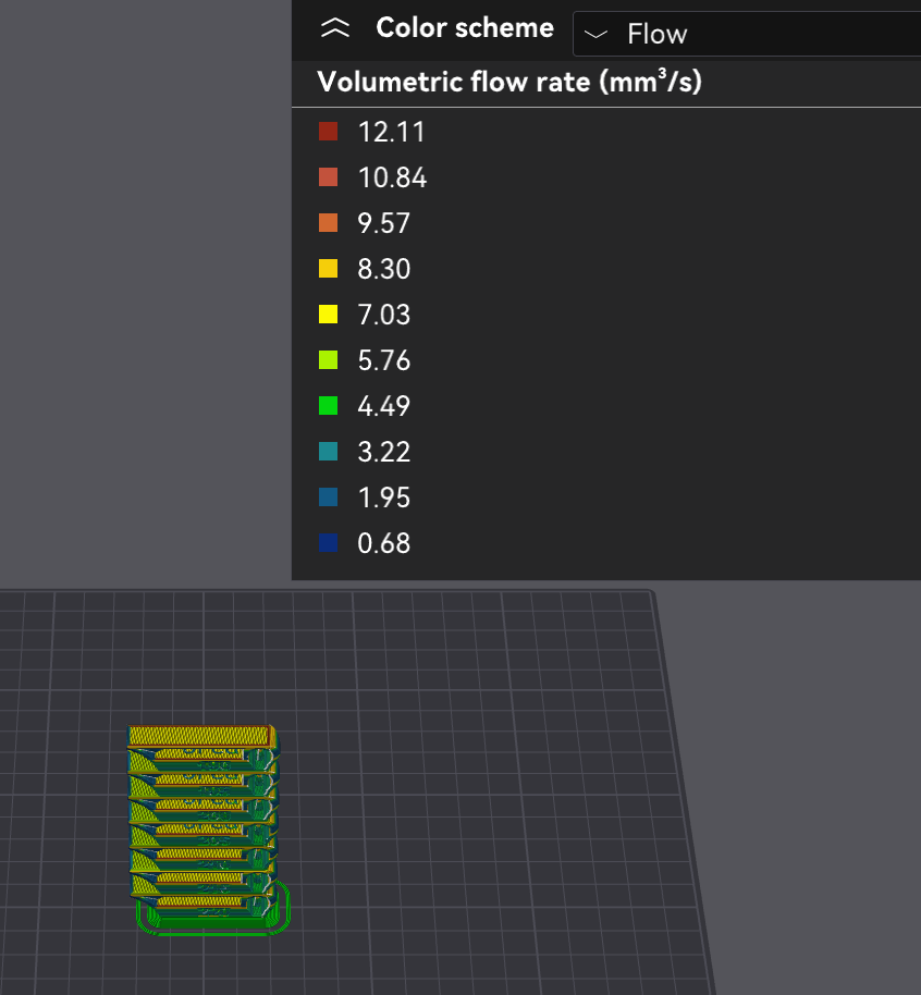

In Orca, after slicing, you can select “Flow” and the colors will represent the flow rate. You can set the upper limit in the filament settings “Maximum volumetric speed”
Thank you Tuco. I appreciate you taking the time to tell me where to look.
Mine is set at 25 cubic mm/sec
Thanks for this tip also Cesar. I switched filament spools and I haven’t had anymore problems. The 2 for the price of 1 was the problem. Both are FlashForge filament. The cheaper one is on a particle board spool.
