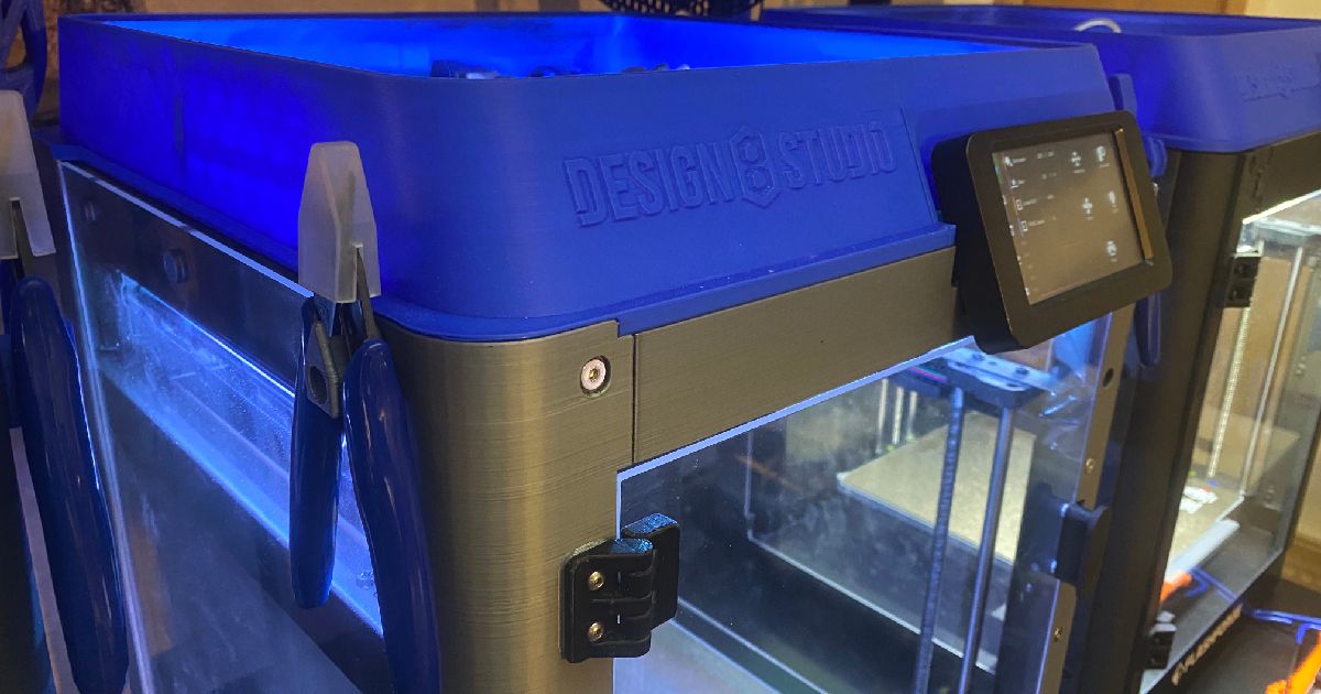

Retrofit the Minimal Enclosure onto the OG DIY Enclosure parts - get your touch screen back on metal frame. Save and reuse some parts.

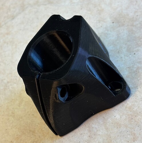

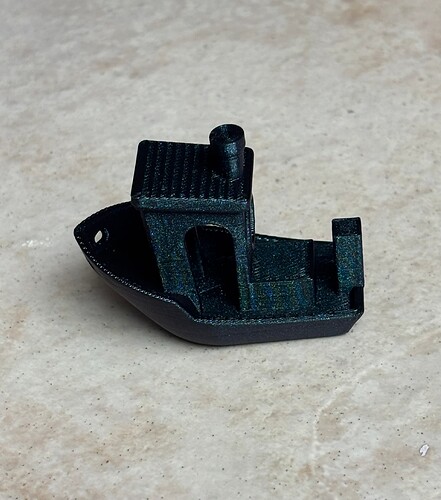

Woohoo, my FlashForge AD5M arrived today. Thanks again @DougJoseph !
I used the 3D printer at the school I taught at until retiring. I haven’t had access to one until now. Wow is it nice. It prints way faster and better than the Makerbot we had at school and costs 1/6 the price. I’m very impressed so far.
Here is my first print:
I’m still amazed by the speed

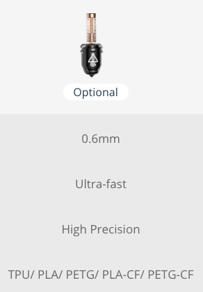

I am interested in printing PLA-CF, PETG and TPU, so I looked at the specs on the FlashForge website. They say to use the 0.6mm nozzle.
Yes, my understanding is that both the 0.6 and the 0.8 nozzles are hardened and for use with the more exotic filaments that contain abrasive elements, so anything with carbon fiber in it (and there are other abrasive filaments I think, maybe GF).
The 0.6mm nozzle worked for my prints of Pet-cf, it still alive.

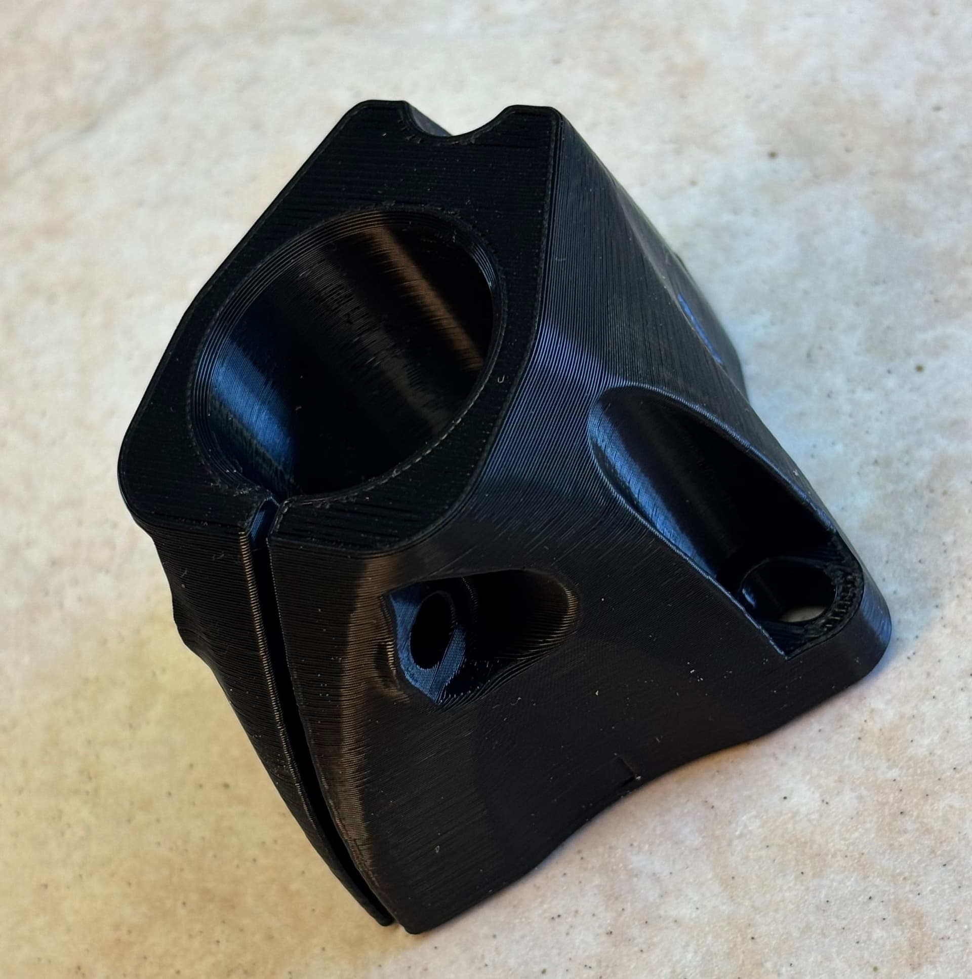

Well, my excitement was short lived.

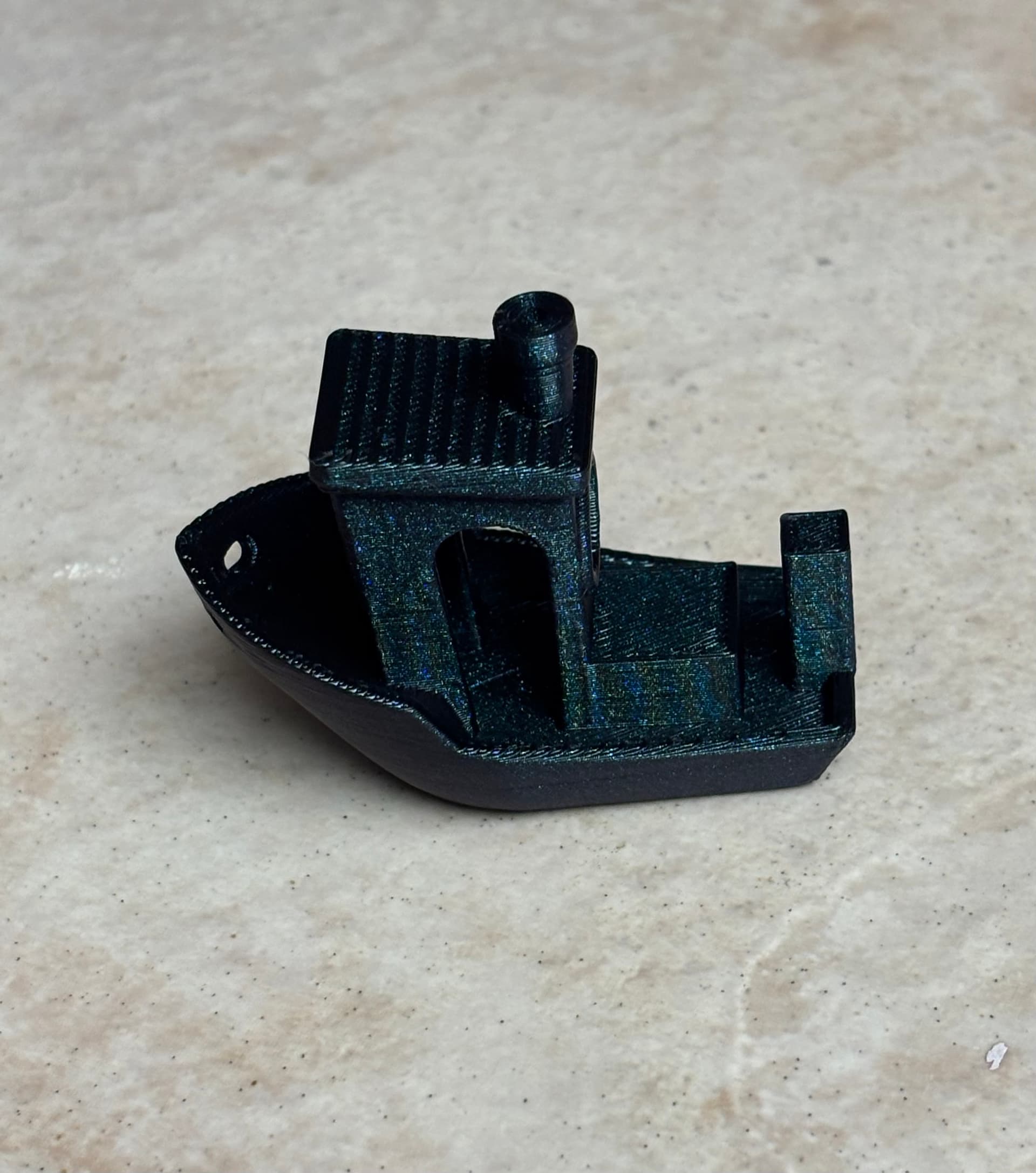

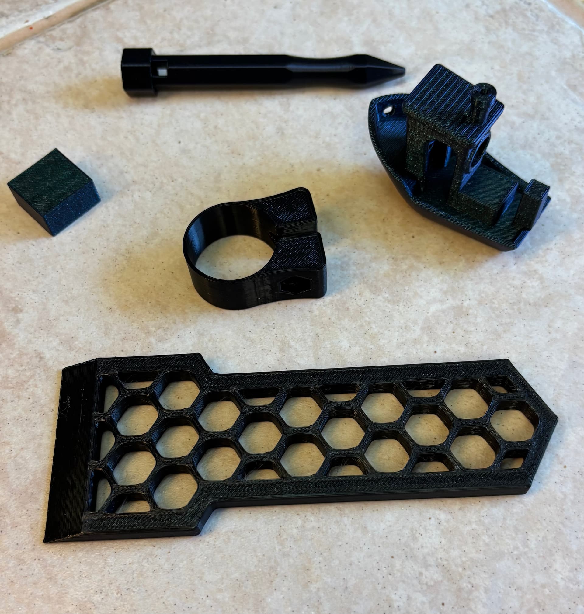

I received my new Adventurer 5M from Amazon last Friday. I printed out the test cube and boat first. They turned out great. Then I printed out some other items and they printed out great also.

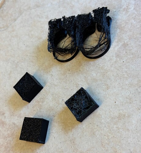

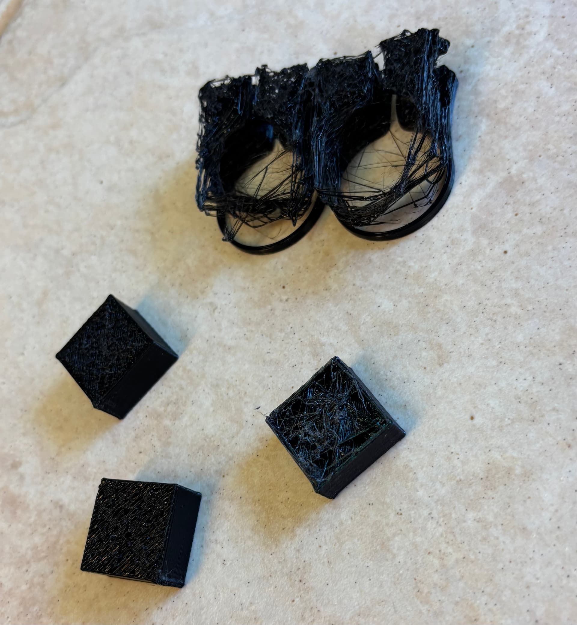

Then on Saturday I tried printing out some parts and part way through the print the filament stopped adhering and became very stringy. I reloaded the filament several times trying to clear out the nozzle. That didn’t work. I watched their video on clearing a clogged nozzle and tried that. That didn’t work either. Now everything I print comes out terrible.
I thought maybe overnight my filament had absorbed too much moisture so I opened a new roll of filament. It did the same thing.

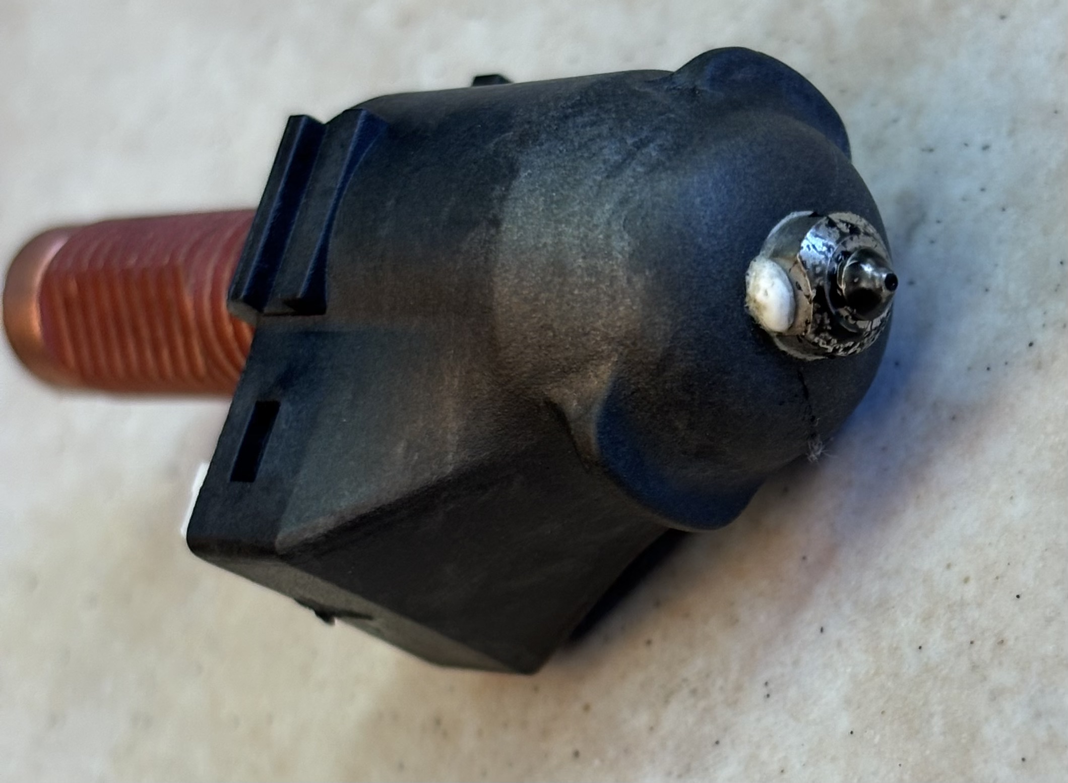

I took out the nozzle and cleaned it as best I could, but that didn’t work either.
This is what it looked like before I cleaned it.
I don’t know what to do next.
Hard to say from here, but my guess would be partial clog. So sorry.

That looks to me like a partial clog. That would be an internal clog, no amount of external cleaning will help it.
What brand of filament are you using, with what filament settings on the printer? How fast are you running material through the printer?
