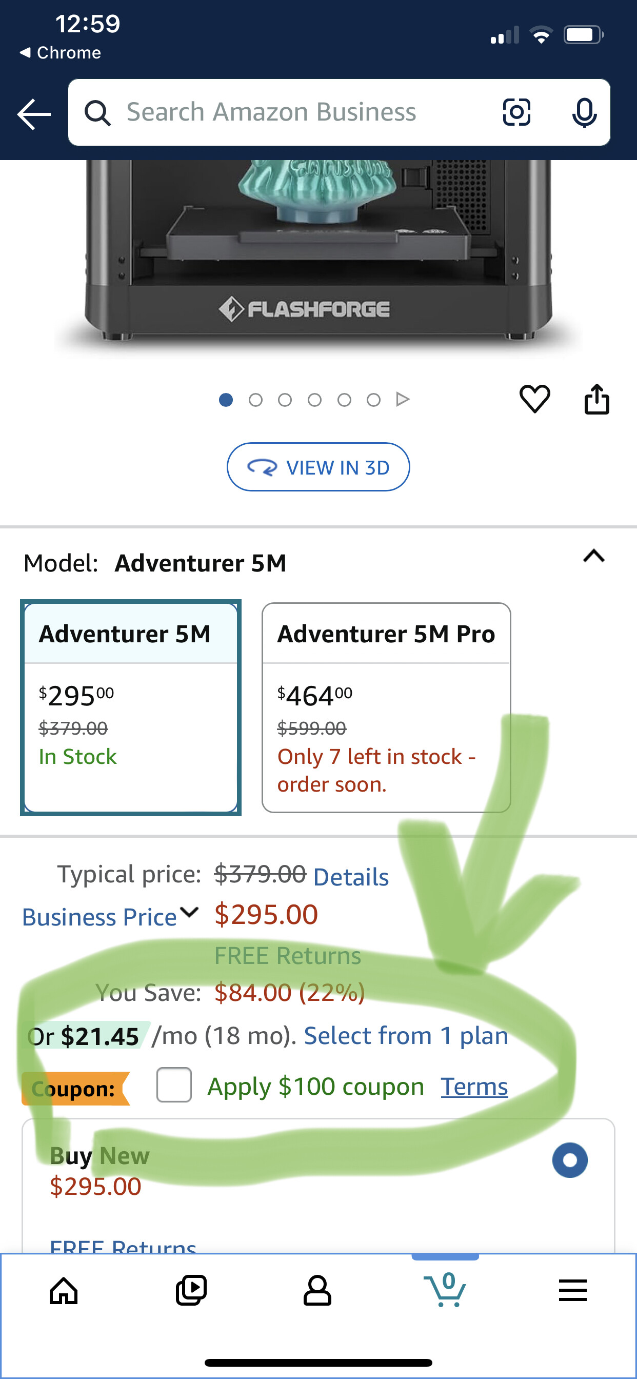

Because I have a business account on Amazon, as of a day or two ago I had a lower price on the AD5M than people without a business account had access to, and yet I also had access to the $100 off coupon that everyone else had access to. Bottom line was that for me it was 295 before the coupon and 195 after the coupon. If you want to get that one using my price, I could maybe arrange for you to pay for me ordering it for you - drop-ship style.
@DougJoseph
Where can I find the $100 coupon?
@Britt
This affiliate link leads to listing that has $100 coupon. The screenshot shows the special price my business account has. Also shows the coupon box - highlighted.
https://amzn.to/3Dttjrr
Amazing deal, thats even better they had on Black Friday
I appreciate that, but the link you posted after was all I needed to secure that deal. Thanks!
