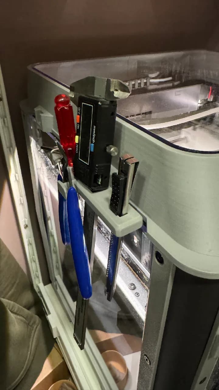

For Doug, some questions:
The M4 screw in the corner- what screw length did you use? It wasn’t one from the kit, right? This should be in your instructions. I found a random M4 and spaced it with some washers. I’ll find the right length tomorrow when I dig out my metric screw kit.
More questions:
That spool holder’s nub for the PTFE tube can’t possibly be in the right spot. Note the angle in the picture above.
I ended up just leaving the PTFE tube free floating on this side and I don’t think I’m going to change it from that.
On my newest listing of the side mounted spool holder (v2.1), I have this in the description:
BOM
  • Three (3) M3 nuts - one of these is in addition to the DIY enclosure kit.
  • One (1) machine screw, M3 x 8mm - new in addition to the DIY enclosure kit.
  • One (1) machine screw, M4 x 10 mm - new in addition to the DIY enclosure kit.
  • Four (4) machine screws, either M3 x 5mm or M3 x 6mm. These would have either already been on hand from your existing machine and/or already were called for in your DIY enclosure kit or its BOM.
  • You will also need the other screws from the DIY enclosure kit / or from your existing machine, for attaching the Filament Runout Sensor to the printed mount (I think those are two (2) M3 x 20mm), and for attaching the Drag Chain Fixing Clip to the mount (I think those are two (2) M3 x 25mm). If I have the length wrong on either, please let me know in comments. The stock screws that previously attached the Filament Runout Sensor to the metal frame, can be reused.
So, M4 x 10 mm.
And under INSTALLATION STEPS I have this:
  • To attach the side mounted spool holder,
    • First remove the top screw holding the printed guard plate from the DIY enclosure, at the back right side of the printer. This is an M4 screw, but it is too short to be reused. It will be replaced by an M4 x 10 mm.
    • Hold the spool holder in place, and tighten the above mentioned M4 x 10 mm screw.
    • At the back of the spool holder, shine a light into the M3 screw hole to make sure it is aligned with the screw hole on the printed mount, which has a captured M3 nut. The back of the guard plate itself is not attached in any way, and the torque from the screw on the side can cause the back to flex away from the frame slightly. You may need to exert a little force to press the guard plate and the spool holder, to get the screw holes in the spool holder and the printed mount to be aligned.
    • Insert and tighten the M3 x 8mm screw attaching the back of the spool holder to the back of the wingtip on the printed mount.
So, it mentions M4 x 10 mm in both places. Is there somewhere else I should also add it?

Thanks for the feedback. Although I have used it for a long time in the location you see, I was thinking today about possible ways to do something higher and pointed up like you showed. I have not come up with it yet.
If I model up a taller, better approach, I’d try to make it backward compatible with earlier prints. Probably doable.
