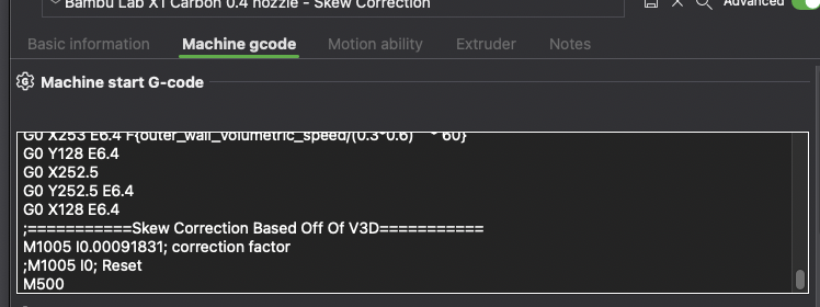

All you have to do then is in your start gcode add the
G-Code Correction String
it calculates, as
M1005 I###
M500
The benefit with the I command is that it is not cumulative in the eeprom. Every time you start a print it overwrites the old value. So even if you leave the command there, it will just overwrite it. I tested this and my 2 diagonals were within .01mm of each other on the first try.
So with all this rambling out of the way, here are the steps I did.
  • I printed the calibration square that Bambu originally provided scaled up 150% to make the calculation more accurate.
  • I used the values I measured with my calipers and inserted those in the google sheet to calculate my skew value (the google sheet has an image showing you were to measure on your square. The square that bambu provided has an arrow on one of the diagonals and that should point to the top right)
  • In bambu studio I went to my printer settings, and inserted my correction factor as shown below. I have the reset command commented out in case I ever need to have it. But otherwise this has been working great so far. Make sure to click save after you enter your g-code correction to save as a new profile.

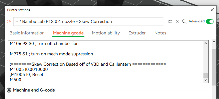

So I’ve tried using this code on 2 calilanterns now and it doesn’t seem to do anything for correcting the XY skew. I’ve gotten the same XY Skew twice in a row even with corrections.
Ok. I realize now that I put it in wrong and put an extra 0 when doing it the second time. “0.0001” is what I had when I think it should have been “0.001”. The first time I had “0.0007” and then it suggested I go up to the “0.001”.
I fixed it to “0.001” and am just reprinting the bottom part of the lantern.
Just be careful that you copied the value off the spreadsheet correctly. I goofed and missed a zero and my printhead was slamming to the back of the printer.
I can’t copy directly from the spreadsheet as the lantern one puts it in a percentage so I have to add two extra zeros and then put it into the gcode but thanks for the warning.
This is the spreadsheet I used for calibration (posted in the original post I did on my calibration method). The I value is in radians and if the value gets too big you will have the issue I had. I don’t want anyone else hearing the motor screeching I heard.

Alright. I’m convinced that XY calibration doesn’t do anything. Measured the same again after a third print with following settings.
Don’t get me wrong I don’t disagree with you. Of course try to get it as calibrated as possible. After I did my xy correction I got a score of 881. I think us bambu users will have to live with this reality. I believe there are many bambu users here that have not had issues, so I’m crossing my fingers.
Maybe the P1S doesn’t support the M1005 code. Marlin uses M852 and all bambu did for the X1C is wrap that in M1005. You could try M852 with the same I value and see if that does something.

I’ve read a couple forum posts and they more or less confirmed it doesn’t work on the P1 series. So there goes a whole day of printing on nothing. Only thing I managed to improve was dimensional accuracy by scaling my print to X =100.30% and Y=100.22%.
Did you add the scale directly into your gcode so it’s permanent, and did you get the scale value from the V3D sheet?
Yeah it is frustrating. They are trying to be the Apple of 3D printers, but in this case people are making things, and they should be allowed to adjust since depending on material etc, no 2 prints will be the same.
I read in one of the Bambu forums that they are working on skew adjustments. It would be nice if they released that now.
Yes as shown above and the first time I used a value straight from that spreadsheet.
I found my answer here. Direct from product support a couple weeks ago saying no skew correction on P1 Series printers.
https://www.reddit.com/r/BambuLab/comments/1ftpcd0/p1_printers_dont_support_skew_correction/
The interesting part is where it’s mentioned that a FW update is coming that will include skew correction. :crossed_fingers:
