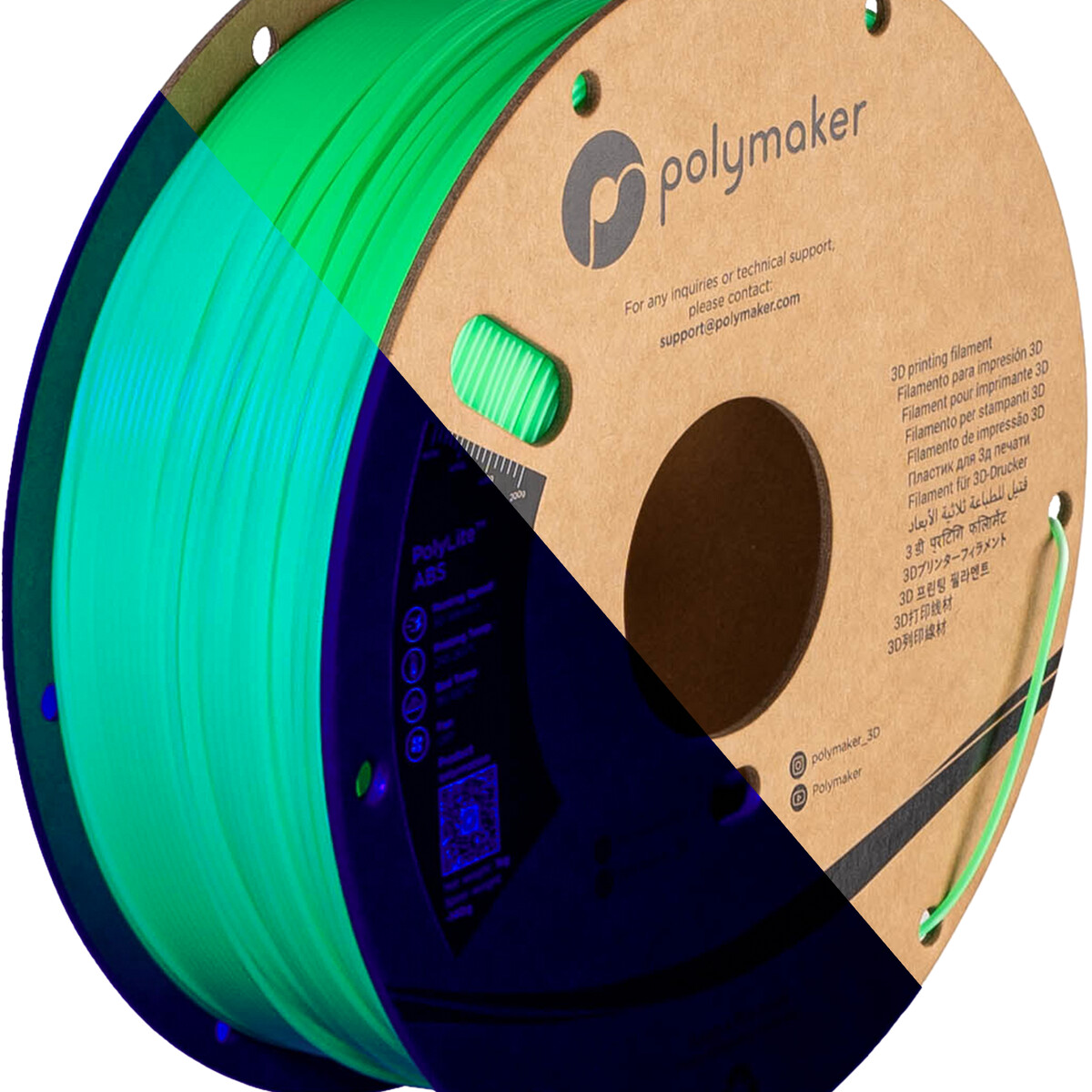

From my understanding they should be the same for ABS. But I have not tried to print ABS. Polymaker has some cool UV reactive ABS that I wouldn’t mind trying
