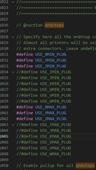

That doesn’t look right. Shouldn’t it have Z2?

I dunno actually, let me have another look at the end stop section of the firmware…
ok here we go.
looking at my protoface picture the names are different, your right there is no ZMAX, which I assume is z2, but its clearly enabled in the code. That is strange.

Did you change anything in the configuration_adv.h? That is where the dual Z is set.
As you already found, it is set in the config.ini.

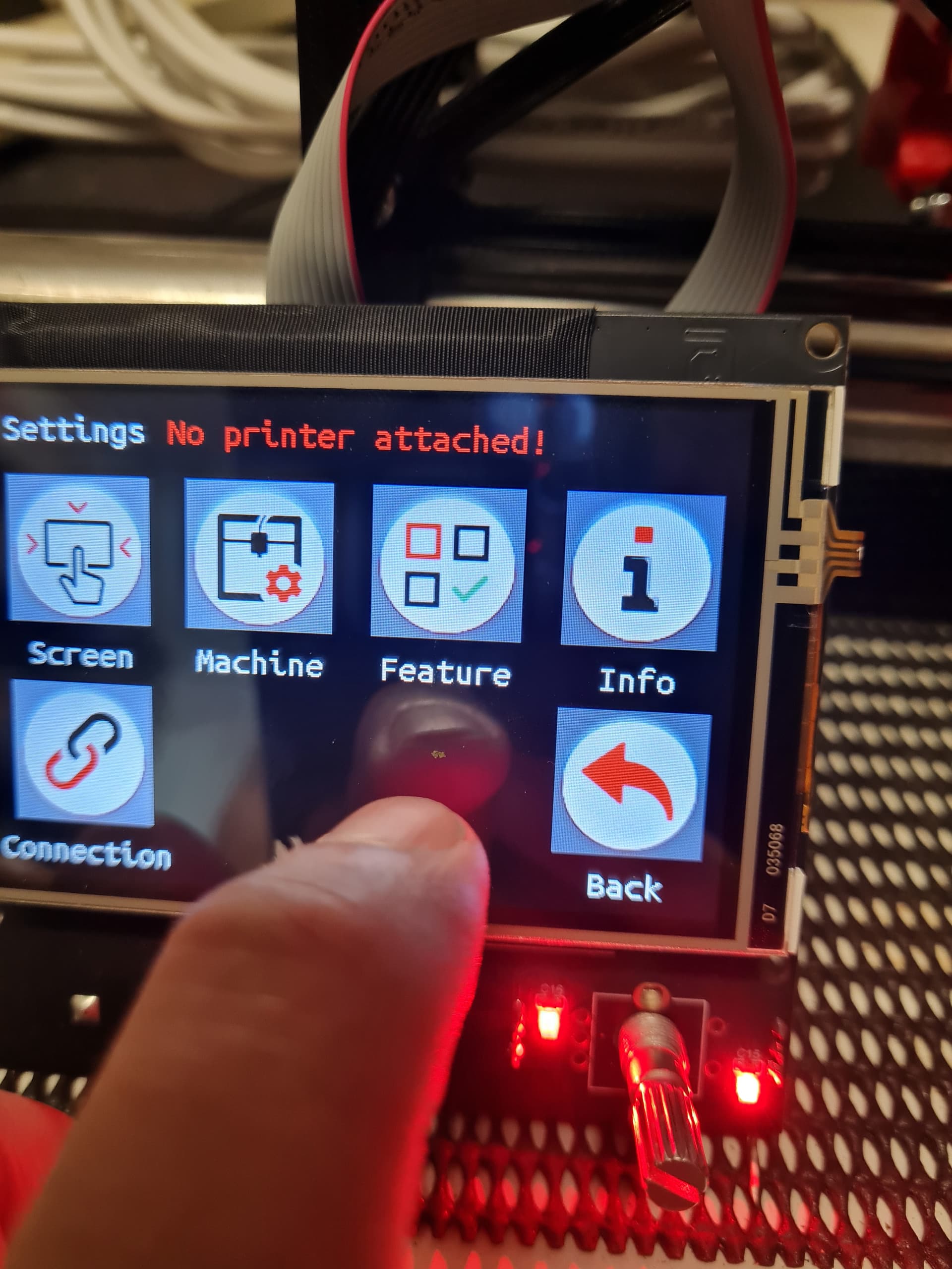

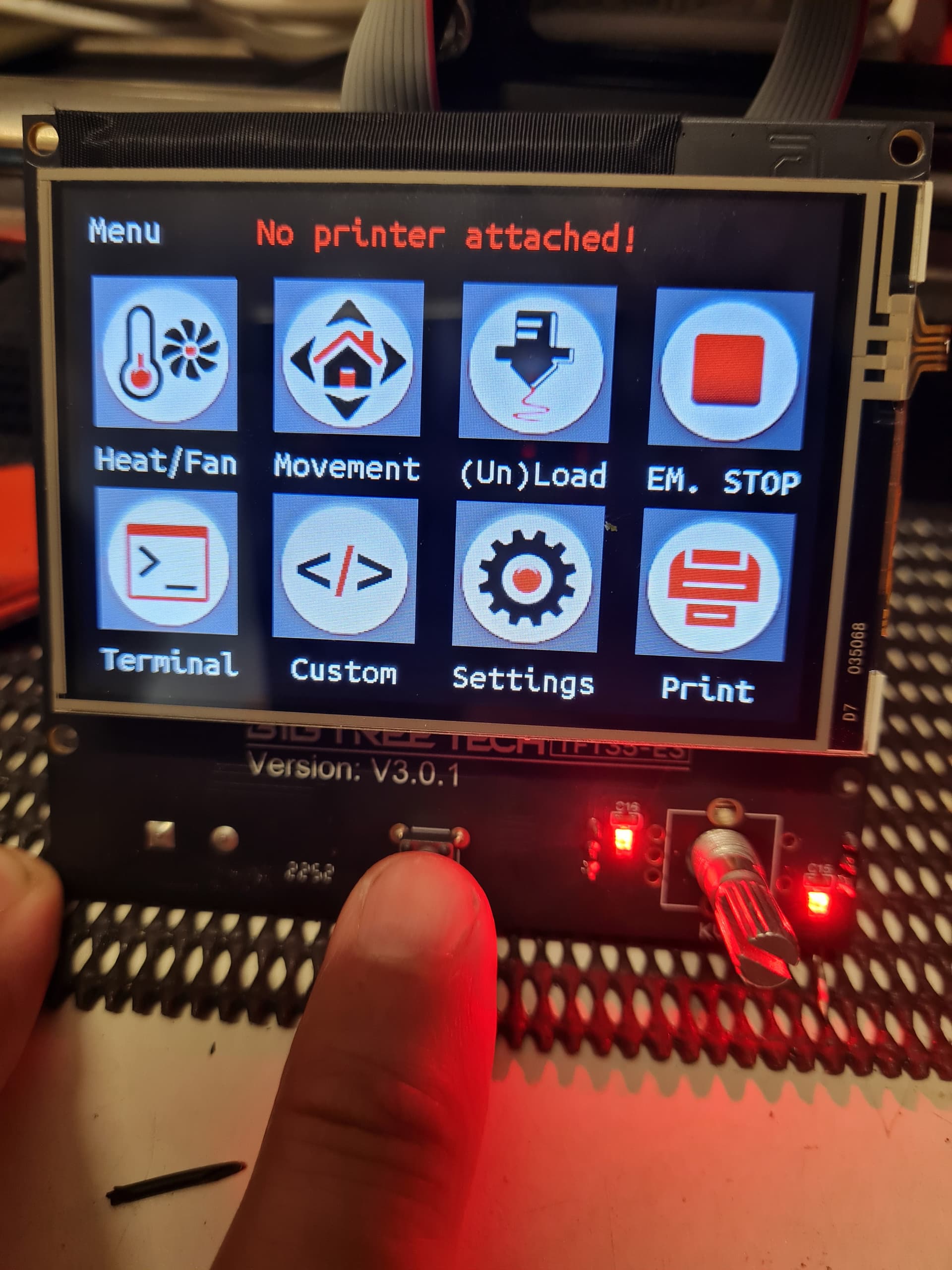

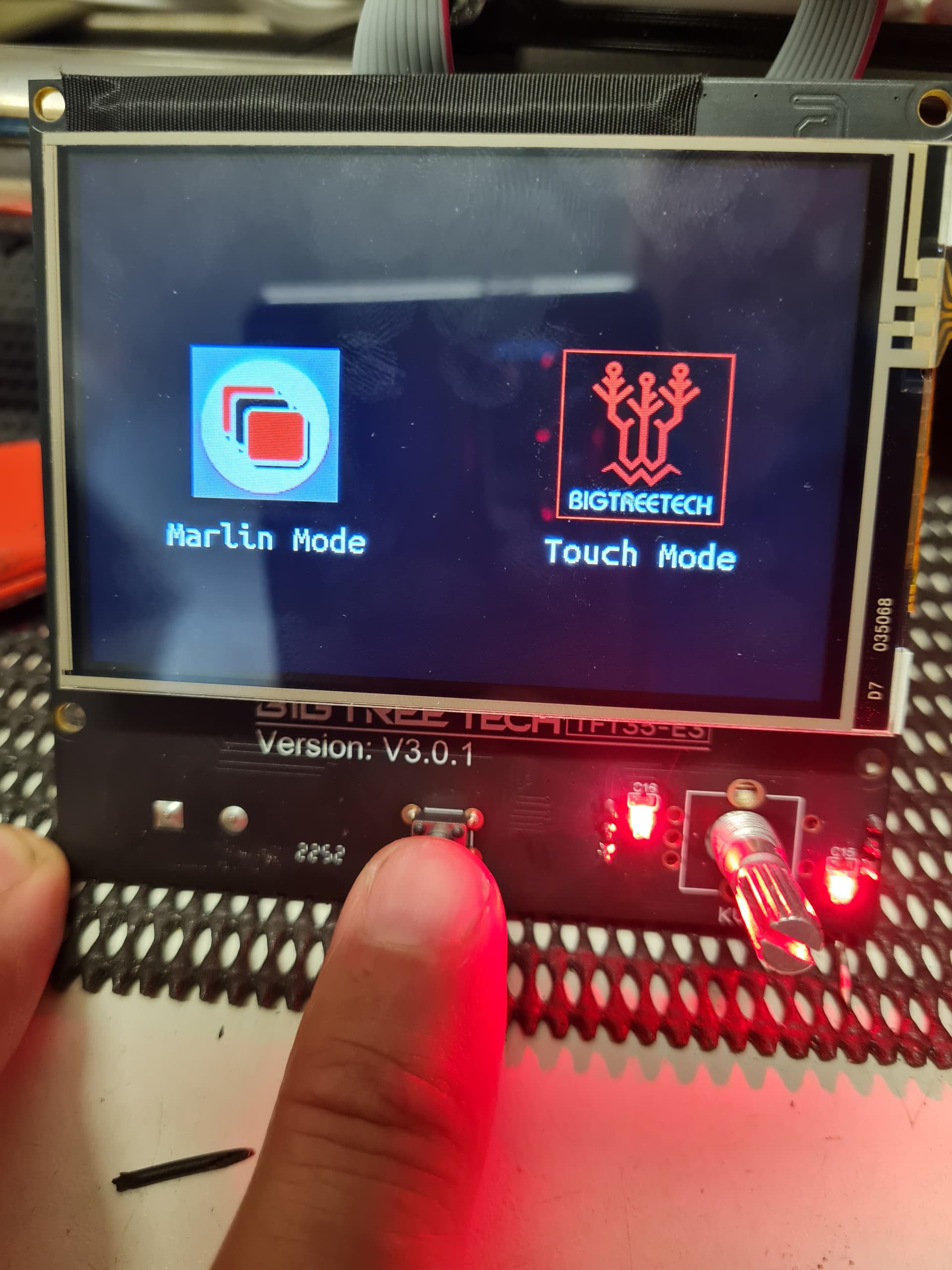

and about 10 sec later the TFT35 drops from the logo to the Grey button menu. I will add here that i am using the CNC version but it seems to be the printer version…
I can hit a button, like the settings button, and it will go into that
But then after about 10seconds TOTAL, not after a button press it drops to this screen,
the touch screen does not seem to be damaged, the film has been removed, all the buttons are pressable, and doesn’t seem to be highlighting one button like something is pressing on it , also the knob / dial is as i would expect that unit to feel, moderate pressure to engage the click. it doesnt feel “stuck” or damaged.
If you hold the knob down on a healthy screen, it goes to that mode switching screen.
The gray wires are convincing the screen that the knob is being pressed. Something is wrong with your gray 10 pin cables.

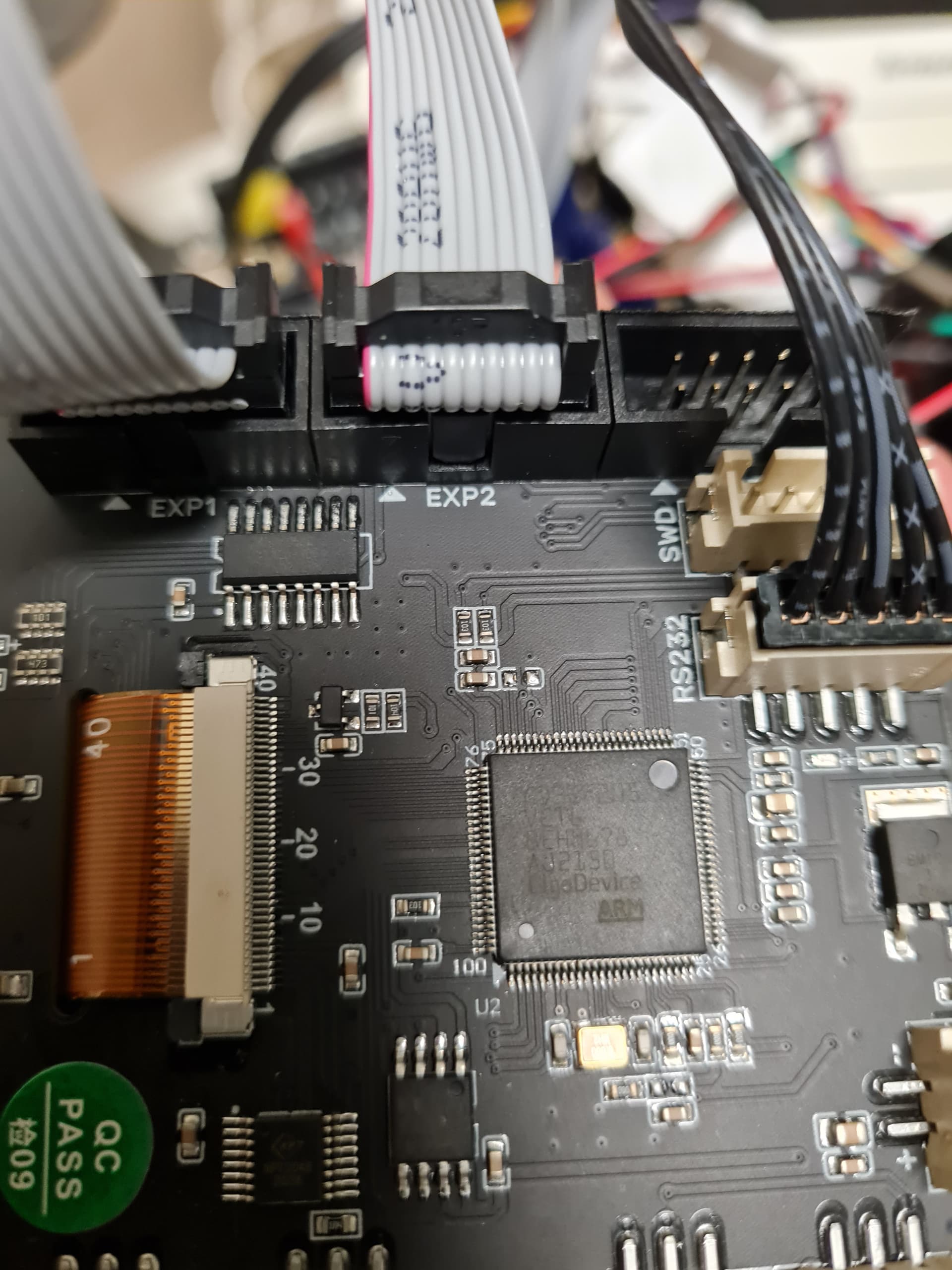

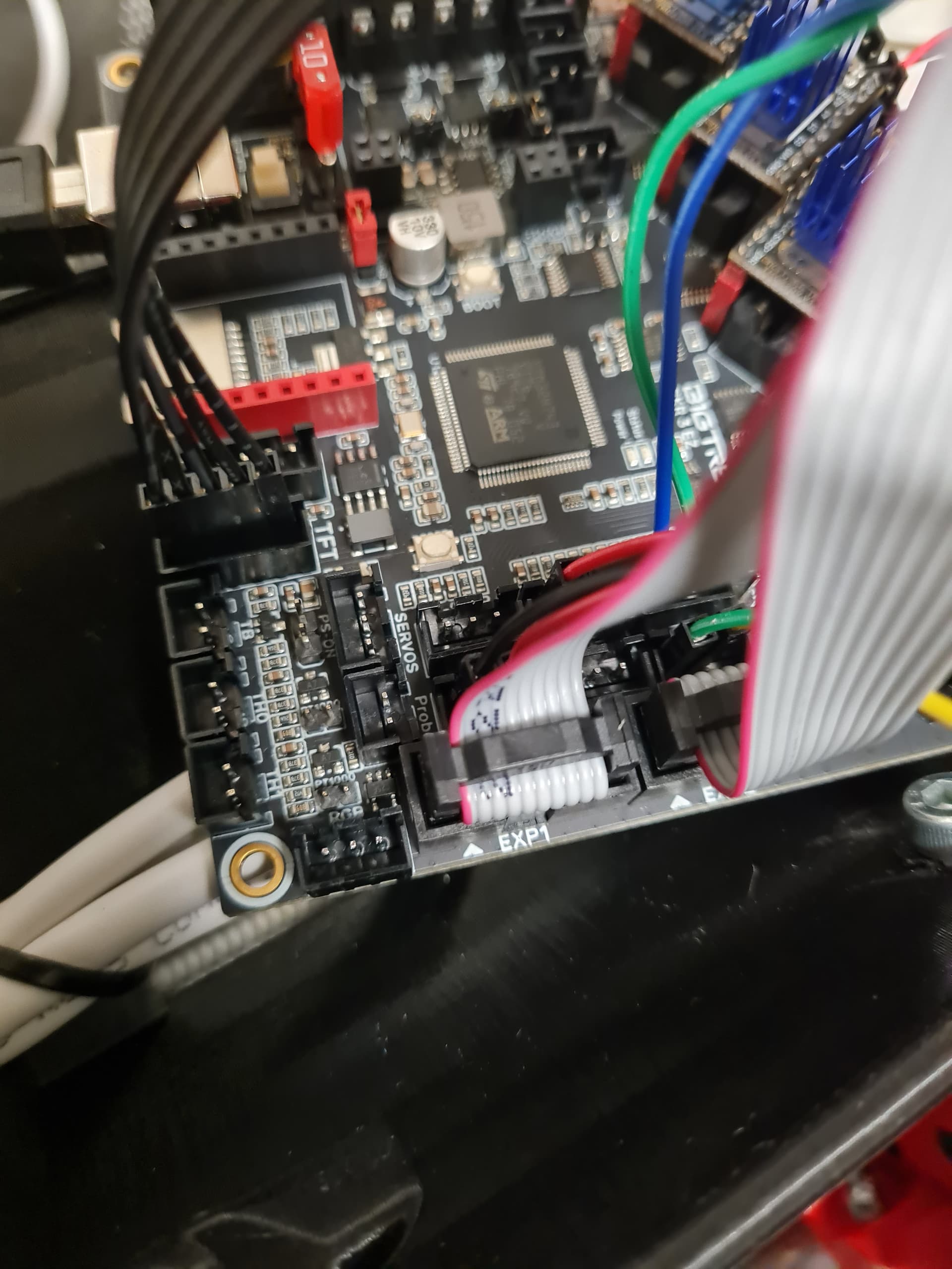

SO here are the pics of the 2 ribbon cables
EXP1 on the TFT35 goes to EXP1 on the board
EXP2 ont he TFT35 goes to EXP2 on the board.

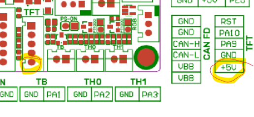

RS232 on the TFT35 goes to the board and is in this pin out
And seems to be in the right order with the 5v line at the bottom.
Also I just did a test and removed the back wires, the TFT touchscreen still works, the mechanical dial does not seem to do anything whether the blackwires is connected or not.

ok i have just physically swapped the cables
so pulled them both out at both ends and used the cable that was in exp1 as the cable in exp2 and same for the other cable with the same result, the screen works for 10secs, i can move through the screens forward and back and use all the buttons, but after 10 seconds the screen still returns to the “choice screen”
So its not the physical cables. pin out maybe.
Just disconnect them. Leave the black wires.
Yep, removing those grey wires fixed that issue.
I can move around the interface and even press and hold to go into and out of MARLIN mode.

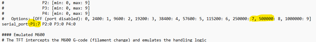

Did you check the baud rate on the tft settings? You can check from the tft display. You don’t have to change the config.ini.

Those cables are needed for marlin mode. You had them wired wrong. The cables aren’t always keyed correctly. It looks like the two heads are in different directions in your last photo. That is abnormal.
Yes, the CNC.tft3 specifices a buad rate of 50k

There is no 50k. You must mean 500k. They need to match. 250,000 is the rate we use on all our firmwares. Now that you know the great cables were wrong. I would try that again.
It is also work checking. In the screen. In the settings menu. To make sure the baud rate is right. I trust that more than the config.

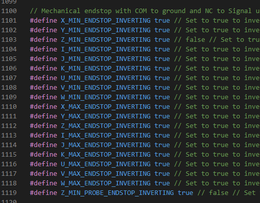

Yes the board TFT35 thinks its got 250,000 so i will change that and invert the endstops again, then reload the firmware again
