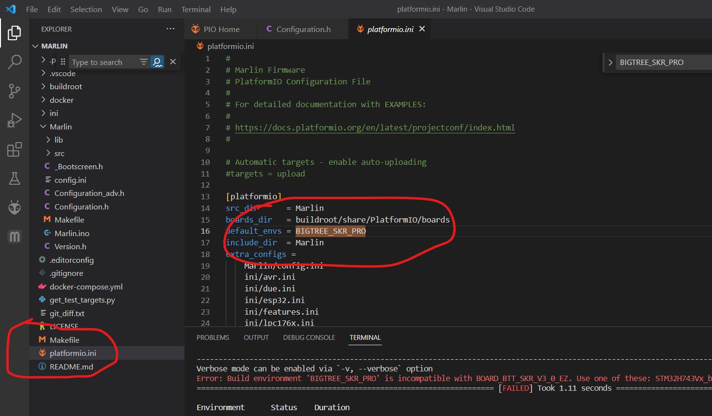

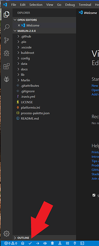

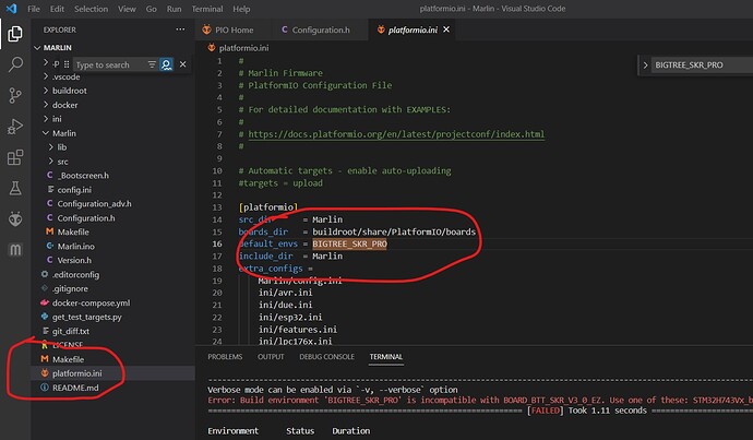

You will not get the arrow or checkmark without the folder structure looking like this, it has to see the platformio.ini file. So I think you opened one folder too low.
Right o, i will give that a go later!
Ok,
so you were right about the level that i was opening the code in VSCODE.
I opened or loaded it in VSCODE with the marlin folder and i am getting the tick now.

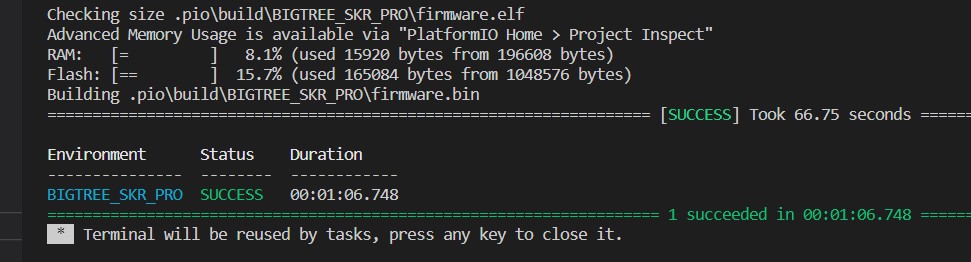

ok, so it compiles ok with no changes.

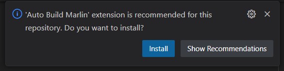

Install auto build Marlin.
You need to change the build environment in platformio.ini I think.
Or Auto build marlin can probably do it for you

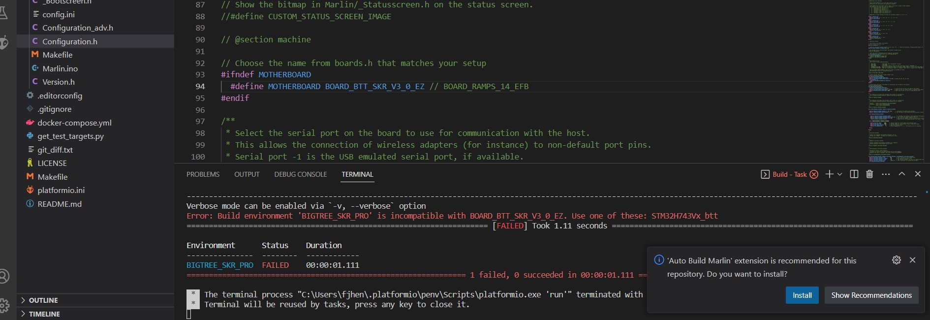

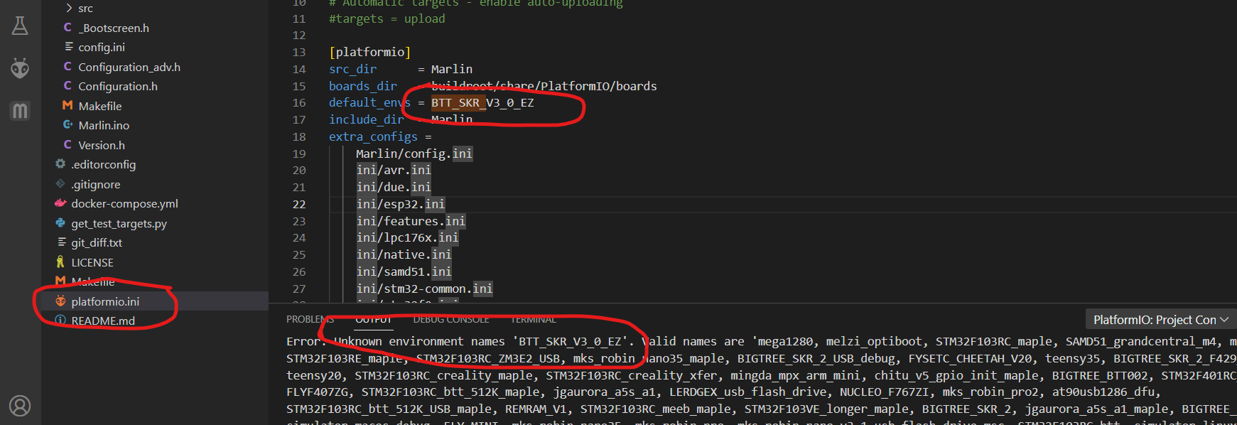

Well done, there was a board call in teh platform IO

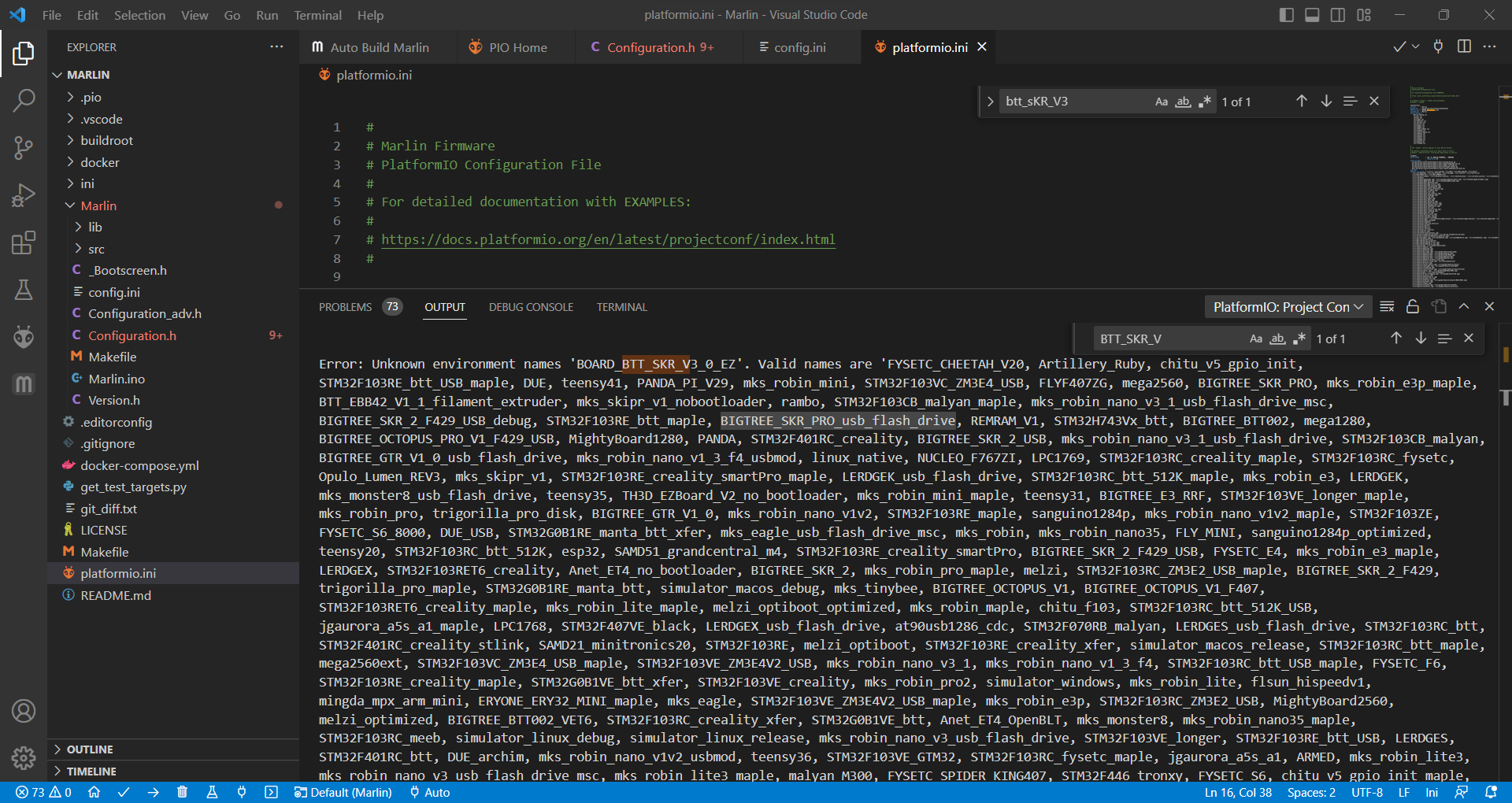

but i changed it to the same as the other board and got a different error
Error: Unknown environment names ‘BTT_SKR_V3_0_EZ’. Valid names are 'mega1280, melzi_optiboot, etc, etc, etc
but BTT_SKR_V3_0_e2 is not one of the valid names. But its in the boards.ini file.

Shoot, true, they need to match. Both need to be changed for some reason.
Auto Build Marlin | Marlin Firmware looks like all it does it chnage teh platform.io name for whatever you put into the configuration.adv. I’d say skip it and edit it yourself to keep things simple.

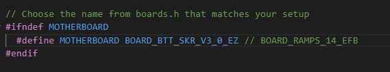

Okay, BOARD_BTT_SKR_V3_0_EZ , shows as a valid option. I think I might know the issue. That board came out after the build of ours you are using. Try editing the two files using one of our nightly builds. linked here, Workflow runs ¡ V1EngineeringInc/MarlinBuilder ¡ GitHub

Then made the change to CONFIGURATION.H and changed it to BOARD_BTT_SKR_V3_0_EZ and tired to build again, but got an error that it was a an “UNKNOWN Environment” still.
Searched the boards.h file and BTT_SRK_V3_0_EZ is there.
Searched the resulting error file for “Valid Names” and BTT_SKR_V3__0_EZ is still not in there.
@vicious1
Could you please try and change it to “BTT_SKR_V3_0_EZ” and just see if I am a spaz?
Use this for your ENV in pio.ini, STM32H743Vx_btt
and in config.h use BOARD_BTT_SKR_V3_0_EZ

I used the skr pro as a starting point and only changed those two things and I get a successful compile.
yep that got it to build!

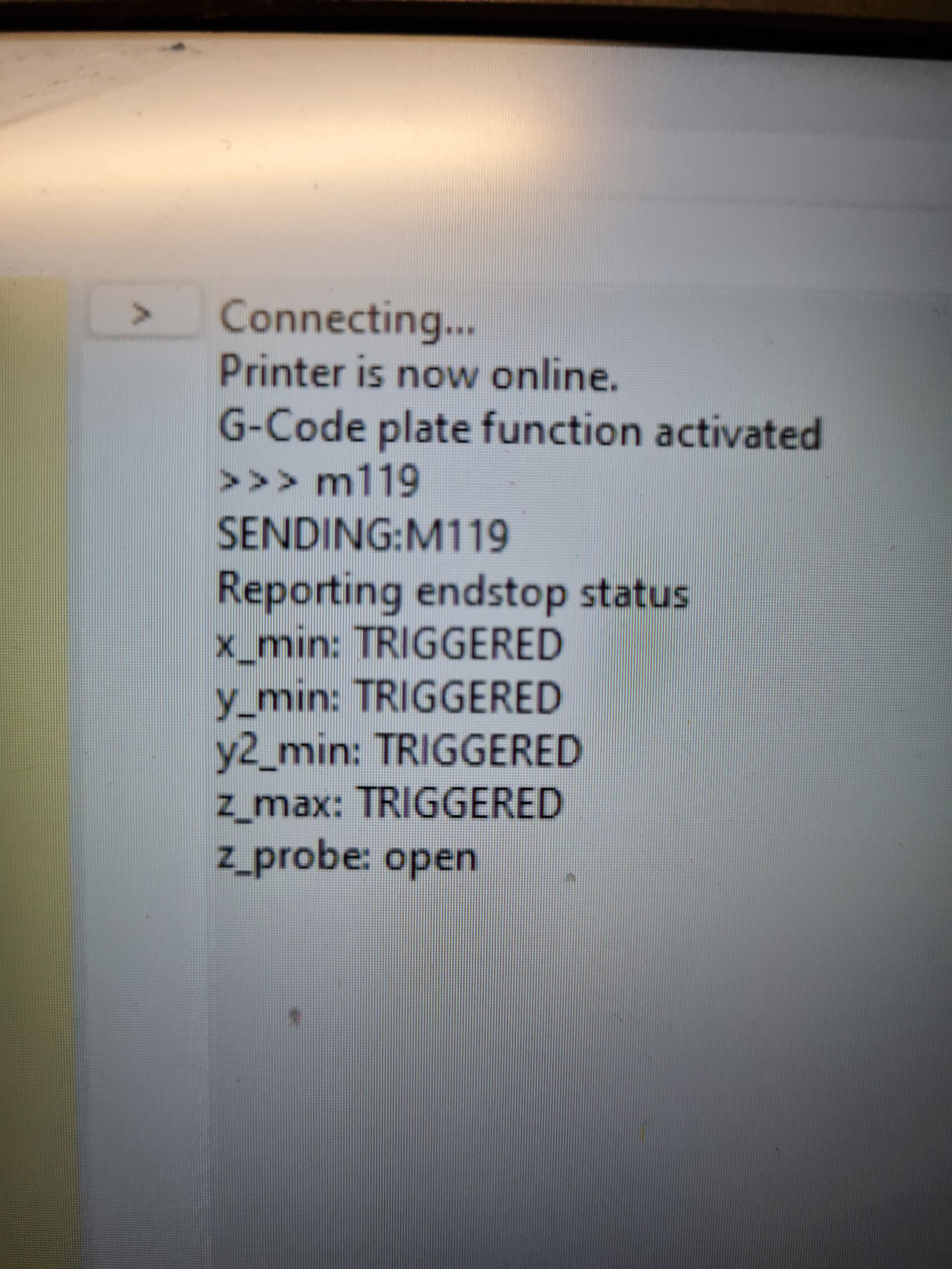

Then I loaded Protoface and connected the board to my laptop, then connecting to it via protoface (as per the video) and I am able to get back a response to M119.
clearly the end stop settings need to be switched around, no big deal.

So a bit more work on the firmware and I have the EndStop inverting properly, but only one of them, Ymin, will trigger but non of the others will trigger.

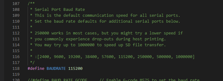

so the TFT is now stable when using the 115200 baud rate in the serial baud rate slot
