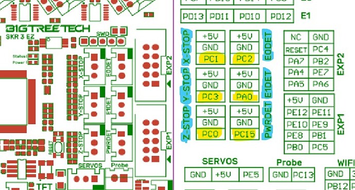

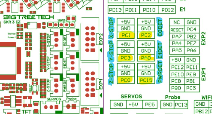

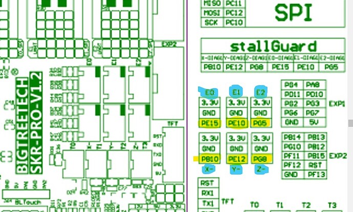

So, I have previously mentioned that I brought the wrong board, the BTT SKR 3EZ, and realising that I checked the pin out of the end stops for the +5v, G, S pins to make sure they were the same as the BTT SKR PRO, no big surprise that they are different. (for instance, not that it matters but the endstops use 3.3v instead of 5v, not that we use it)
Attached are the board schematics, its seem they are using different CALLS (dunno what they are actually called PC10, PC6, PE15, PE10)
BTT SKR pro
BTT SKR 3 EZ
So, not having used the firmware that loads onto the board before, is there a “test” page to make sure that the expected END STOP is being triggered? Or is there there somewhere i can see the output of the GCODE ### M119: Endstop States - Marlin Firmware, As clearly the way Ryan has laid it out probably wont be right for this board and i will need to test it to get the order right.
I am going to just use the X- Y- Z- and the Z-STOP, Y-STOP, X-STOP as the same thing same for E0, E1, E2 as EODET, E1DT, PWRDET as E2

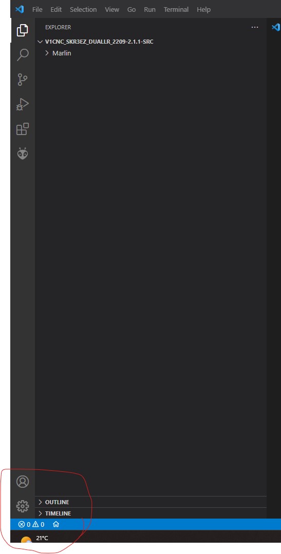

Ok,
I have installed the VS Code and platformio and even downloaded the SKR Pro firmware from the website and loaded it.
I can only find one place to “change the board” under Marlin/ config.ini

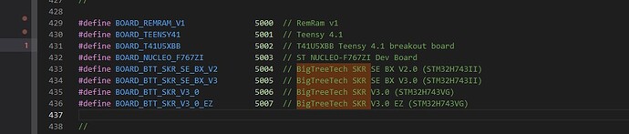

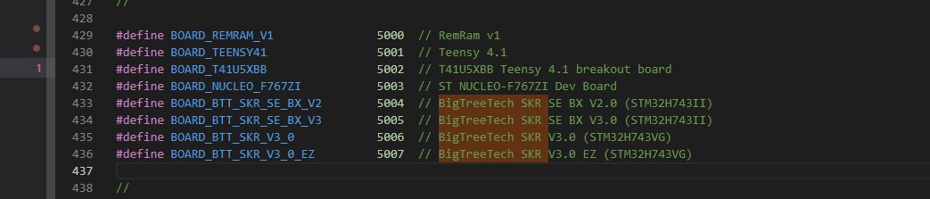

Ok, so with a bit more searching I found the BOARDS.H file under marlin/core in the firmware and confirmed that my board “BigTreeTech SKR 3 EZ” is not listed as a board.
Damm, not sure how i stuffed that up when i brought it

it is probably the same pins as the skr3, try that.
do you mean this one?

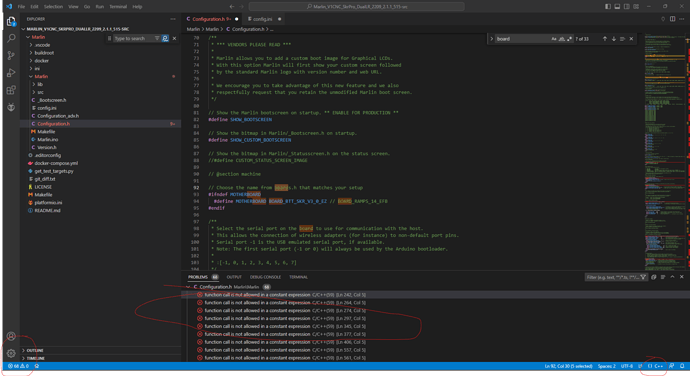

Ok,

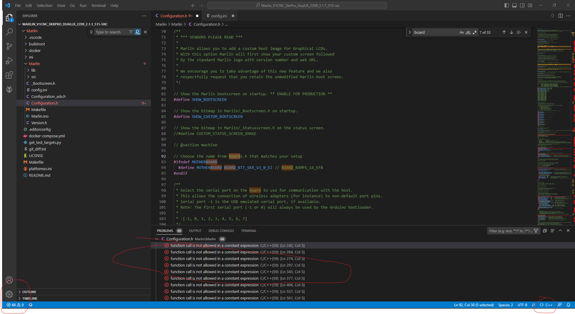

i went over the “learning section” on the docs section and I don’t have that compile “tick”.
Also I am not sure what its suppose to be reading this code as, its saying C++
68 errors,
Take a little step back. Grab our SKR pro firmware, or maybe the skr1.4.
Unzip it and just hit the check mark to see if it compiles fine with zero edits.
Then after that only change the board on line 94. You are showing that some file named config.ini also has some changes, it should not.
As for dealing with compile errors only the first one is valid all the rest are usually side effcts of the first one.

ok, have done what you said, i even changed the name of the source so that it reflects the SKR 3 EZ.
I then opened it and tried to compile it, but the "TICK " is not there.
but got this error, which is related.
btt firmware issues5
Start completely fresh. Unzip a new folder open it and try to compile it with no changes.
Did you install platformio?
