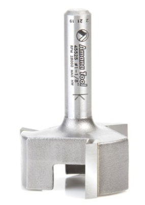

But I have another question, they had this surfacing endmill.
Diameter 1-1/8
Cutting Height 1/2
Shank 1/4
Overall Length (L) 1-13/16
Max RPM 28,000
Flutes 3
AU$50
Clearly this is designed for surfacing as it says it in the name, is this tool a MUST HAVE to surface the spoil board, I ask that as it seems like the “overhang” from cutting down the limits (due to the size of the cutter) seems like a good idea. Again a slightly stupid question, but can the VEVOR/Makita spin this? I know i can take very small slices / Stepovers, but just wondering where the limits of the VEVOR/ Makita power plants are?

I have and have used a 1" surfacing bit in my Makita. It should be able to manage.
Be aware that your tramming needs to be excellent. If you get scorching in one direction, it is probable that the leading edge of the bit there is a bit high. The leading edge cuts as expected, but the trailing edge rubs, and the friction causes scorching.
great explanation, thanks!
In addition to Dan’s excellent advice, I would add: the Makita routers are air cooled, and while I don’t know if your VEVOR is or not, if it is air cooled, consider: The rotation speed matters both for cooling and torque. You can relieve strain by reducing step over, but also by reducing depth of cut, and I lean toward the latter. If you use some tool like GWizard Calculator to find out what RPM speed to operate the router for the surfacing job, because larger diameter bits mean slower RPM speeds, my knee jerk response early on during my first surfacing efforts, led me to reduce RPM speeds. What I should have done was increase feed speed to achieve being able to leave the RPM speed up, both for torque and cooling. And I unwittingly was going deeper and deeper, because the middle of the MDF was higher than the outer edges, and my depth each pass (I was doing a linear zig zag, not a pocket) eventually got too deep. At this point I literally burned up the Makita router. It was not moving fast enough (RPM) to be in its power band for torque, not moving fast enough (RPM) for the air cooling to offset the heat, and the too-deep cut combined with not enough feed speed meant I had slowly created an inferno inside the router. I was able to pay Makita to repair it, but they said I really toasted it badly, almost beyond repair. Another tip: from time to time, check the steppers and router / spindle to make sure they are not super hot. Ideally one of those point and click laser thermo readers. If not, even low tech by “almost touching” and perhaps carefully (i.e. quickly) touching to see if the temp is getting crazy, at least until you get a lot of cutting under your belt.

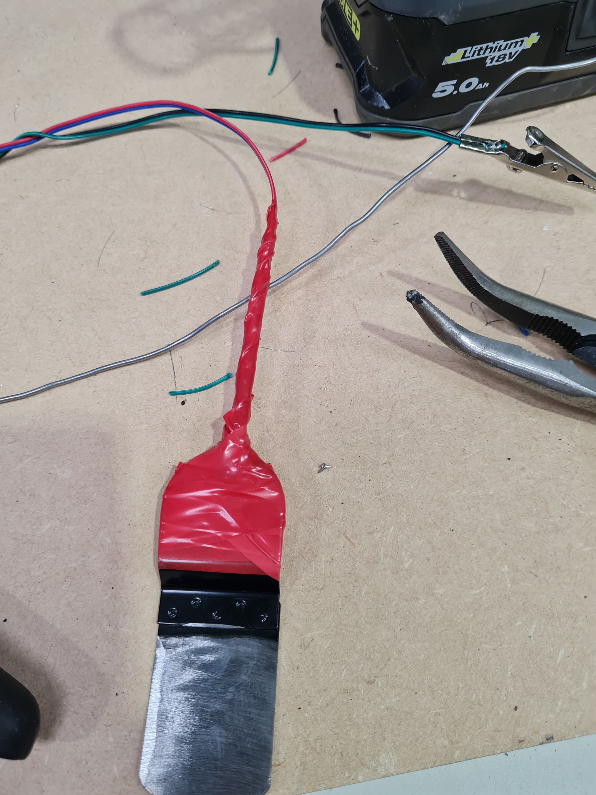

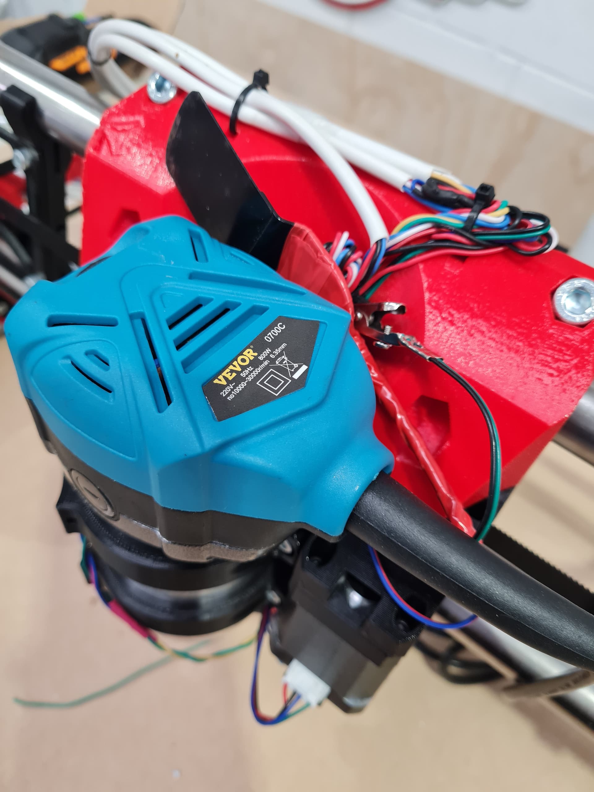

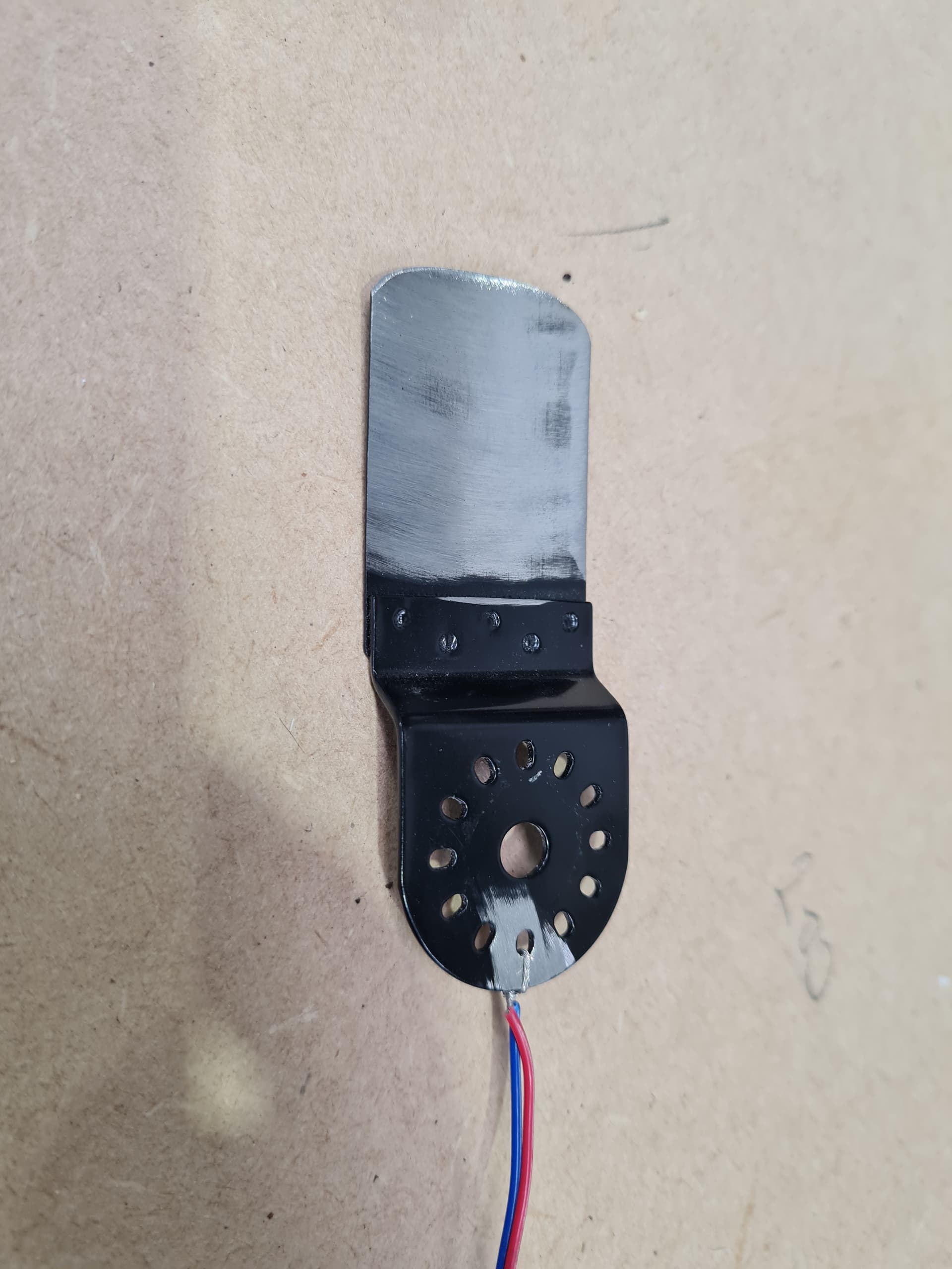

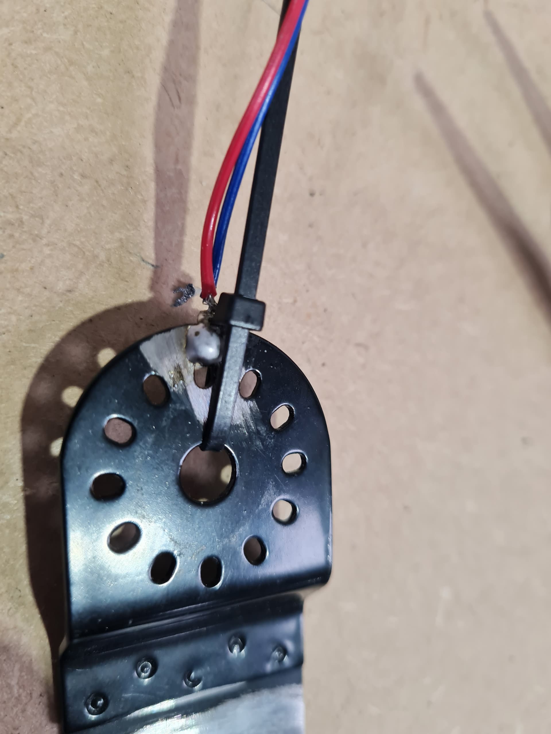

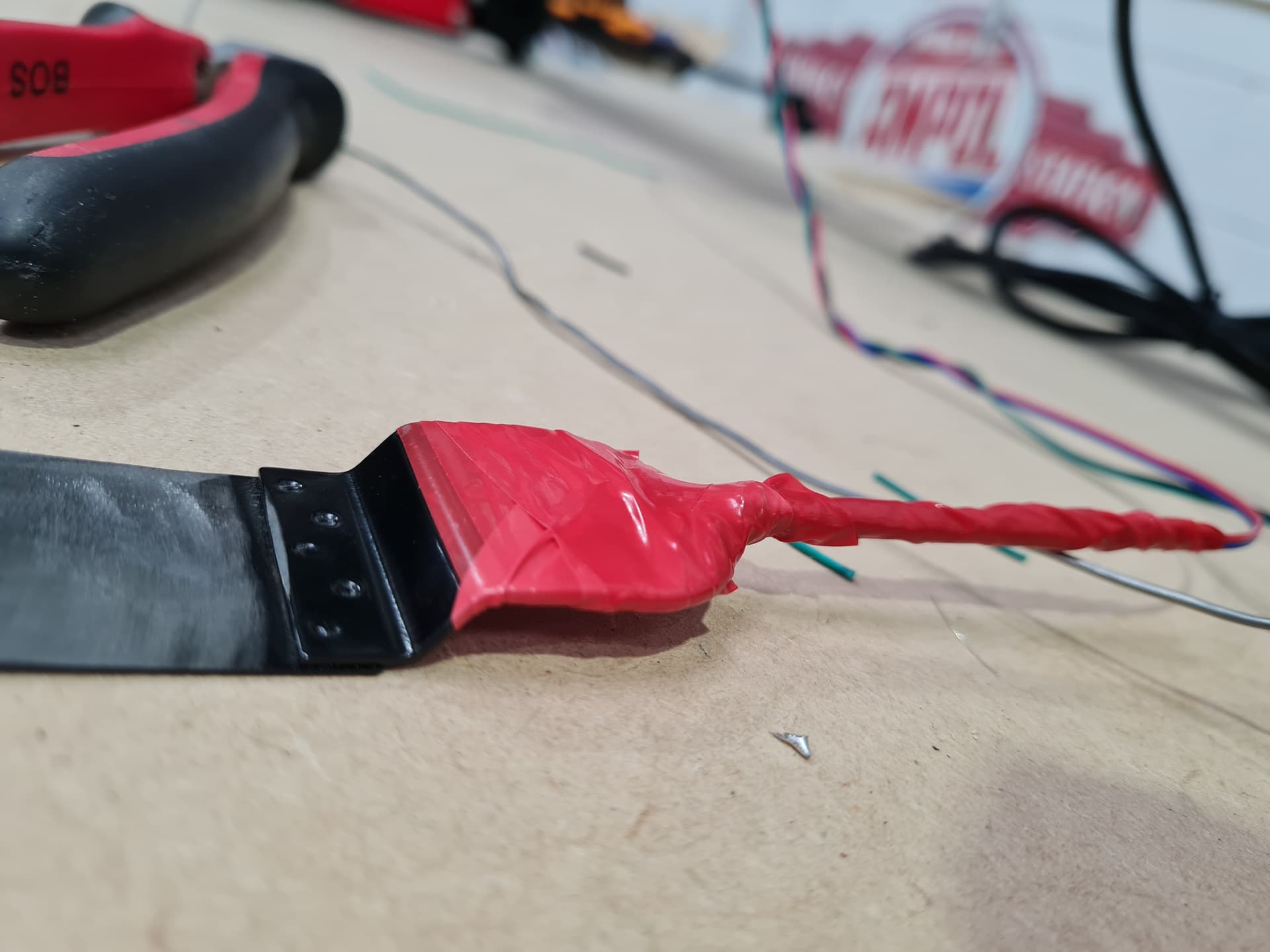

But i did get those things out of the way and decided to work on the touch plate. I had a bit of a good idea
that is a somewhat cheap and used oscillation tool “bit”, it was powder coated or painted, but a little love with the flapper disk and i have a nice touch plate. As you can see i soldered the connection to it and here you can see i used a zip tie as support for the wire join
Throw an excessive amount of electrical tape at it and you get
Like doug, i rhink it will live here, but time will tell.
I would not mind to mod the core and implant some magnets up there actaully…
