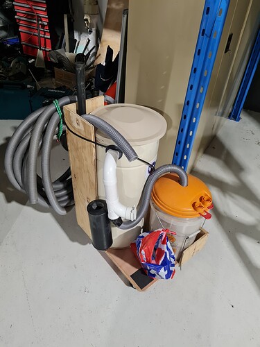

Ok, i had a bit of tike today and needed to destress a bit, so the LR3 got a bit of love
I replaced the electronic box with one of the ones from @DougJoseph stavle of designs.
Then i Frankensteined up my dust extractor together
So that is a whole home central vac going onto a triton dust seperator bucket
Eventuality, i will have a taller section and a boom to route out and over the table, ok that doesnt make a lot od sense, its late ans been a long day. Lol

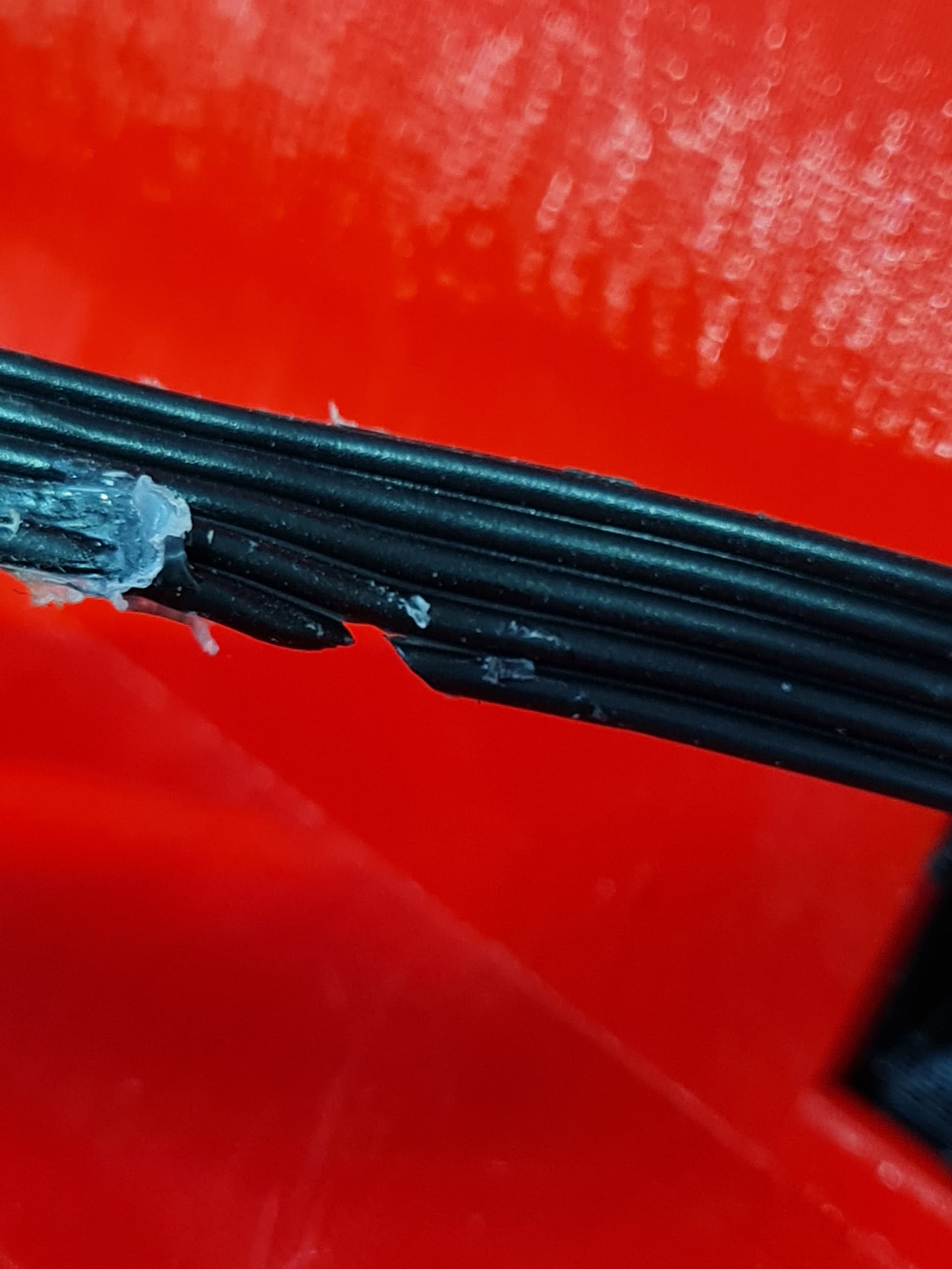

Well that is a problem
That is the line to the lcd
Ok, fixed that opps.

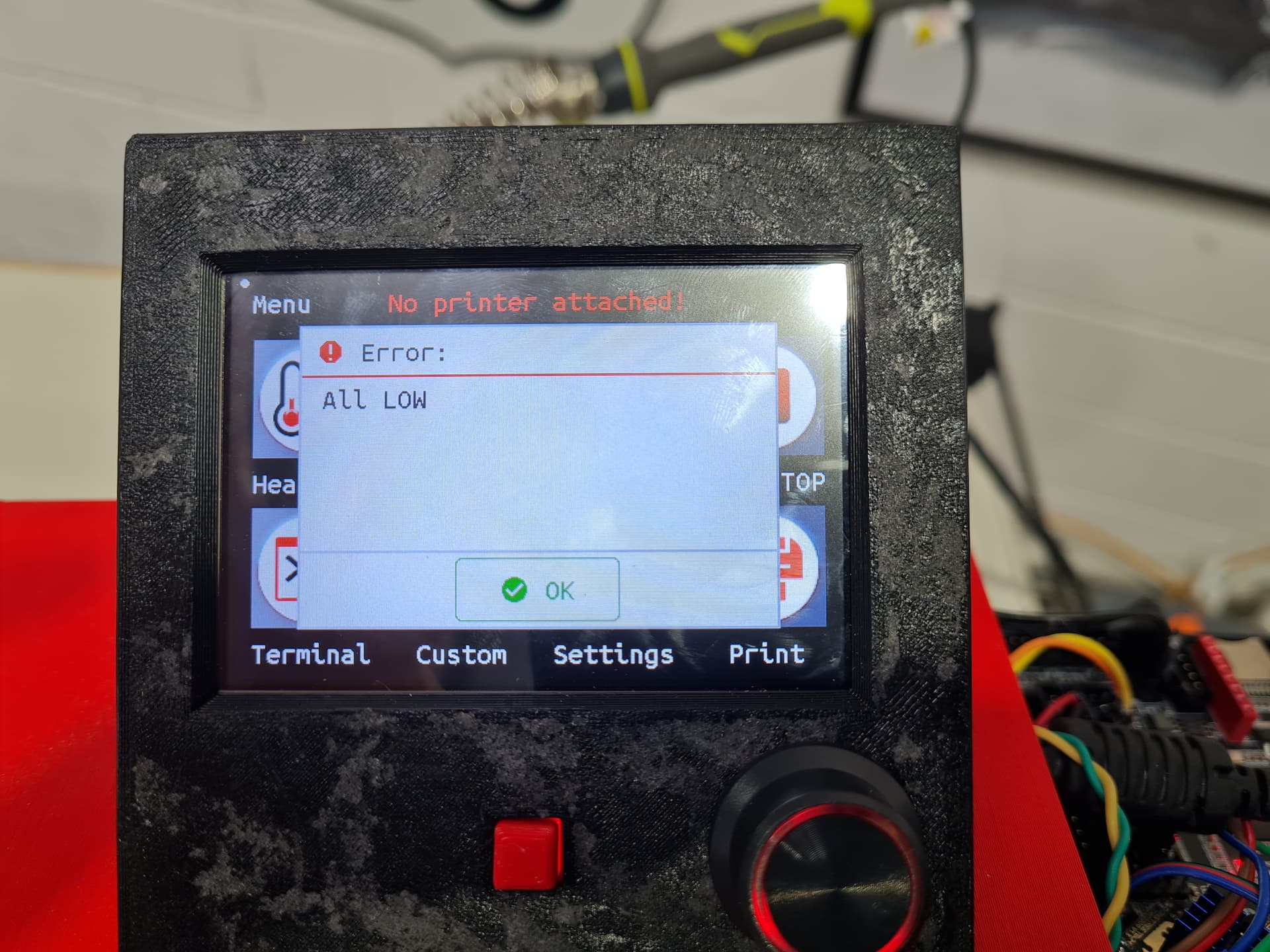

Jusr a question for the smarter people that atlre playing along at home.
Anyidea why my LR3 says “all low”
Because it’s picking up a signal from your tyre pressure monitor?
(sorry, that’s probably not particularly helpful! :innocent:)
Usually it says that when you do not have any drivers in the sockets.
Or it says that when there is no motor power.
Hmmm interesting.
As there are drivers in all the sockets.
Basically you plug in the power and the TFT lights up with the logo and then drops to the normal screen, but along the top there is “no printer connected” and then about 10seconds or so later there is a series of beeps and then that screen is shown. after you hit ok the LR3 is live and you can move it.
