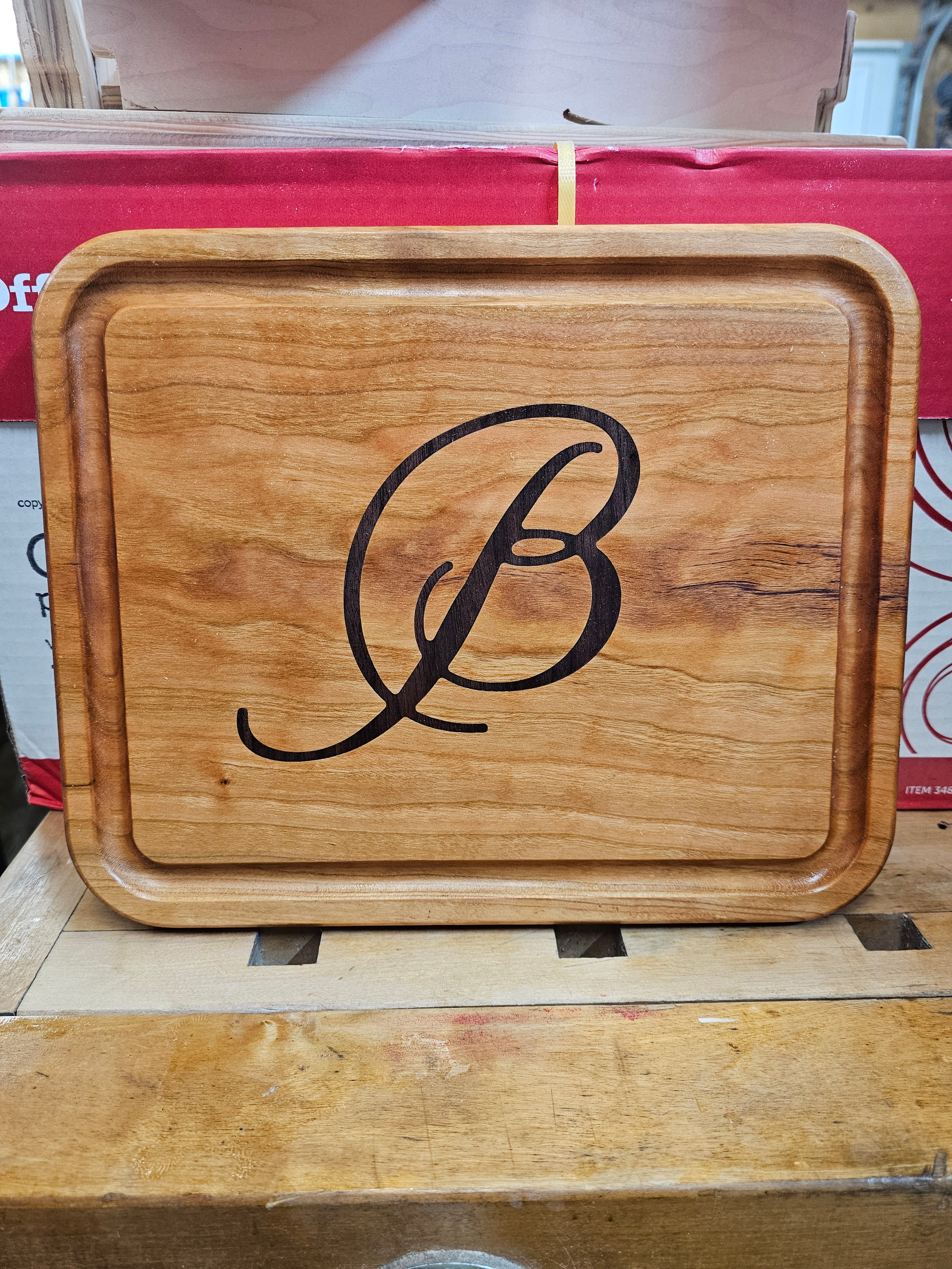

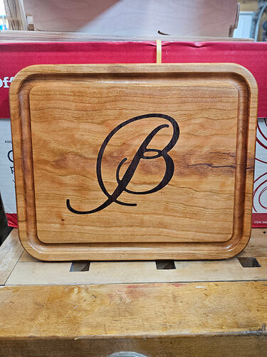

An inlay?? Or is it epoxy?
Inlay, that is a cherry board with a walnut inlay.
I am using MillMage to create the design and control the CnC.
My first Lowrider is a 24 x 48, but now I find I need a larger machine so the stable will have 2 of these great machines making noise.
Life is good!
Okay, then I applaud you, because it looks really, really great! :tada:
You cut it with a straight endmill I supposed since MillMage does not support V-carve inlays yet, correct?
It does look great! Can you share more about how you made it?
Dang Bob, from having issues straight to a fantastic inlay. Congratulations.

It was made with a flat bottom 1/8 inch endmill. The female pocket is .002 inches larger than the male insert. I do the male part first then the pocket at a very tight tolerance. I then enlarge the pocket at a rate of .001 inch until I can get the male part to fit. I did have to modify the font in a few places so the mill would fit without enlarging the font.
