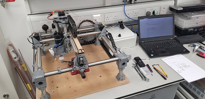

So here’s a picture of the machine:
I’ve done a calibration of the X,Y,Z steps/mm. X and Y were over-travelling a tad bit.
X was 0.25mm off in 90mm travel.
Y was 0.13mm off in 90mm travel.
X,Y setup like this:
Z setup with a dial indicator (plunger style).

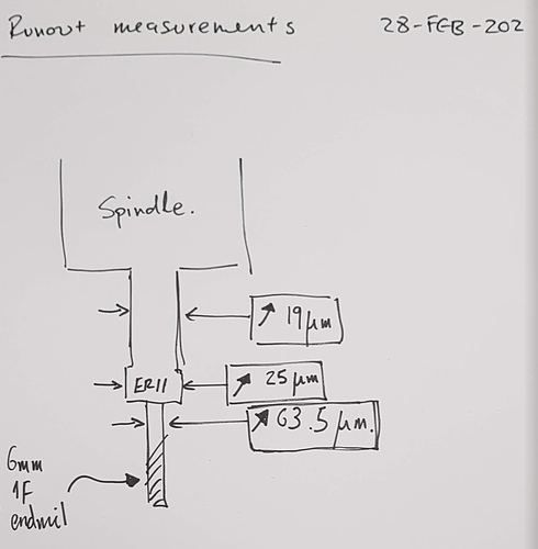

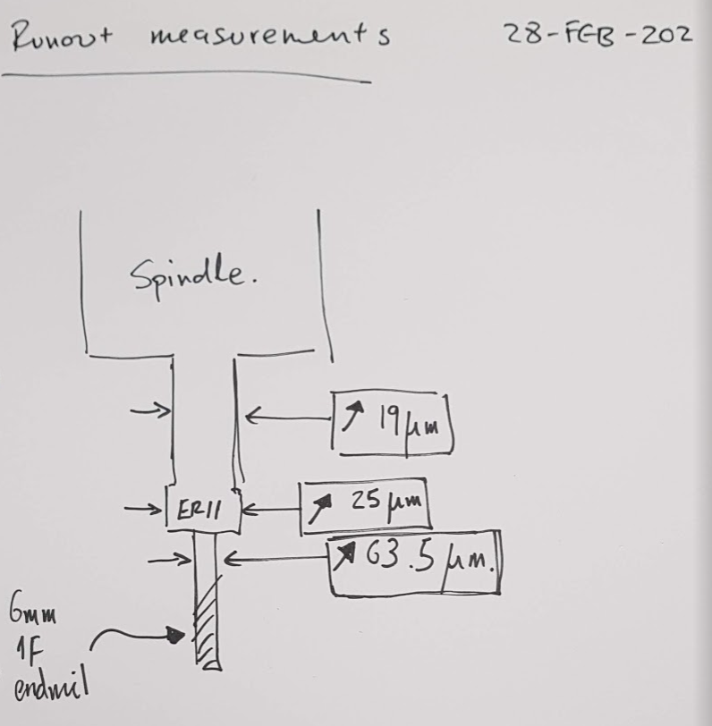

I also performed some tool runout measurement with a dial indicator.
I was hand turning the spindle. I imagine the runouts get a lot worse when spinning at 5-10krpm…
These are the results.
Looks like my tool has a lot of runout (63.5um), but the spindle collet holder has significantly less. Bad collet? or bad interface between collet and the adaptor ?

I’ve got a lowrider with the dewalt router but I was able to get within 0.1mm accuracy cutting small parts on aluminum with a single flute mill maybe I got lucky. It might have been more accurate but I know it was at worst 0.1mm. I didn’t try super aggressive cuts but if the finishing passes are setup correctly it shouldn’t matter unless you go crazy. A few things that come to mind are making sure the belts are tensioned, using an endmill no longer than necessary, and using a spring pass in fusion.
That does seem like a fair amount of runout but I’ve never measured mine. If it’s the same on all your bits might be worth trying a new collet? Also check your bit against the collet… I heard it causes problems if you use a 3.185mm collet with a 3mm bit.
Those spindles have a lot of runout. That’s why I went back to the Dewalt.
I think we need to add some sort of disclaimer about those spindles. The ones with the add on collet thing (grub screws on the shaft) are never going to be good. There are some with a integrated collet, they might be okay (I have one but no test yet).
You are using screws on your belt tension, are you sure you did not over tighten and stretch your belts, there is no other way to over travel, if anything you should be under (kind offsets the runnout this way)…

Yes the spindle is one of those cheap ones with the grub screw collet holder. I guess that kind of explains the run-out issue…
With regards to the belts I’ve got them quite tensioned (no way to quantify though…) Any suggestions on belt tension in general ?
If it sounds like the high note on a base it’s to tight
It’s hard to do a “how tight” because everyone’s machine is slightly different, or a lot different. Like Tim said, if you can play musical notes, it’s too tight.
It depends on the length of the belt… my 3D printer is a higher pitch than my low rider. There is a phone app called easy tension that lets you input the belt length and then use your microphone on your phone to measure the tension.
