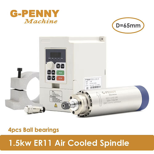

All this talk of spindles got me intrigued, and I found a kit on Aliexpress that seemed decent and was decently priced. It’s 65mm diameter, air cooled, 1.5KW, and comes with a matching VFD. So I’m going to give it a try. With shipping and tax I got it for around $221.
https://www.aliexpress.us/item/3256802114599604.html?spm=a2g0o.order_list.order_list_main.5.3dee1802je7IqN&gatewayAdapt=glo2usa
Looks good. Note that link is for 220V.
There is a 110V option, but the specs for that one still show 220V only. Also it says to leave a note on the order for 110V model, so just selecting the 110V option on the order page may or may not get you the right version.
@DougJoseph - Which version did you get?
I ordered the 110v. Since it costs a bit more, I’m wondering if the only difference is the VFD containing step-up transformer function to get 220 from 110.
I did not see that, but maybe the note predates them having a defined way to order a 110 versus a 220. ?
Hope it works out for you. It looks like a very interesting piece of equipment.
The fine print on the web page (in the “view more” section) notes that the air cooled version is “very loud”, which it would be, relative to a water cooled version. I’m wondering if it is any better or worse than a router.
Once it arrives and is in use, can you let us know if it is any different noise level than a palm router (no load/no cutting)?
Looking forward to your review.
Will do.
That spindle looks identical to my Vevor spindle. Wouldn’t surprise me if its made in the same factory and just a different label slapped on it. I wish you great success with it! They do tend to get warm so I would suggest something other than PLA for your tool mount. The Makita mount works great for it, but the Makita dust shoe doesn’t, I ended up running the dewalt dust shoe and that has worked great as well.
@Jonathjon Cool! Thanks for the tips! I had already printed out tool mounts in PETG. And I had not printed out a dust shoe for the full size LR4 yet so that means I can adjust without a waste of printing time there.
Glad I saw it in time. That snout on the Makita/Kobalt one gets in the way for sure. But with the Dewalt one I had plenty of room to get my wrenches in and change bits no problem
