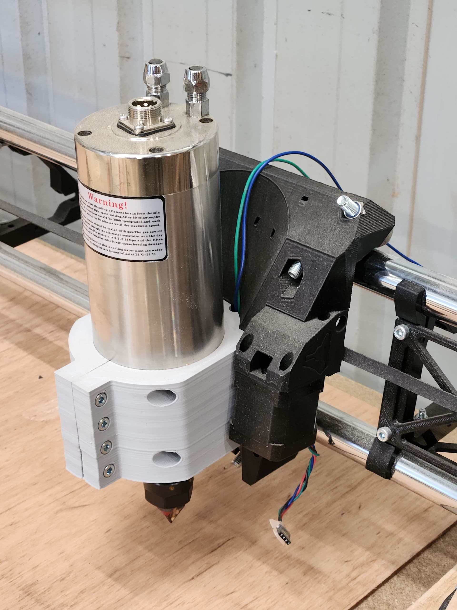

80mm Spindle on LR4?
I have a 80mm 2.2kw spindle mounted on my LR3 and have just started printing LR4 parts. However the Printables page (snip above) says that the max tool diameter is 69mm.
Is the 69mm limit a hard limit or is it due to a lack of currently available files for larger mounts?
Hard limit, anything larger would stick out very far and make for a horrible experience. 2.2kw is pretty insane for a CNC of this size really.
Do you have a picture of it on you LR3? It should not fit that either. You must have had a cruddy cutting experience??
I hadn’t got to the point of cutting, it’s been an ongoing build for about 12 months - just a bit at a time. I recall reading that 2.2kw was optimal but I could (easily) be mistaken/wrong.

The LR4 Makita tool mount’s opening, printed dimensions (natural position, not flexed), is something like:
65.30 mm diameter / 32.65 mm radius
Contrast with:
80.00 mm diameter / 40.00 mm radius
That larger size would push the spindle away from the core by at least 7.35 mm, and could be more depending on how the mount remix was done.
That extra distance creates a lever type force that works against the machine regarding rigidity (creates likelihood of runout problems).
The more distance from the core the worse the risk of flexing and runout.
Our little 1 1/4 hp routers are very hard to overpower. 2.2kw is “supposed” to be 3hp.
Doug is right, pushing the cutting bit further from the core makes performance drastically worse. 2x the distance = 1/2 the rigidity if not less. So any added power is lost to less rigidity.
Unfortunately the balance here is rigidity and power and the palm routers seem to be ideal.
Maybe another way to put that is chances are really good you are going to see lower performance with that spindle than a palm router that is closer to the support rails.

i have a 1.5kw spindle as well 80mm and I had to redesign my holding mount to be closer to the core to improve cutting you’ll be surprised what a .5’’ makes (my spindle is roughly 5lbs)
