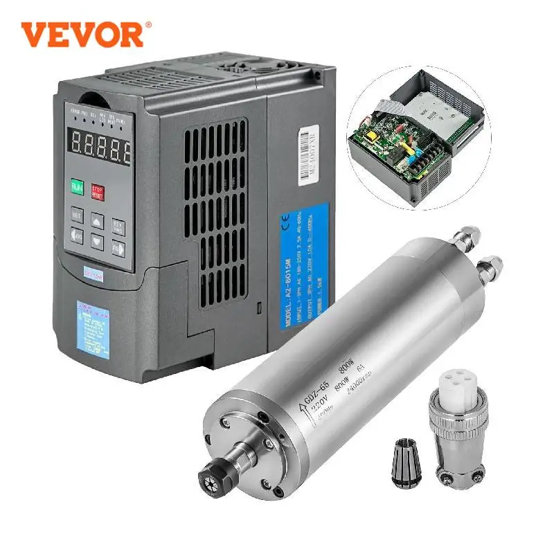

yess i got the water cool but it’s super silent
So is the air cooled!
I also came across a 1.5kW water-cooled spindle from Vevor with a net weight of 3.8kg. Might be another option to consider!
Edit: This water-cooled spindle now seems to be unavailable.

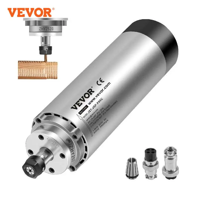

I have the 1.5kw air-cooled version and the “no-load” noise is actually very low, it’s nothing like a palm router
But you must keep in mind that most of the noise will come from the cutting bit hitting the wood, and this will cover any difference between air-cooled or water-cooled spindle…
On a side note, the water-cooled spindle might be a good fit if you regularly cut at low rpm, because the airflow directly depends on the motor speed on the air-cooled version
This is probably a much more accurate choice element than “noise”
Note for any Australians following along, the 1.5kw air cooled spindle is back in stock in the Australian Vevor store. I just ordered one :+1:
