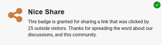

Heh, really happy about that badge:
Spreading the gospel. :stuck_out_tongue:
Heed the word and be the living proof! :grinning:
