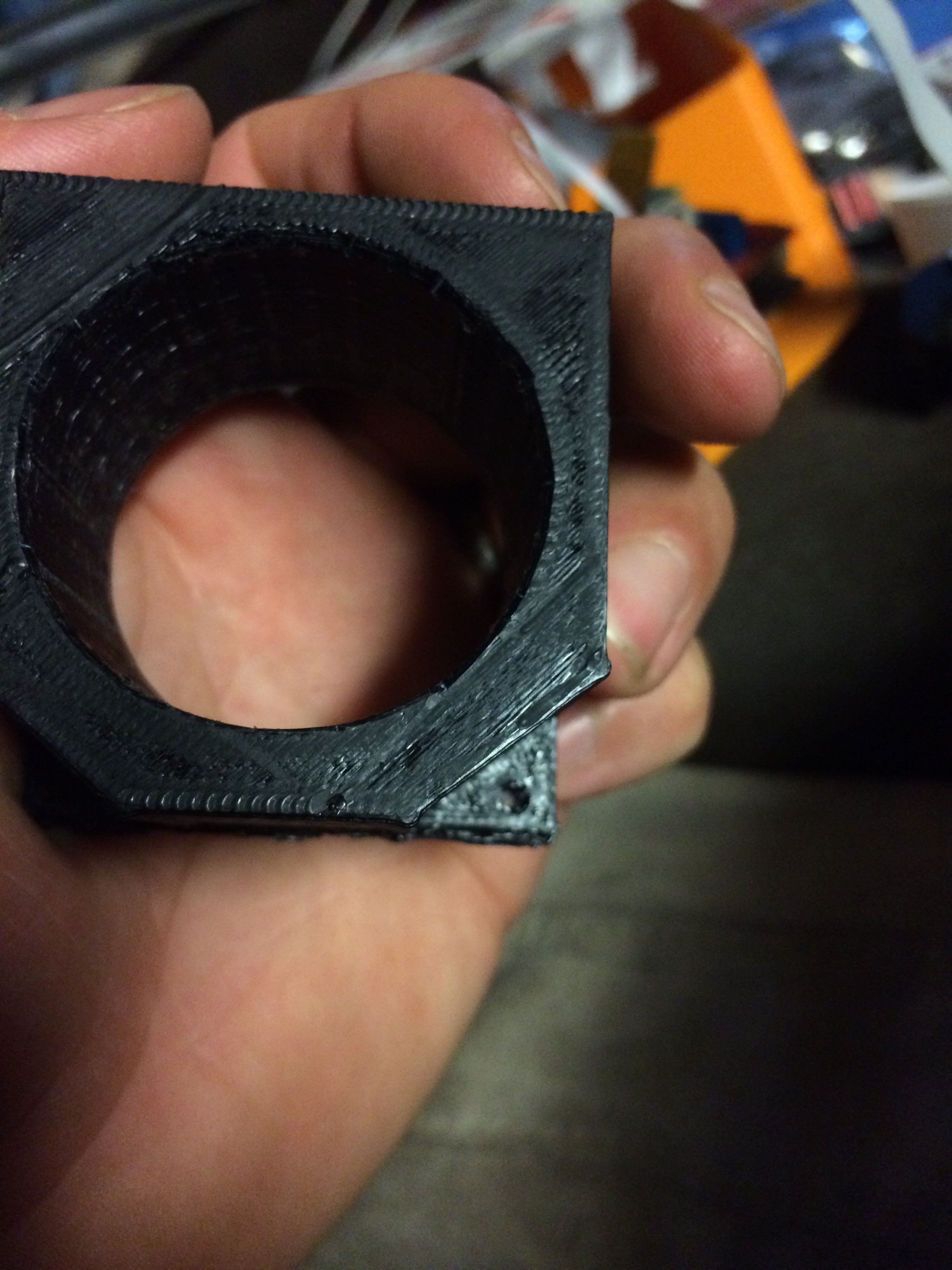

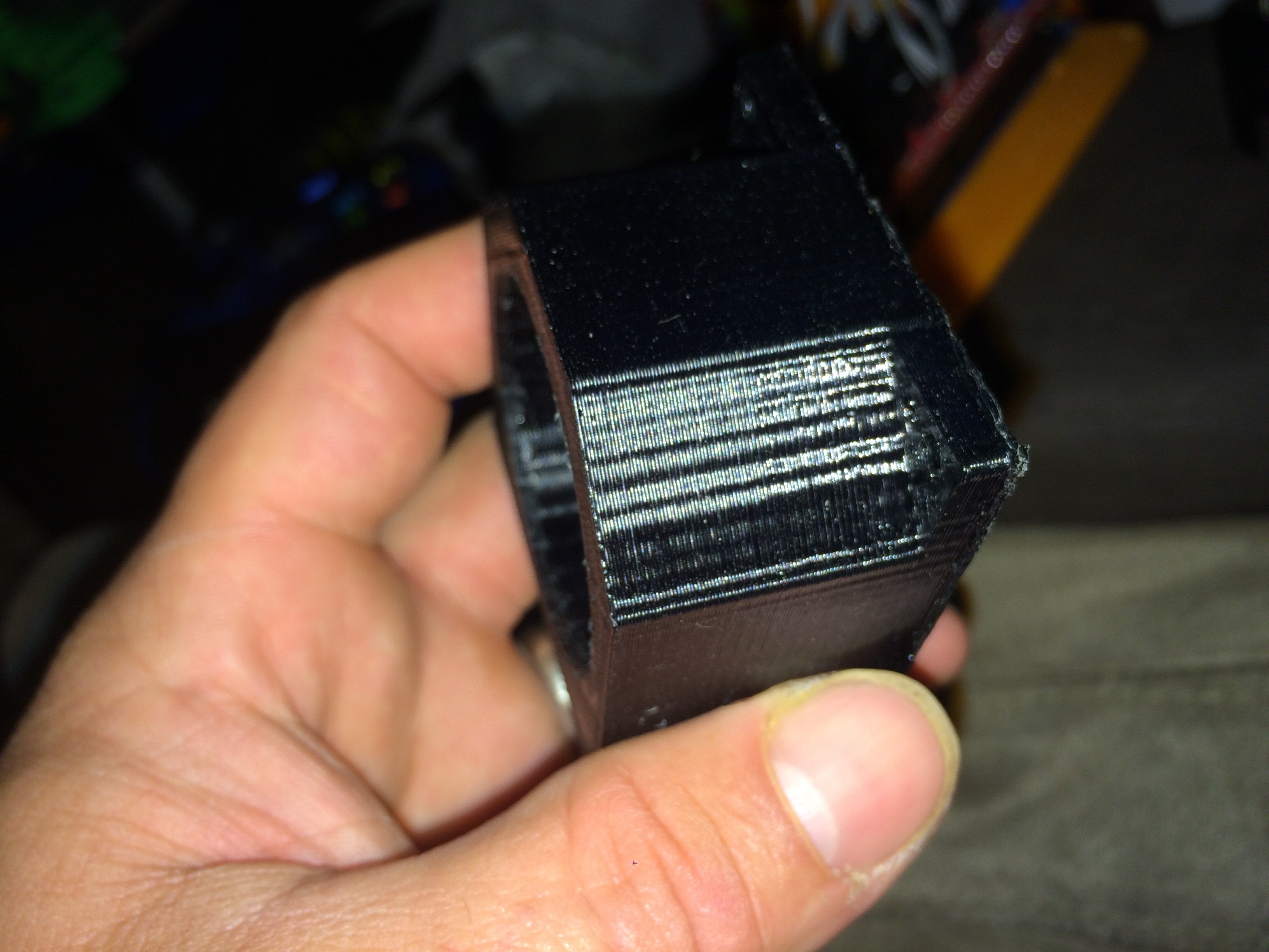

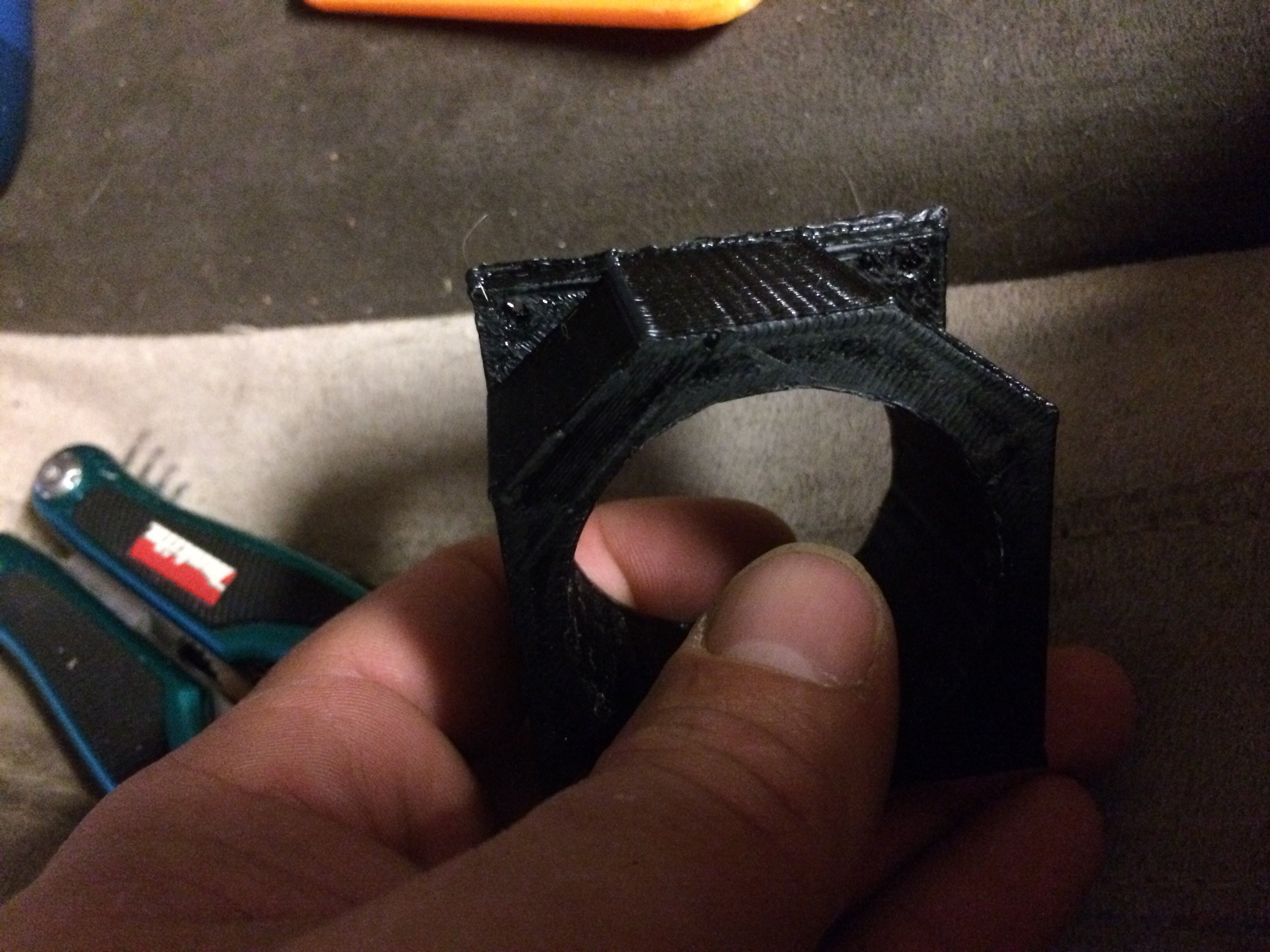

I’m having what I assume is a firmware issue. in the photo you can see that I got my temp settings dialed in, but I’m having a problem with bulging corners. i imagine it’s a firmware setting. and I need to fix it because it causes the inside of holes to be smaller than the model because holes are technically just a bunch of corners. wondering where I should start tweaking. jerk, acceleration, etc.
