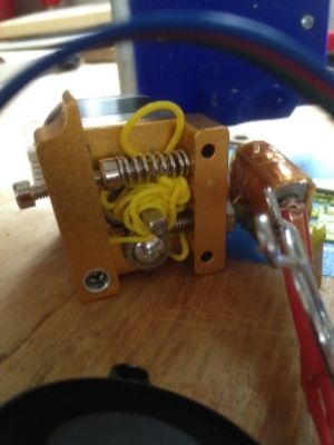

I am not the biggest fan of this extruder yet. a big mess
Is that flexible stuff, TPU? Did you find the issue, was it a clog?
I actually love these things, and have been slowly switching out my JHeads.
I am using the last of my HatchBox PLA on this test. It started out fine then bunched up. It happened twice before I realized that the cooling fan was barely running. I will put in a new fan and test it later but I think that is the issue.
Either youre hobbed bolt isn’t lining up with the throat or the throat is clogged. there is a ptfe liner in the throat so you shouldn’t see excessive backups like this just because the fan is breaking down. unless you keep your house 90 degrees. you need to pull the nozzle and throat and make sure they are clear. your fan also needs to be addressed for sure, but your extruder shouldn’t look like the picture unless you didn’t get the filament lined up properly, if it was filament backing up in the hot throat then you’d see some oozing somewhere around the throat. it could be something as simple as a tiny little nic in the ptfe liner.
Actually cooling the extruder does amazing things to not pre-melt the filament! I think I will be adding a second fan on the stepper itself as it seems to get rather warm
If your extruder is too hot turn down the driver. There is no rhyme or reason to these extruders. I have my drivers from .45v to 1v huge difference.

To turn it down, you need a voltmeter on it’s lowest DC setting, negative goes to the negative of the power plug positive goes to the little silver pot/screw on the driver. They are very sensitive, tiny movements. I would go down in .1v steps.

It was set at 1.54V. I looked at the three you set and they were .55 to .75 so I set the extruder to .70

wow 1.5! you’ll know its too low if the prints get a texture and you can feel it kinda vibrate as it pulls it through. Too high and the stepper gets hot.

I want to thank @Ryan and everyone who chimed in. Adjusting the voltage on my driver from 1.5V to .7 made a HUGE difference in my stepper temp. I have a part that has been printing for over an hour and the stepper is 78F and the top of the extruder is 86F in a 60F environment. THANKS!!
