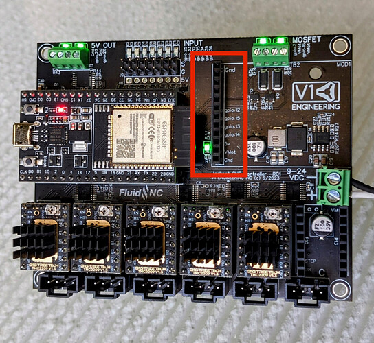

I’m building the LR4 with a jackpot. I am using the spindle AMB 1050 FME-1 DI, the speed can be controlled via a 0 - 10V signal. For the signal I will install Bart Drings controller modul on the jackpot. I just ordered it, lets see how the installation will go :slight_smile: .
Somewhere in the future when everything else is running I would like to add the dail pendant described by @DougJoseph .
The dail pendant seems to use some of the same pins as Barts module. Does that mean they can’t be used together? Does the Module actually use these 4 pins. Is a workaround possible?

The 0-10V modules work, but we’ve had some folks encounter difficulties with them on their particular VFDs. You’ll provably want to continue this thread when you get the module, and get more help.
The 0-10V module needs 3 GPIOs, and the FluidDial Pendant needs 2.
Only 4 GPIO are available on the Jackpot, so you will not be able to run an 0-10V spindle and the FluidDial pendant at the same time on a Jackpot.
The isolated RS-485 module only needs 2 GPIOs, so with that interface it may be possible to have both the spindle and the pendant. If your spindle has an option for RS-485 control then it may be possible to use both spindle and FluidDial on a Jackpot. You’d need the isolated RS-485 module instead of 0-10V module.
I don’t have either spindle type to test with, so I can’t confirm it works. (I’ve tested with an adapter board of my own making on one of my machines, and FluidNC accepts the config- but I don’t have the spindle to test with.)
That test board setup is what @Jonathjon is describing- he has one of my early prototypes.
You may instead want to track the activities of our own @jeyeager , who is experimenting with a pendant type interface that works entirely over WiFi, not needing any GPIO, nor any cables to the Jackpot. I’m considering building one of those myself.

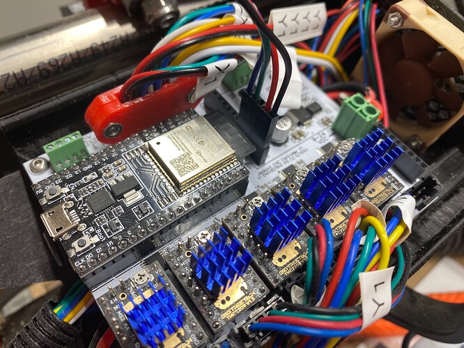

There are 3 things I would check:
  1. What version of FluidNC are you running? There were issues in late 3.7 versions and 3.8 versions that are resolved in 3.9. If you accessed the WebUI with one of these versions while the job was running, it could explain the mid job freeze because it was crashing the controller.
  2. How do you have the wires run? Running them under the board is recommended but anything around the antenna on the ESP32 will result in a poor wifi connection.
  3. If using WebUI v2, make sure you don’t have it open more than once. That can cause memory issues which could cause the controller to restart.
thanks for the reply, the version 3.9.1 is installed and the wires are placed like that
grafik
Can the fan at the top of the box cause wifi issues?
It hasn’t for me on any of my builds. Its on the opposite end of the jackpot from the WIFI chip so it shouldn’t cause any issues.
I don’t like that wire being where it is. I’m not quite sure what I’m looking at there.

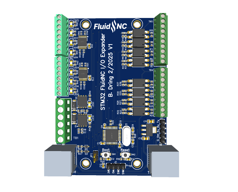

@MakerJim you may find this interesting. The FluidNC dev team is picking back up a project to add STM32 UART based I/O expansion. Maybe that could potentially allow for using a pendant and control a 0-10V spindle?
http://wiki.fluidnc.com/en/hardware/official/STM32_IO_Extender
Is that the probe wire - coming out beside the SDCard slot on the right?
STM32…. Hmm I wonder if that will lead to support for encoders.
yup, thats the probe wire. I rerouted it and did a short test. At least in the test there was no wifi loss, so lets hope that this is resolved… thanks for the support.

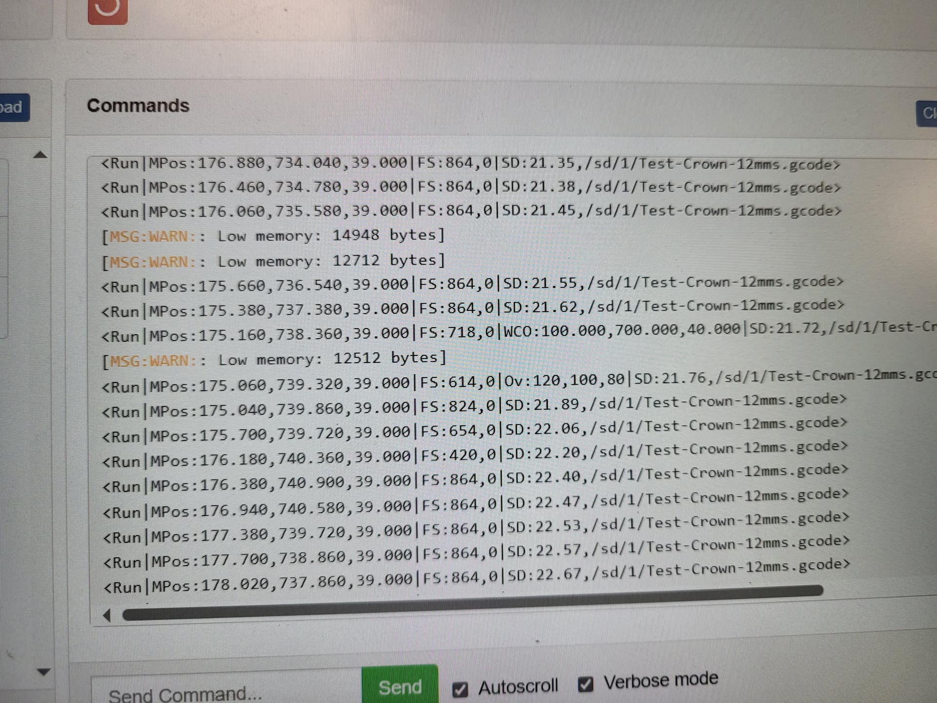

some more questions:
  • after a bit of jogging and homing this error message appeared: MSG:ERR: Channel device rejected config
  • what do I have to look for, when the error message appears: Error66: failed to open file, when opening a new file?

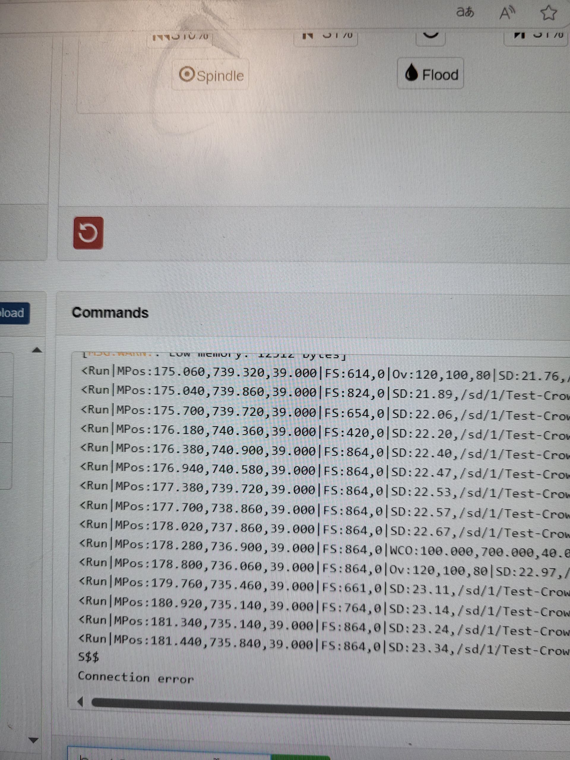

  • I was running the crown file for a test without spindle on, which did run perfectly before and at 23% completion it stopped. notebook showed still connected to wifi, but when I tried S$$ it said no connetion. short before the stop, there were low memory warnings.
    Any ideas on the errors?? Thanks!
Are these things all happening together or are these different things happening during different times?
I’ve never seen that one before. I don’t understand what is going on here, but looking at the FluidNC code, that error gets raised when it receives a 0xB3 “NAK” character which is some kind of “negative acknowledgement”. I think that’s more a symptom than a cause.
That one is fairly self-explanatory but I again think more just a symptom.
Basically, something happened and FluidNC could no longer maintain a connection to the WebUI.
It’s been quite a few versions since I’ve seen low memory warnings. When the memory gets low enough, it causes the ESP32 to restart. I think that’s what is happening when it stops.
What are you doing while the job is running? Are you refreshing the UI? Do you have the UI open in more than one place?

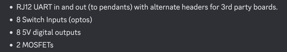

@jeyeager and other interested parties (Like say @vicious1 )- a note on the STM32 IO expander that Bart and Mitch are experimenting with. This thing is REALLY interesting and would be a way to seriously improve the capabilities of a Jackpot system… Here’s a sneak peak from their discord:
I may start a thread here on V1 in hardware development so I’m not poluting this thread.
Edit- preliminary specs:
