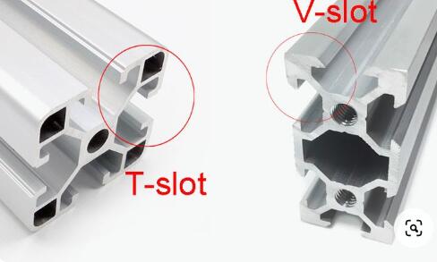

Is the zenXY v3 using 2020 extrusions?
I call dibs on a hardware kit. :grinning_face_with_smiling_eyes:
2020 v-wheel extrusions

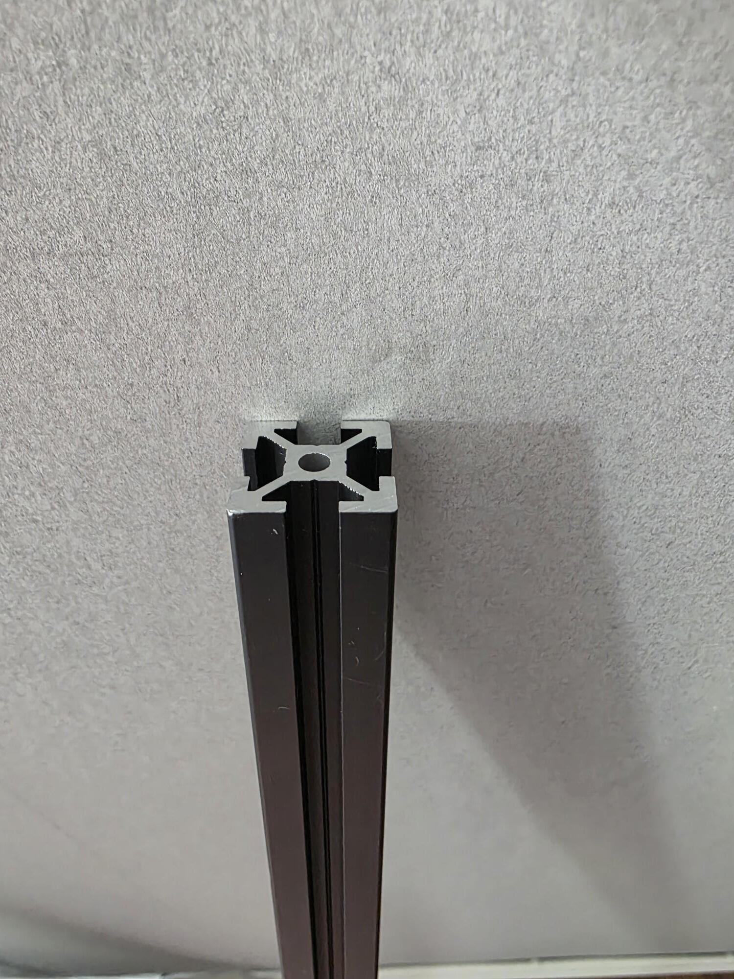

This is 2020 extrusion, not sure if it’s also is v-wheel extrusion?
