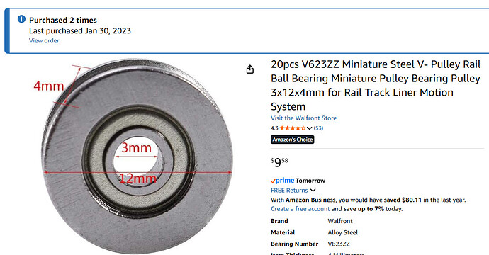

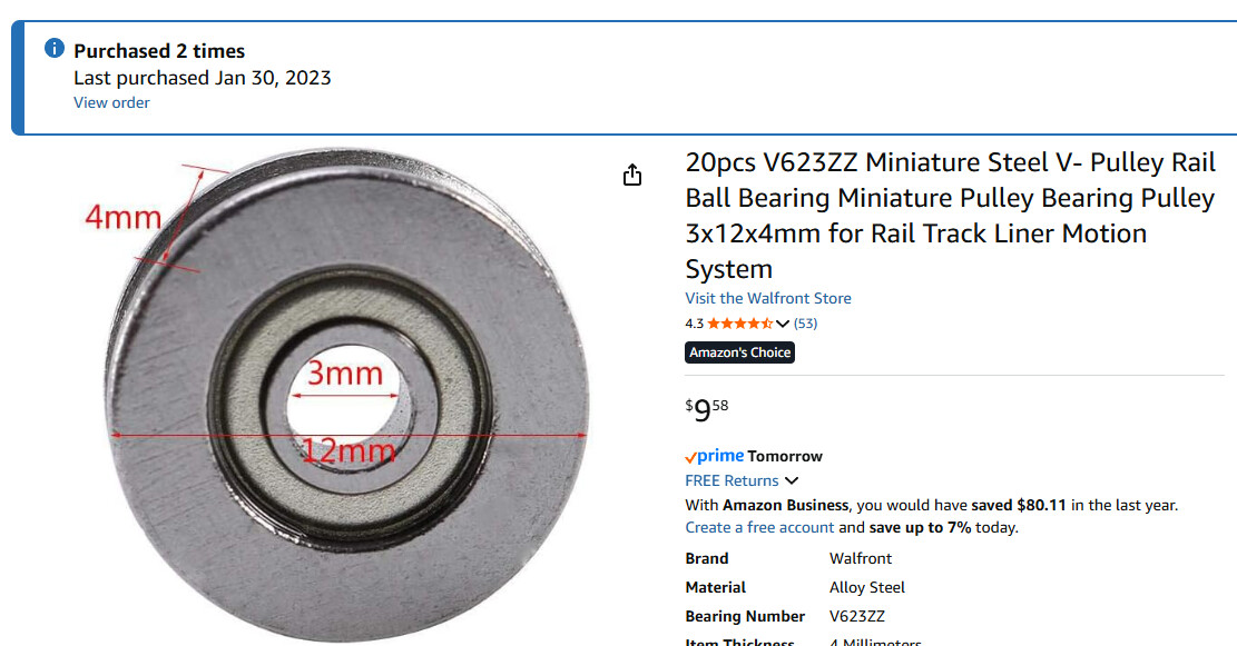

My concept was built around these (rather than designing based on some hypothetical part that doesn’t exist):
I was using these as both idlers and as rollers on custom rails. Using string instead of belts, and packing these at weird angles to reduce the impact of idler diameter even. Using string instead of belts, tight corners are no big deal.
It was quite the rabbit hole. Let me dig up what I have.
