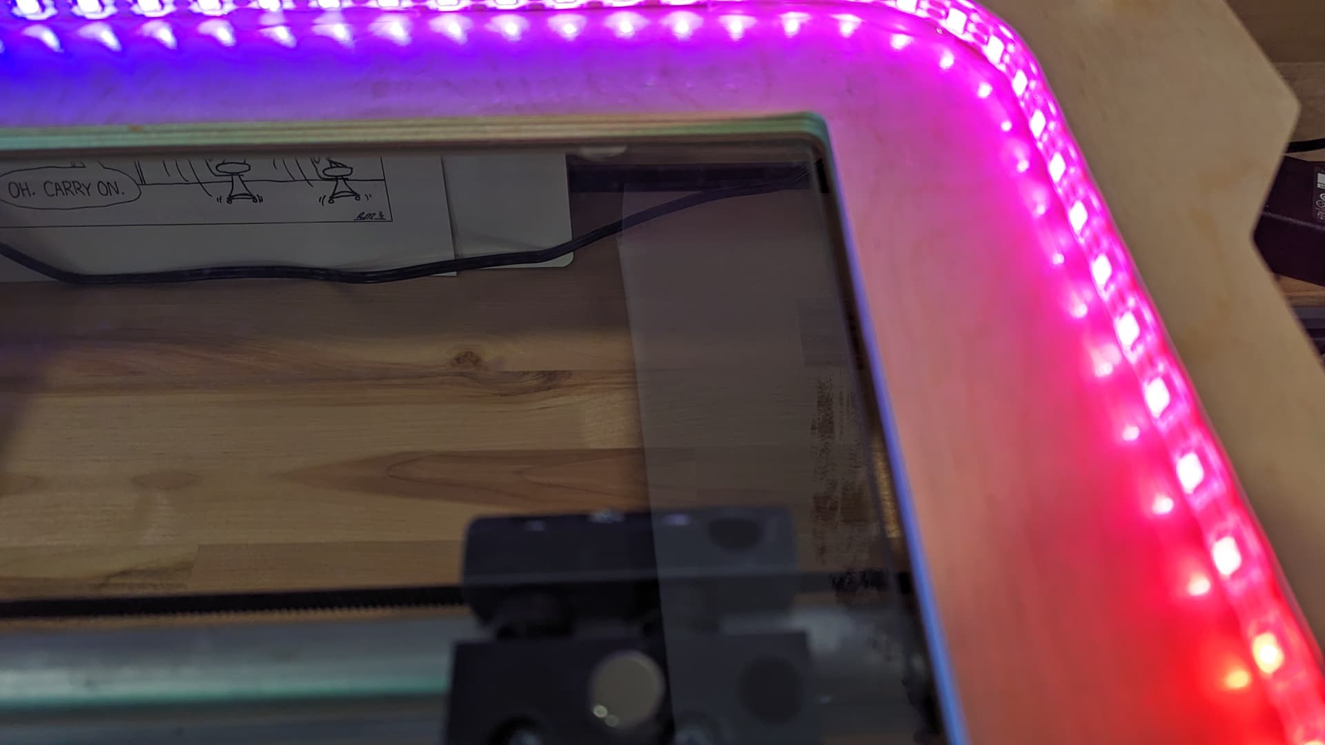

The WLED is also defaulting to the rainbow preset. So I should be able to just turn them both on and they will start impressing.

For this gap on the bottom edge: I am thinking just clear packing tape. Blue masking tape would work too, but it might be distracting. That gray piping didn’t work well last time.
The ball should roll over it pretty well, might see a ghost edge, I kinda doubt it though. Worst case cover the whole thing with a tape layer so there are no edges to roll over.
