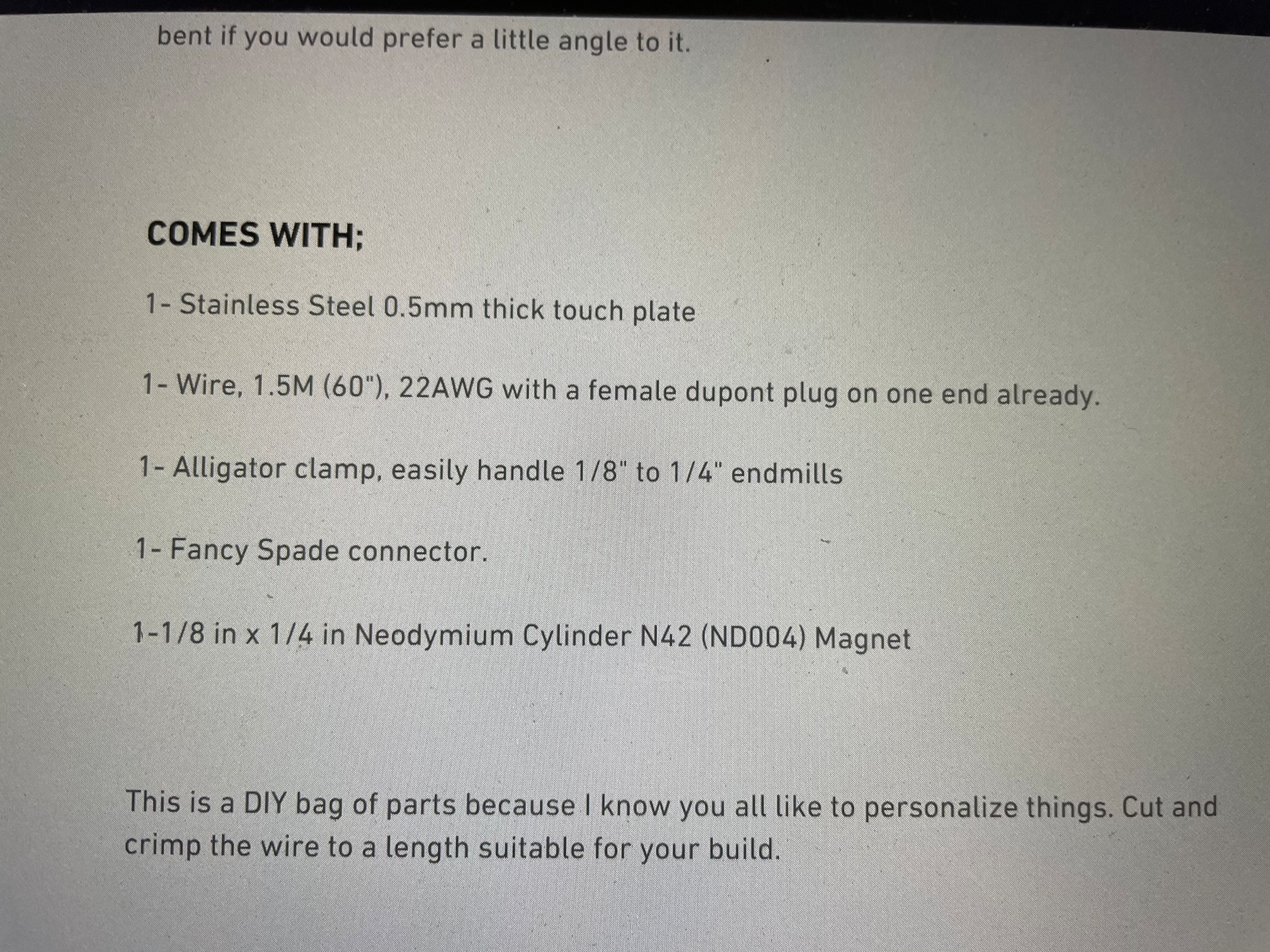

What I’ve found so far are the notes in the store page which make assumptions they are all the directions needed. The photos there reference a different rev of the kit and one that is assembled.

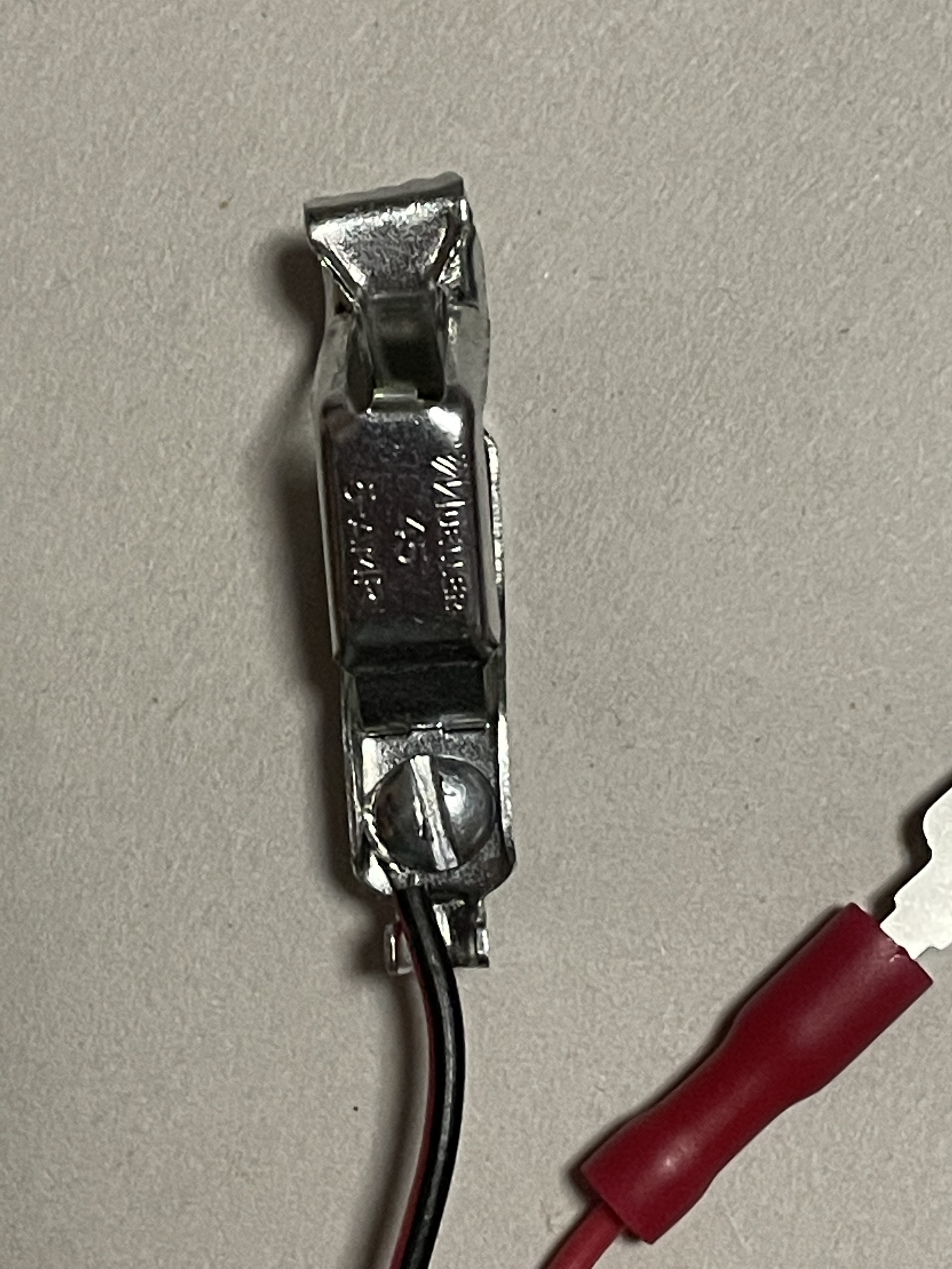

My kit came with a black/red wire pair. I’ve assumed the intent is to screw the black wire on the alligator clip and maybe(?) crimp together the end using pliers after tightening the screw?

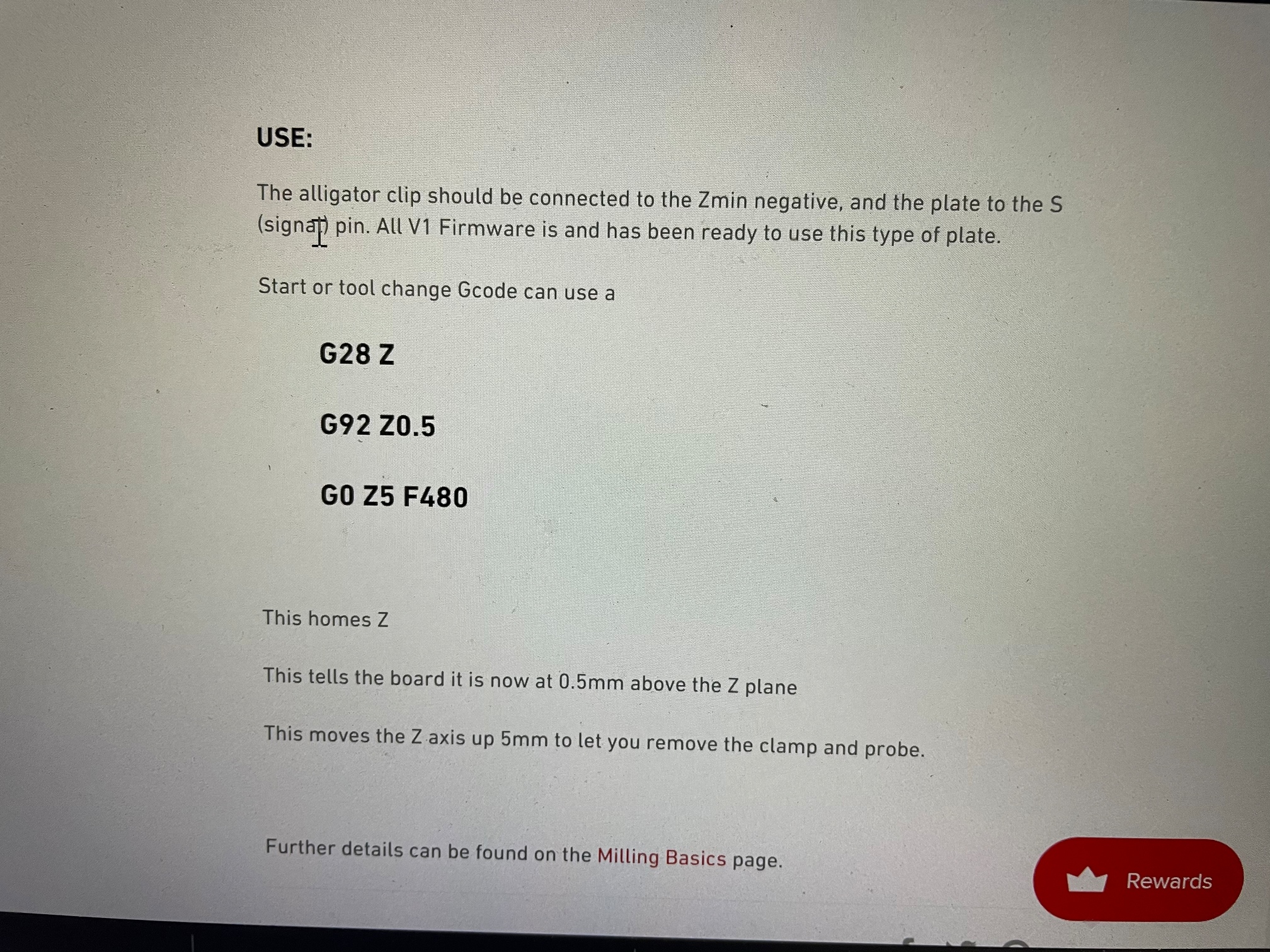

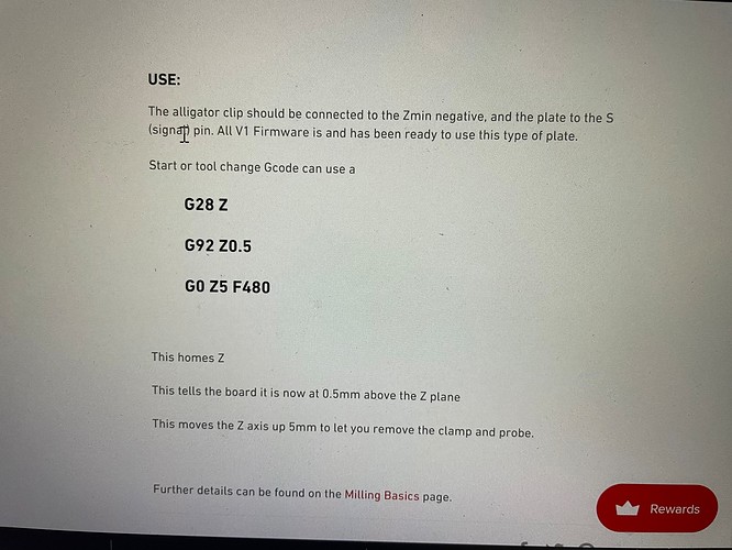

I’m using the Rambo board and understand how to connect there across the Zmin pins: red to S and black to -.
I’ve done that and confirmed it works when testing with the z119 command… and I’ve used it successfully. It’s just my assembly of the kit is anything but solid right now.

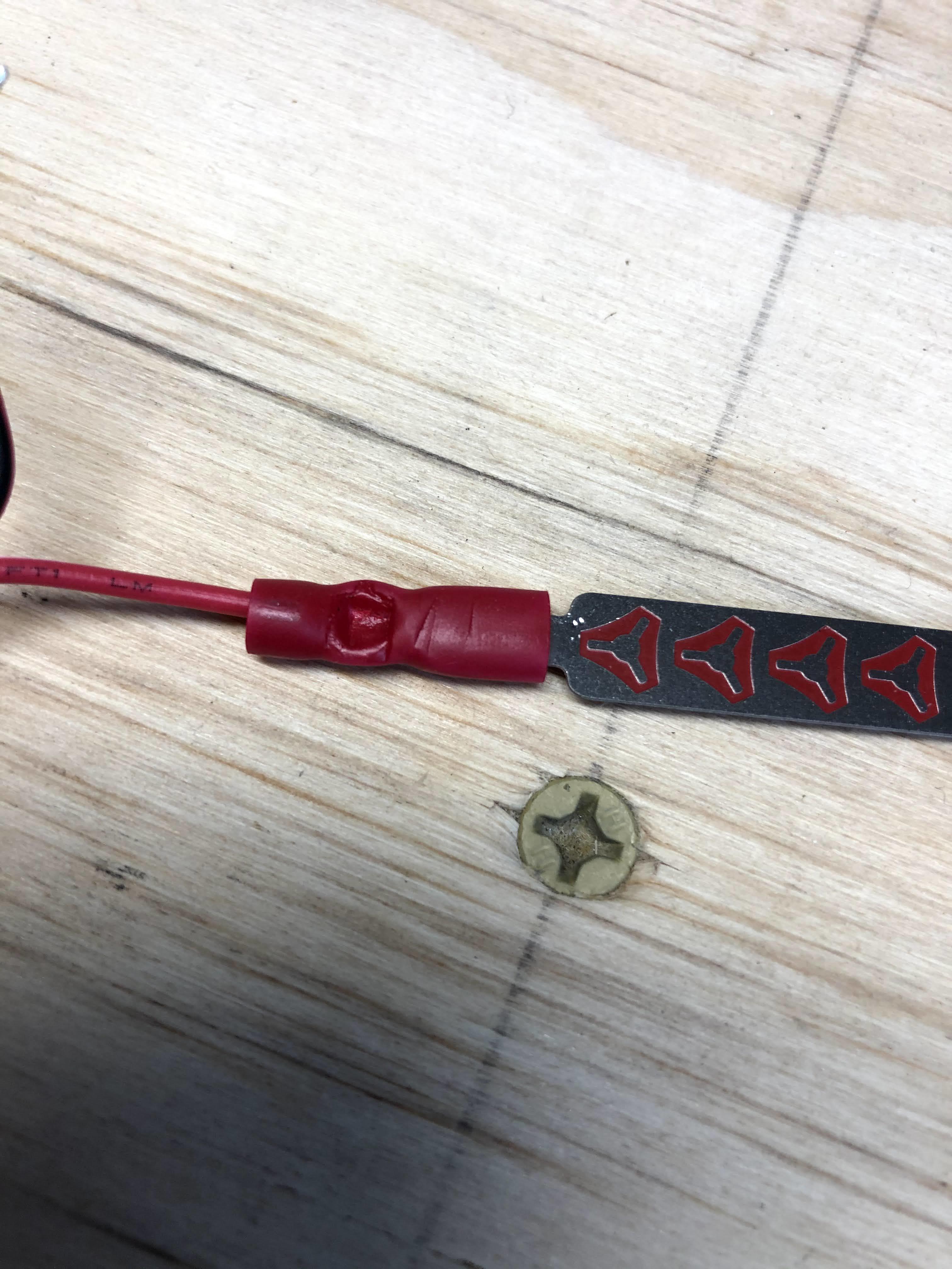

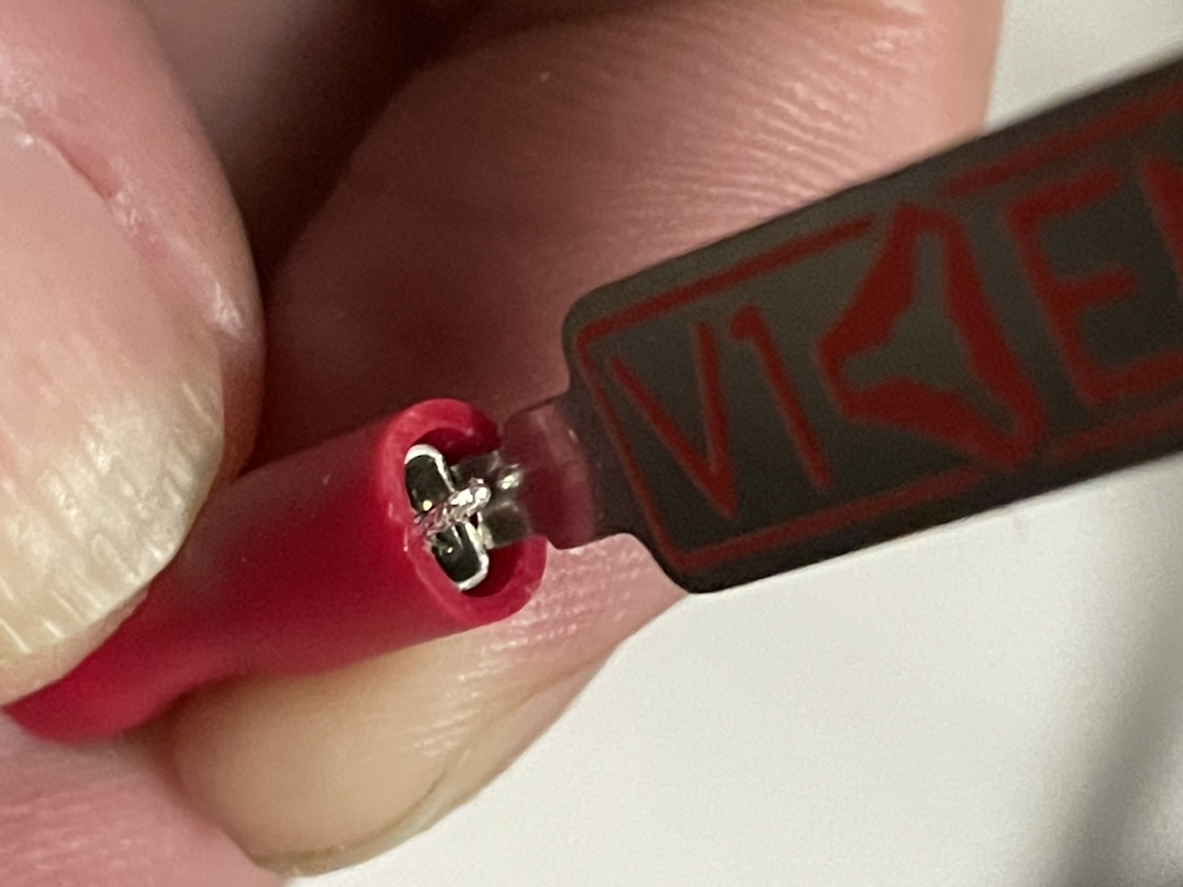

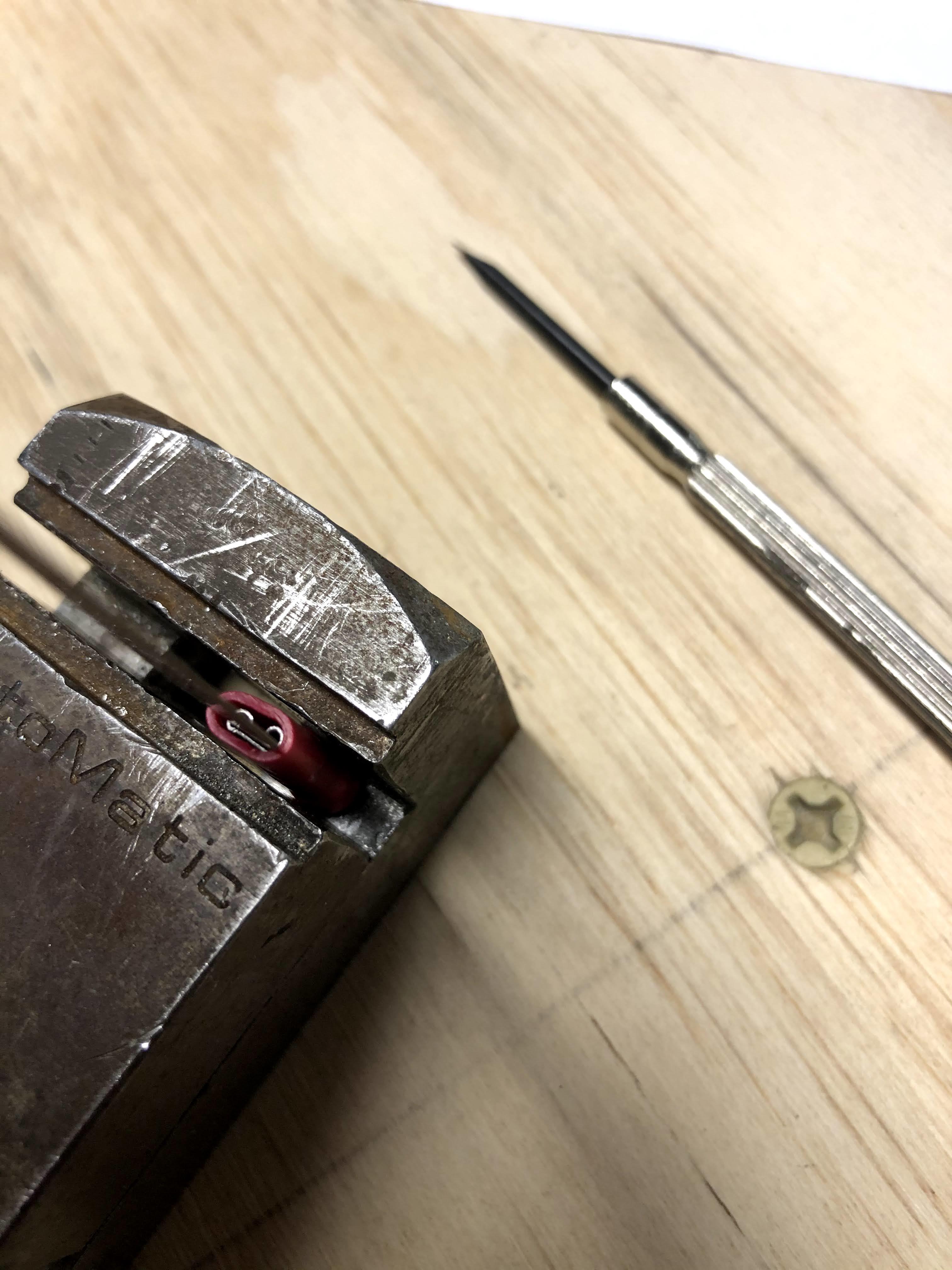

It doesn’t look like you have the red wire crimped into the spade connector. It’s not just shoved down the side as it appears you have it… The end of the plate is slid into the spade connector.
I’ll go take a few pictures and post again in a few minutes.

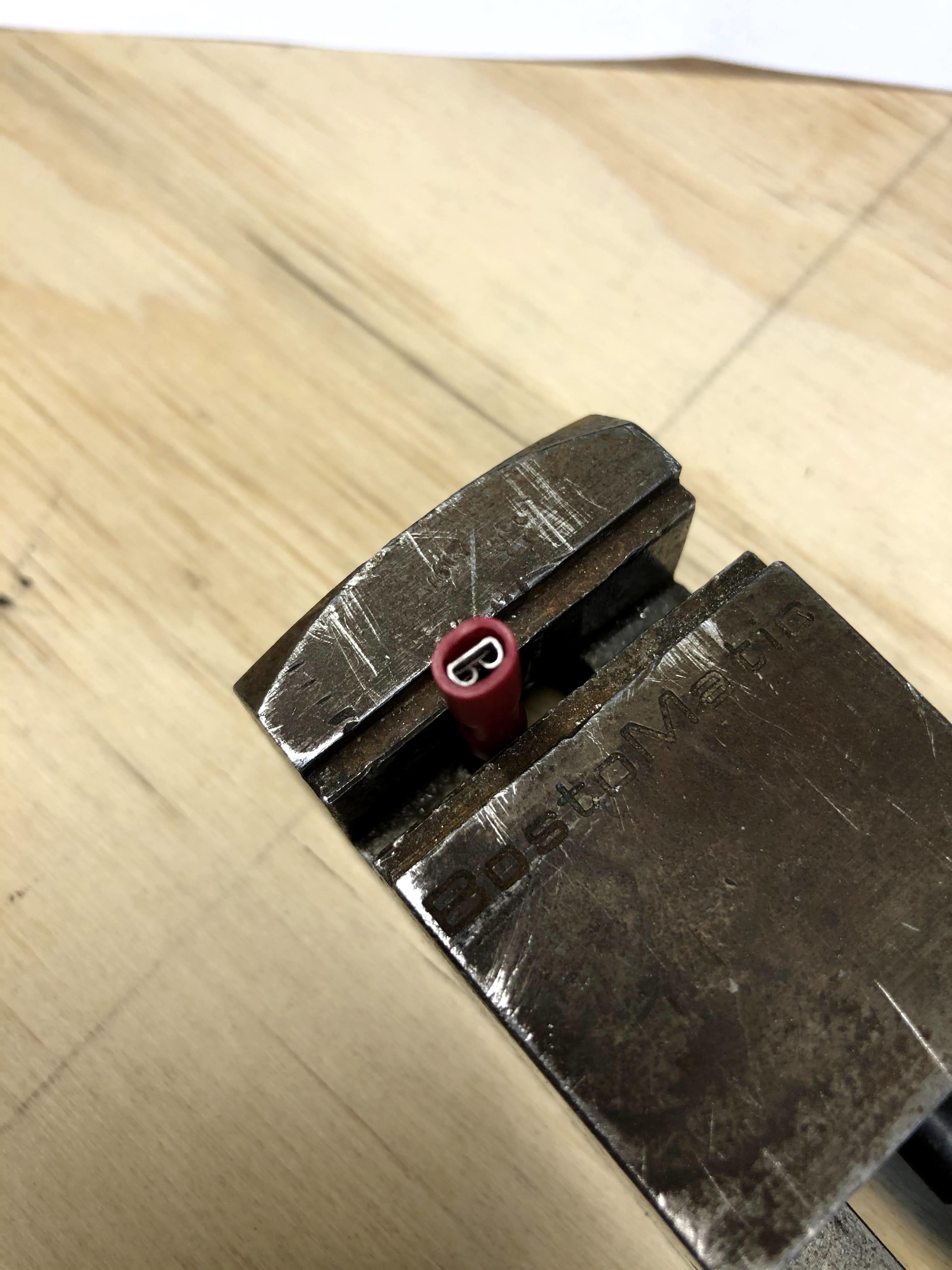

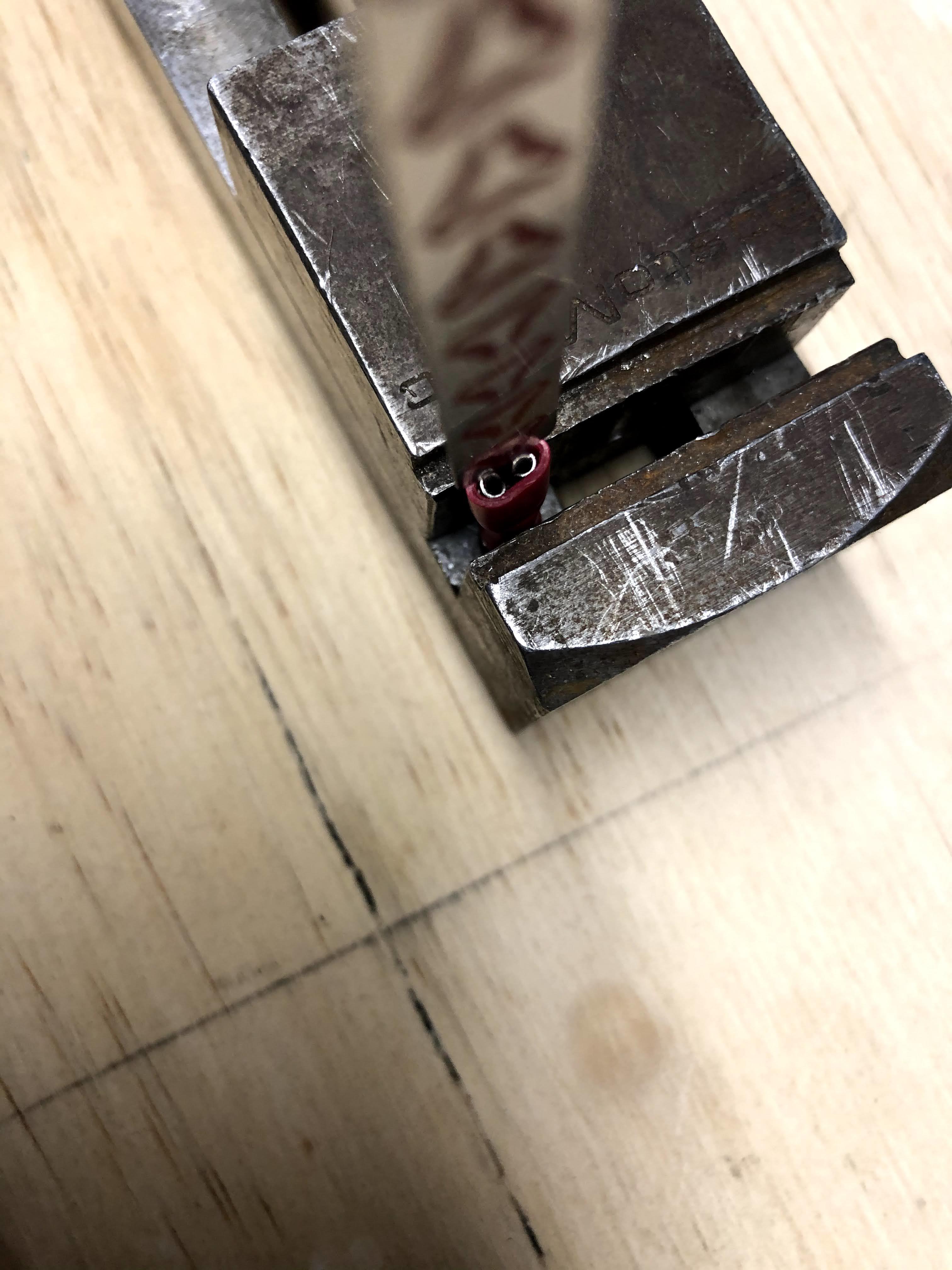

This is the “spade” end of the connector. The narrow end of the Z-Plate should be inserted between the curled over edges and the flat. In my kit that was next to impossible, so I used a small flat-blade screwdriver to pry the curled edges open from the flat portion. The stainless steel then slid in up to where the tab becomes wider.

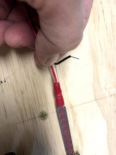

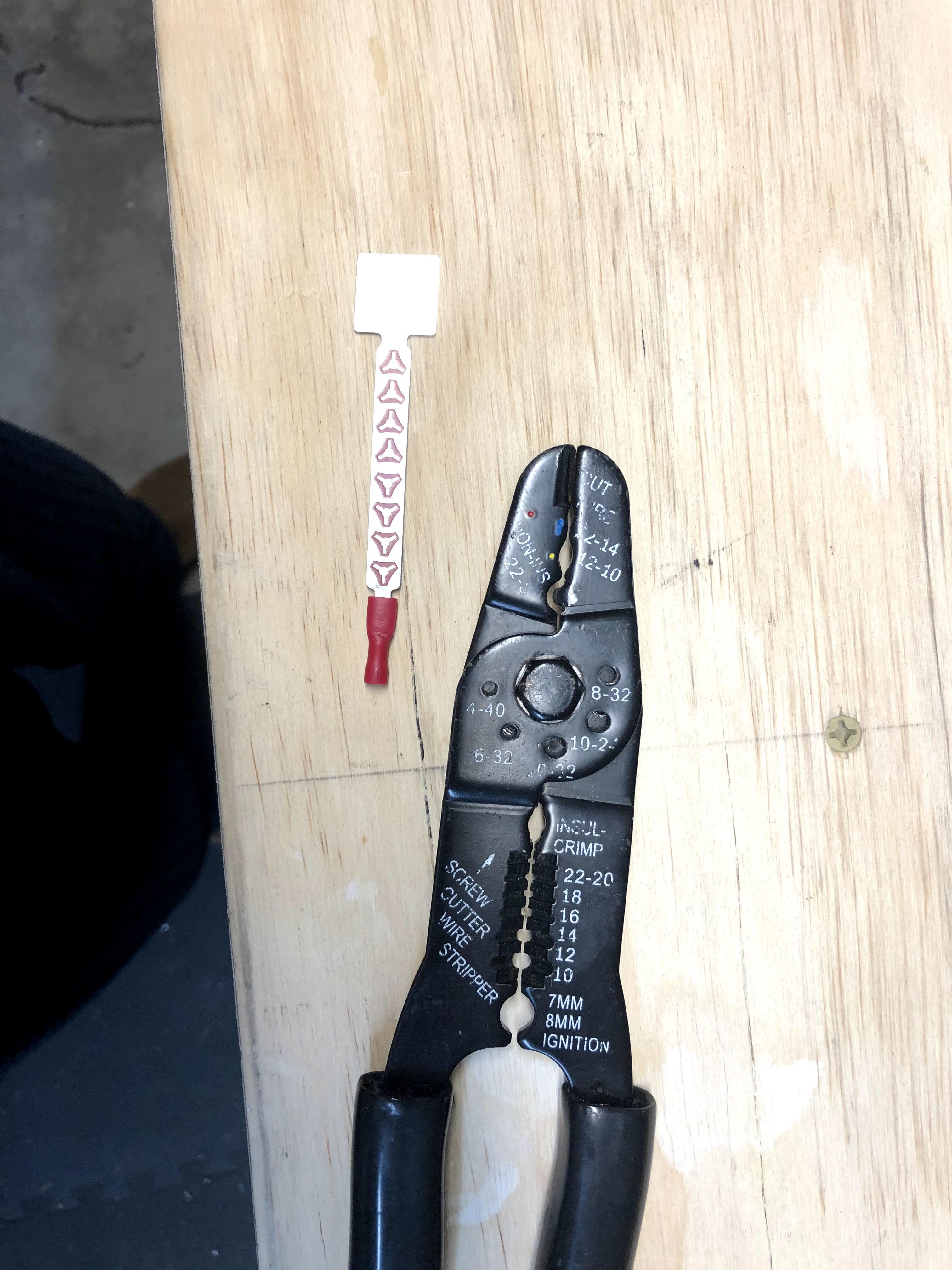

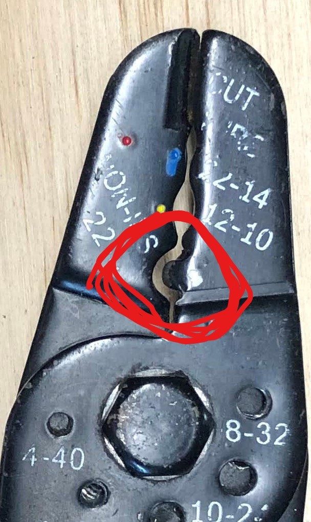

This is a picture of the spade connector and a set of crimping pliers. You really need to use a pair that are designed for crimping these connectors. Don’t try to use a pair of needle-nose pliers, or heaven forbid, a pair of wire cutters to make the crimp (I speak from sad experience).
If you don’t have a set of crimping pier, go to the local auto parts to get a cheap set. Be sure it has the dimpler (second crimp). Not all of them do and it helps make a very secure crimp.

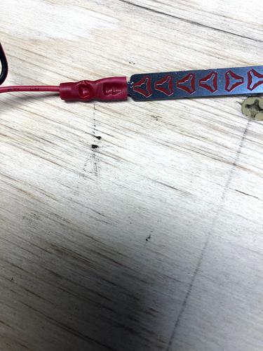

Mystery of the connector I’ve never used and tool I didn’t know existed solved… my wire strippers didn’t have the dimple capability but I got a pair that does now.
My z plate is now assembled securely and doesn’t feel like it’ll fall apart each use.
