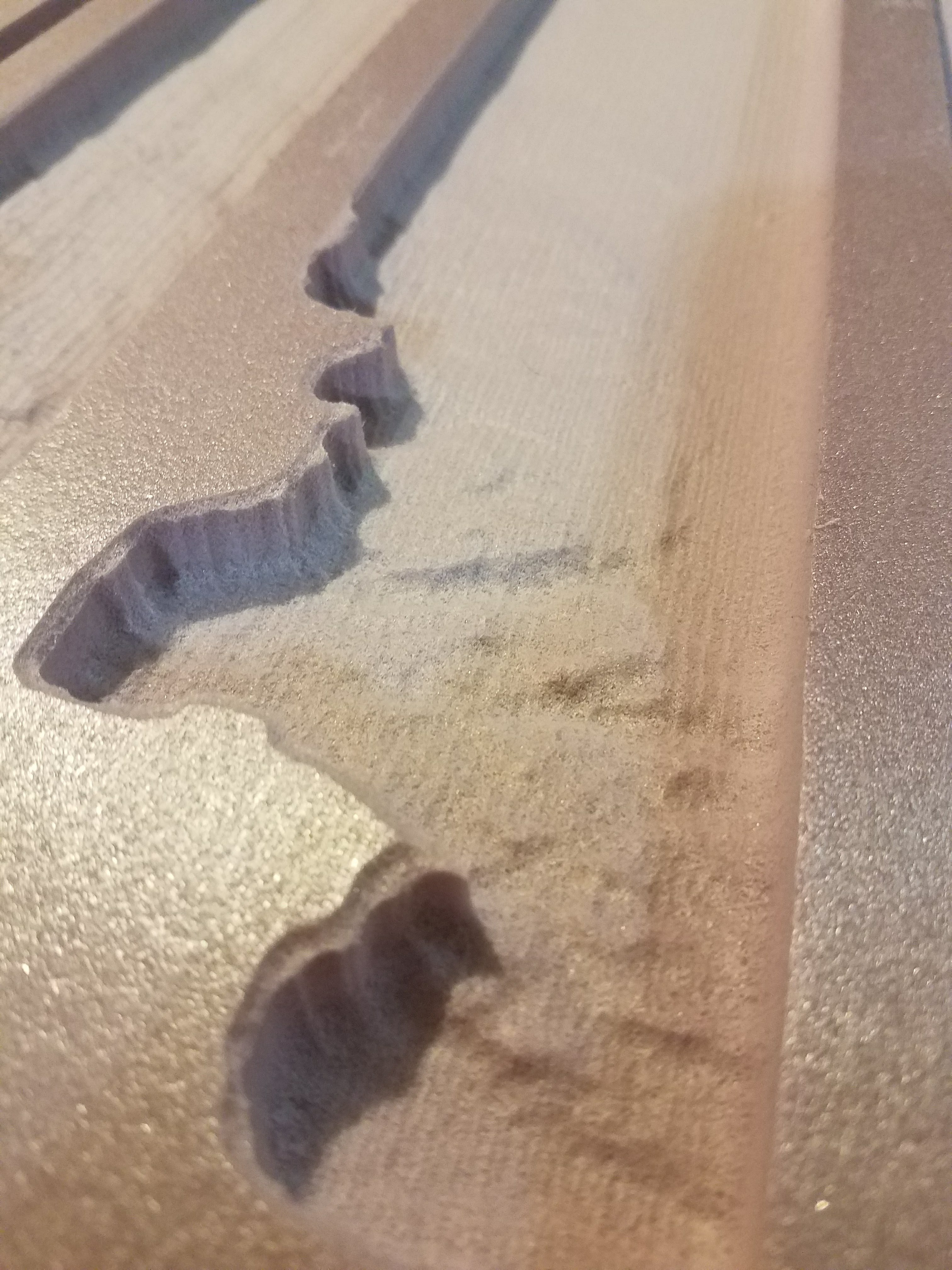

I am halfway through carving a large (6’x4’) topographical map of the Great Lakes out of rigid foam insulation for an ecology class at my school. (I’m the librarian.)
The map is divided into 2’x2’ sections to fit inside my machine, and I’ve been able to cut three sections nicely:
[attachment file=51109]
[attachment file=51108]
However, the last few attempts have severe z-height issues:
[attachment file=51110]
There is a gradual slope bedward with each new cut, highlighted when the machine skips and later returns to a section.

Depending on your Z axis screw the max rapid would be 8.4mm/s 5/16" or 30mm/s for a T8. What did you set them to? Plunge rate? Look at your gcode it should ideally have a “F” command on every line, you can dive by 60 to get the mm/s. It probably doesn’t have them every line thinking G0 or G1 will set it, it will not.

That post processor is not good, it is missing the first Z speed command, that generally crashes the board before it even start cutting and yup it should have some more F commands in there. It does not need to have them on every line. It will use the last F command given, so technically you do not have to repeat them. The max rates set by the firmware are notoriously finicky and not always obeyed.
I have no experience with that software or PP but it needs some work from what you have shown me.
If all commands are on one line with a speed it moves to the next point and divides the speeds evenly to obey the firmware max not moving any axis faster than it’s given max but making the full motion in one even shot, Should is the key here.
You can try my beta Marlin 2.0 firmware on github (linked on the firmware page), the limits might have been fixed in the firmware. They originally worked, then we lost them for many many versions. Hopefully with 2.0 they have been fixed. I need to get the rest of the printer stuff out before I dive into the firmware again to do testing. The Estlcam and fusion PP work perfectly though.

I think the real issue is Marlin’s limitation. I didn’t realize that it defaults to the lowest DEFAULT_MAX_ACCELERATION of the three axes on any given move. Looking over previous gcode, I had been unknowingly running it at 1080 (18 mm/s), way over what the machine can handle on the z axis, but fine for x & y. Since this project has a z height change at nearly every step, the ultimate solution might be that I leave the thing running for two days to make the cut.
Am I seeing this correctly? If I pick up an LCD screen I should be able to set some of these defaults from there with the EEPROM, right? Would that make the lack of F commands in the gcode less of an issue?
It defaults to the lowest axis max speed over the entire move, so Z generally only moves a tiny bit where XY moves a lot. When combined the Z might be the limiting factor but the XY are not limited to the Z speed.
For example from 0,0,0 to 100,100,1 Z will actually be moving much slower than its max, it will not move up fast and wait for the XY to catch up. It spreads its move equally over the entire diagonal distance. There is a name for this but I am drawing a blank.
The LCD will not change anything other than your old laptop issue. The post processor you are using is the problem. Marlin works but telling it to move super fast and relying on the firmware isn’t a good solution. You want to have full control of every aspect of it’s movements. Your standard gcode isn’t even correct. The issue we had in the past was lack of rapids predefined in the firmware, you also have that problem.
