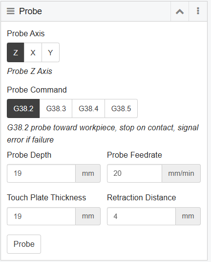

Z probe in CncJs moves the up rather then down
I have a 19mm thick Z probe plate and if I clip it to the bit and place the plate underneath I can use the “Z home” option from the Axes widget it ir probes correctly and retreacts the specified distance when it touches the probe.
But if I click “probe” from the probe widget, it just moves the Z axis up about 5mm and stops.
Any idea what could be wrong?

The g-code is as follows:
; Z-Probe
G91
G38.2 Z-19 F20
G90
; Set the active WCS Z0
G10 L20 P1 Z19
; Retract from the touch plate
G91
G0 Z4
G90
I am using a ramps 1.4 with the dual end-stop Marlin firmware.

Your feed rate for probing is 20mm/min. That would be imperceptibly slow movement. I’m guessing that you specified mm/s, and Marlin uses mm/min.

I see. The command is actually in mm/min, but 20mm/min is ridiculously slow. Try 200. You’ll also have to change the probe thickness to the actual thickness of your probe (the Tiny Touch Plate from V1 is 0.5mm). Also try using a probe depth of 0 (depending on what value you set as the initial homing location).
G90 is Absolute, and G91 is Relative. It looks like your widget changes between these states automatically (it inserts the commands into the g-code). You can live with it, or edit your g-code after it is produced, or do the probing manually (enter the commands from a command line).

Looking a little closer at this, it seems that the G38.2 (Probe target) and G10 (Set offset) gcodes are not recognised by the Marlin build I am using - 2.0.9.2-513.
I wonder why these command would not be enabled?
Have you looked at your Configuration.h and Adv_Configuration.h files?
And have you tried these commands from a command line, or just from your GUI?
cncjs has an integrated command line and sure enough the commands come back as not recognised.
The G38 commands are disabled in configuration.h - but I am wondering why?
Probably because they were never enabled.
If you aren’t using a Marlin version directly from the V1E repository, you pretty much need to go through the two configuration files line by line and enable or disable features and functions that you want (or don’t want) to use. That includes defining what type of probe you have.
If you did get the firmware from V1E, then I have no idea why it isn’t enabled. The current version in the repository is 2.1.1 (at least that is in the filename), and you say you are using 2.0.9.2.
