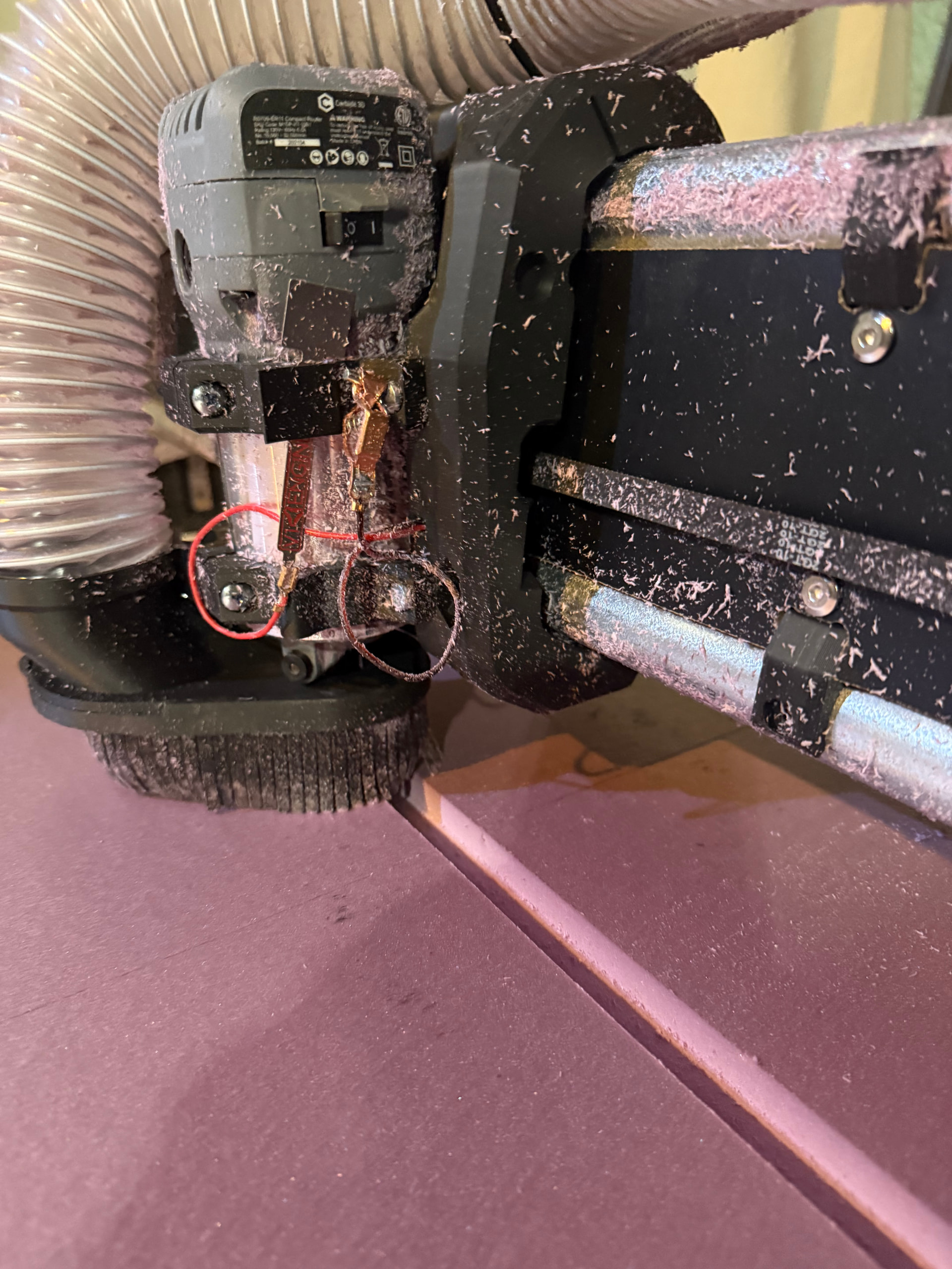

Sorry I’m just getting back here; had a productive weekend of cutting by manually probing! Running a bone stock LR4 setup with a Jackpot3 from the V1E shop, only mods have been to parameters for pulloffs (upped motor amps after some Z and X droop but that was after both pins fried). I had successfully used the touchplate for probably a dozen cuts to make my strut plates (MDF) and some lighter duty engraving.

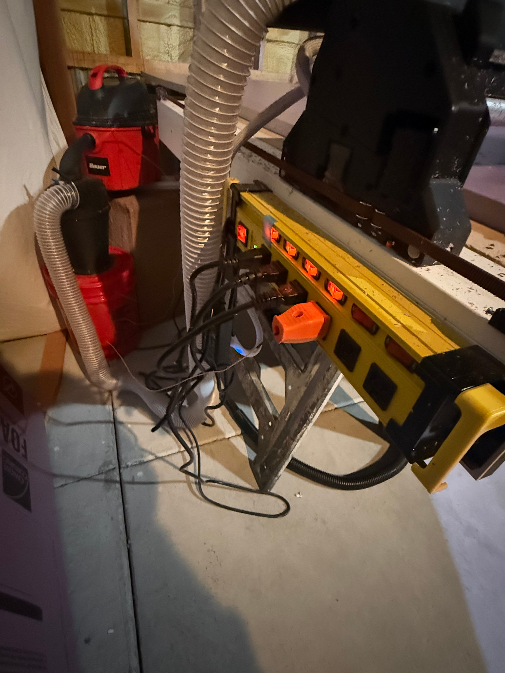

My problems started occurring when I began performing large format cuts in XPS foam, where similar to Bruce my Z probe sensor triggered mid-cut in the WebUI, without any touch from myself leading up to the event. My suspicion is that while my dust collection system is fully grounded from hose to vacuum, my router isn’t, which might be facilitating a large static discharge event between the magnet and touchplate mid-cut, despite them having space apart at all times. Nothing super noticeable happened during the cuts, with a moderate level of foam chips escaping the dust skirt that couldn’t get suctioned. I think this is plausible since the fried pins in question tied back to the Z probe both times.
One thing I know for sure is that both GPIOs are likely fried, since they’re stuck in the triggered position even without the probe attached and after multiple power cycles/config resets. Any advice on how to remediate without purchasing a brand new board would be helpful, as well as how I can potentially avoid this!

@vicious1 - maybe this is a scenario where we need a ‘dock’ for the probe that does ESD mitigation, might also be a good time to consider recommending the probe wiring be inside a shield braid that is independently tied back to AC ground to avoid the ESD charge accumulation on our IO lines.
Foam is THE ESD nightmare for these machines.
Never had this problem with the Jackpot1 and I ran a lot more jobs on foam, MDF, plywood, and hardwood. Same router and probe placement on the core.
As far as I recall the circuit is the same on V1 and V3 for inputs.
Are there any other changes made when you did the swap?
Would keeping them connected be more safe. The static will head to ground instead of the gpio?
Bouncing the ground rail with ESD isn’t a better option. That’s why a shield overbraid that is independently tied to ground may be helpful.
It might also be good to tie the IO and it’s return with something like a 1K resistor when stowed (if it doesn’t mess up FluidNC in operations post-probe)
The only change was making the x and y longer. All the same electronics except the Jackpot.
Do you happen to have before/after pictures of the X? The longer the run of cable through a highly charged environment, the more likely charge accumulation on that wire is.
I made the x and y longer while using the Jackpot1 controller. After running several jobs with that board at the new size I switched to the Jackpot3. Less time on the JP3 than the JP1 with no change between the two controllers.
