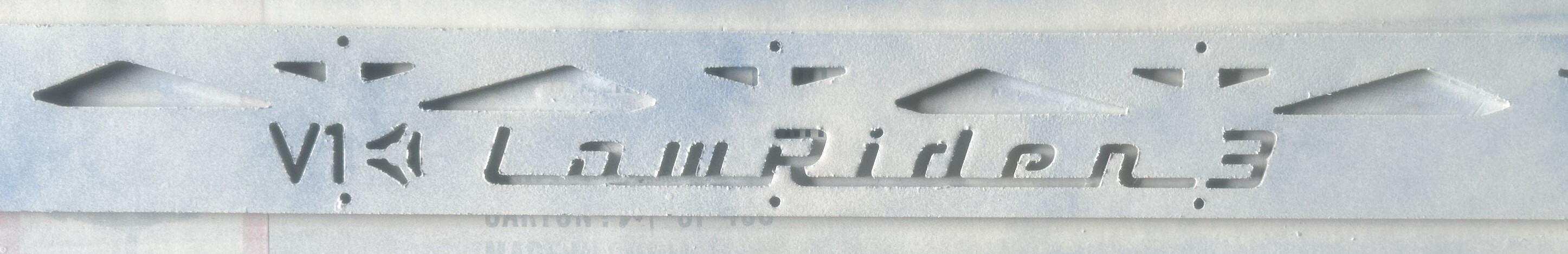

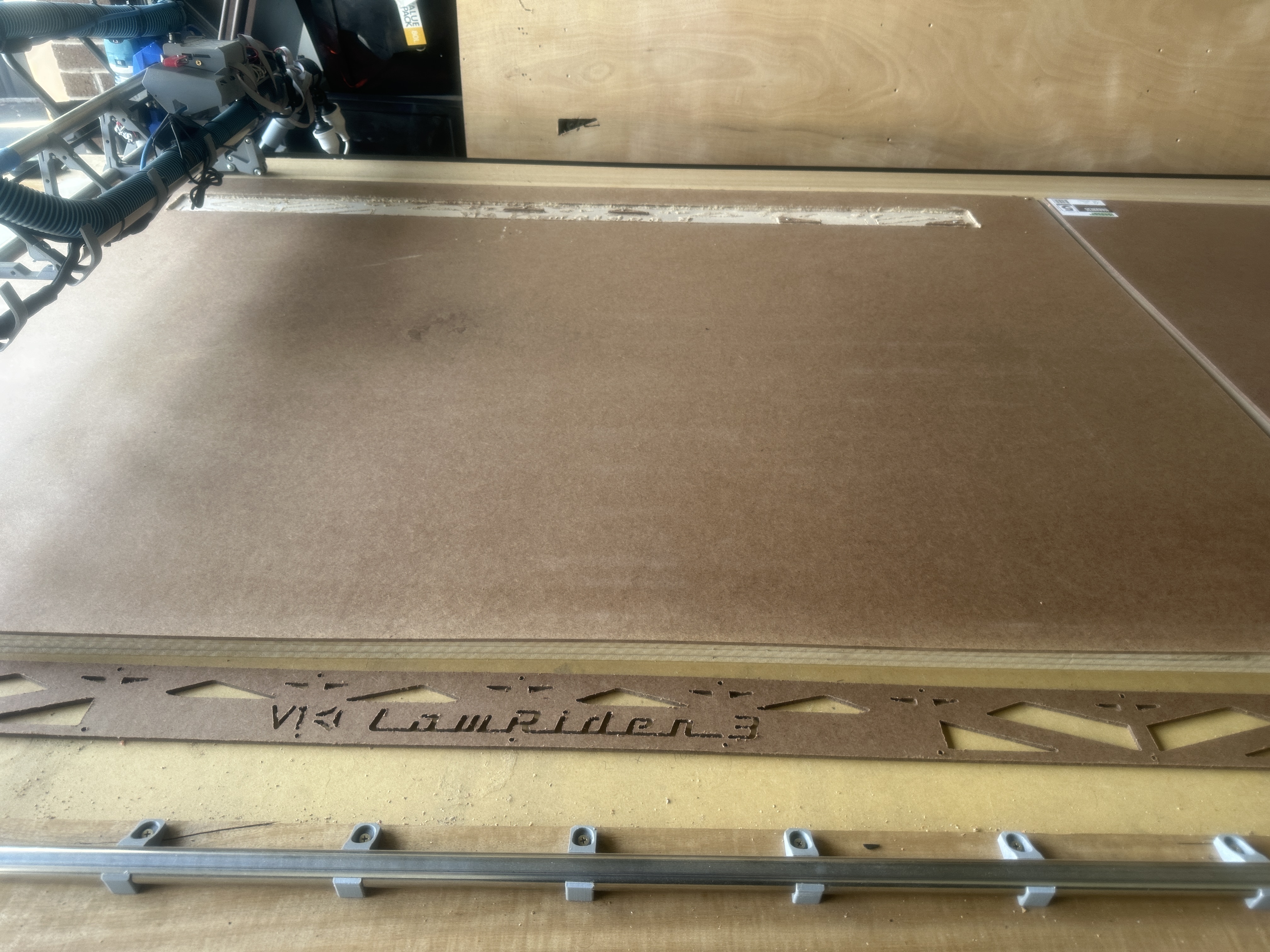

Success!
1x strut complete using upcut.
Just need to clean it up a bit.
Now to start the other 2x struts, this time with 2flute down cut at 10mm/s, 3mm/s plunge. :slight_smile:
NICE!
Next time you get some endmills grab a single flute upcut. MDF doesn’t splinter. Then a 20mm/s cut in that with a 0.4mm finishing pass should leave a near perfect edge, much faster.
That was a single flute upcut, at 8mm/s, 3mms plunge, pass depth of 1mm.
I didn’t do a finishing pass however. That material is Masonite.
It did whistle while it was working, so maybe the slow travel speeds or 17000rpm?
I’m going to do the next 2 struts with a 2F down cut just to have the surface a nicer finish based on your recommended settings of 10mms/3mms, and put the Makita to setting 1, which is approx 10000rpm.

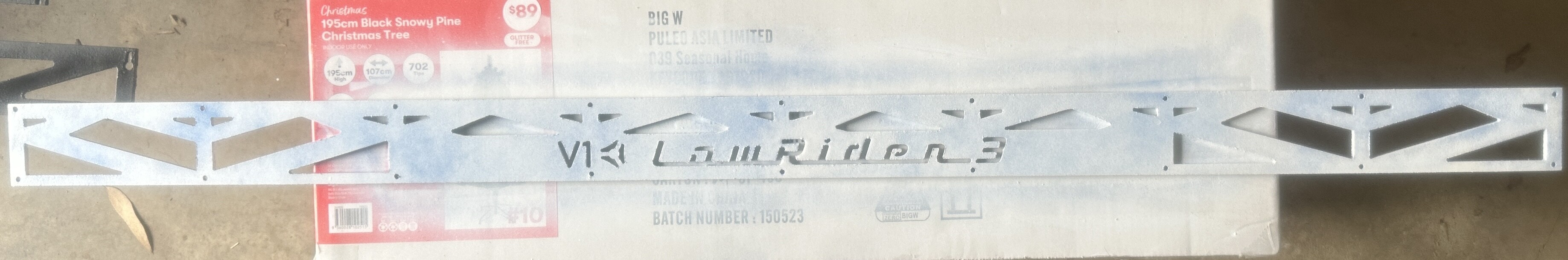

Ok so starting my cut,
At Makita 1 (10K rpm) I noticed it was a bit jumpy, as if it hit a knot in the Masonite. Raised the rpm 12K rpm(Makita 2), which did help, raised to now Makita 2 and a notch) approx 13k Rpm and that seems to have stopped the jumpness.
Is that the right way to go about it? Or is it telling me something else? Video below is after the rpm alteration.
https://wirepower-my.sharepoint.com/:v:/g/personal/frank_wirepower_com_au/EQGBWRYawWdCpsIYF17xXD8BWyD9xkMPAF8bU8G158JWUQ?e=CTUcDK
Bumped to 14.5K rpm (Makita 2.5). Seems to run even more smoother now.

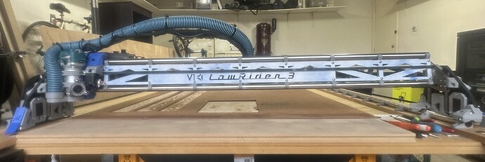

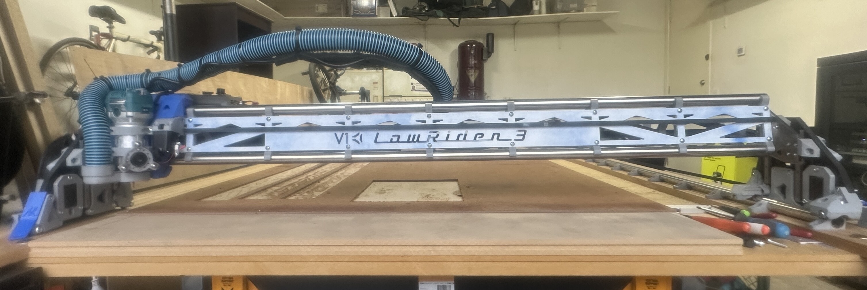

Prepped, painted… now waiting for it to dry.
PS. I’m no painter…… but thought I’d add a bit of Blue spray to break up the white.
Will look good once I have the led’s behind it :slight_smile:
She’s coming up nicely, just got the bottom strut, led lights and a complete redo of the controller left.
