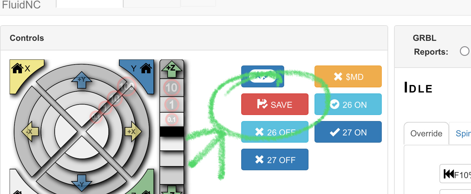

I have gone through the process several times, and it doesn’t seem to ‘stick’.
I suspect I’m missing a part of the process for the Macro portion of the proceedure.
I have entered the change, hit set, go back to the dashboard and hit the add macro button. When I restart, the setting is back to the default of ‘4’.
Any thoughts on what I’m missing here?
After you make the change use the red macro button marked ‘save’ this will write the settings to the configuration. If you don’t do this they will be lost after rebooting.
