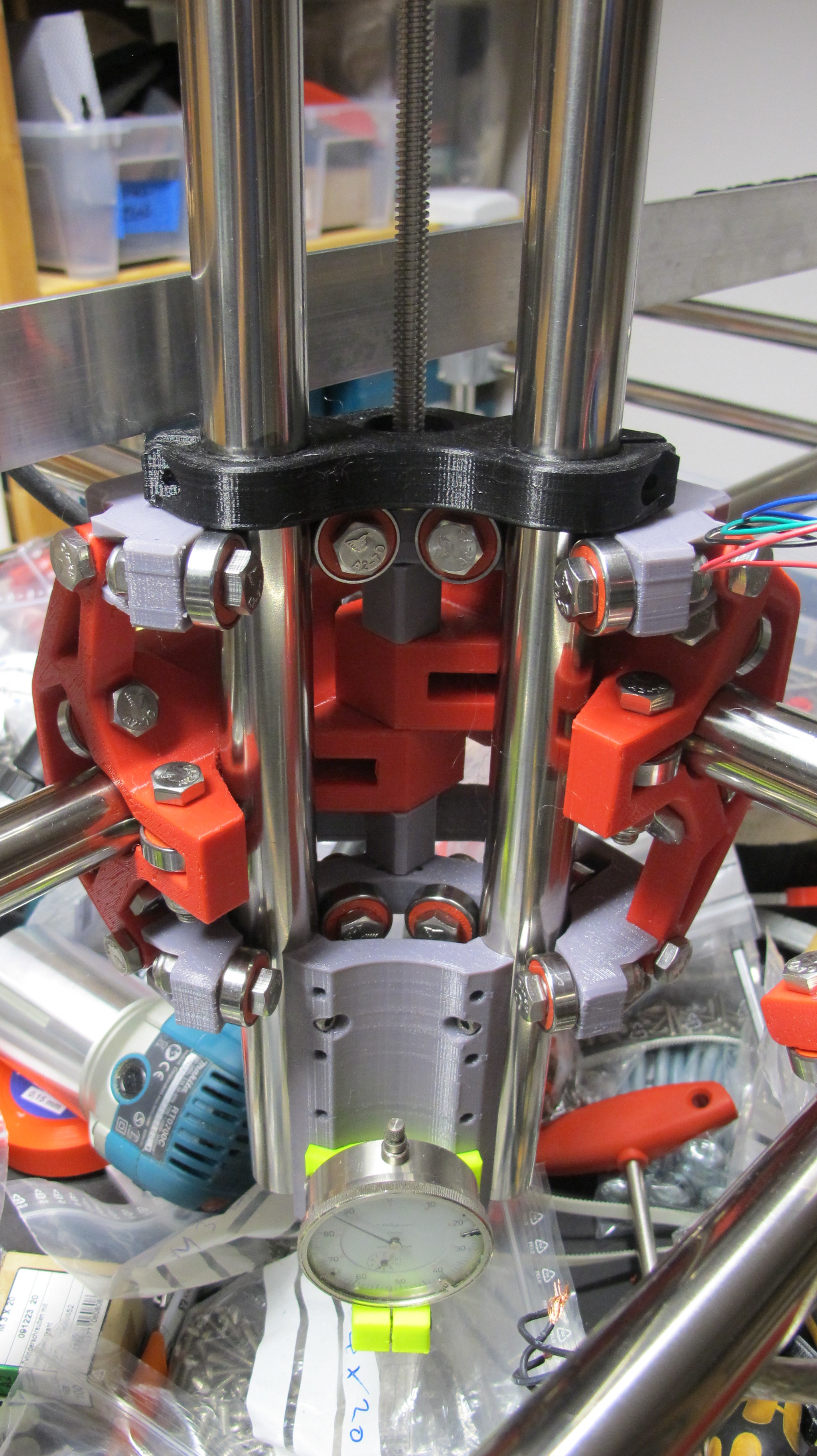

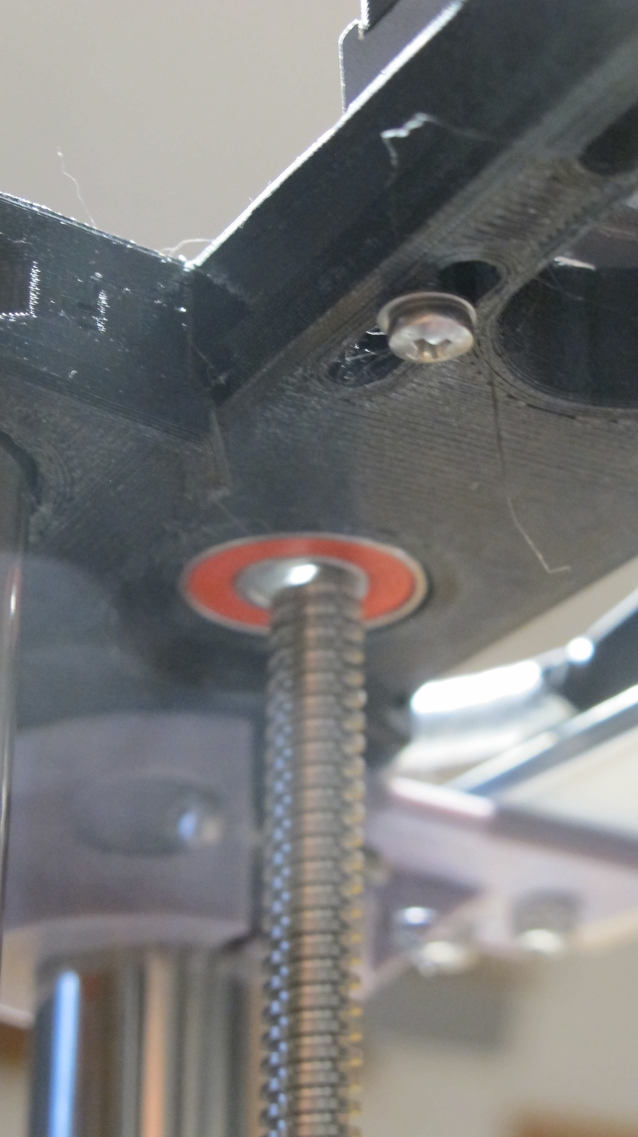

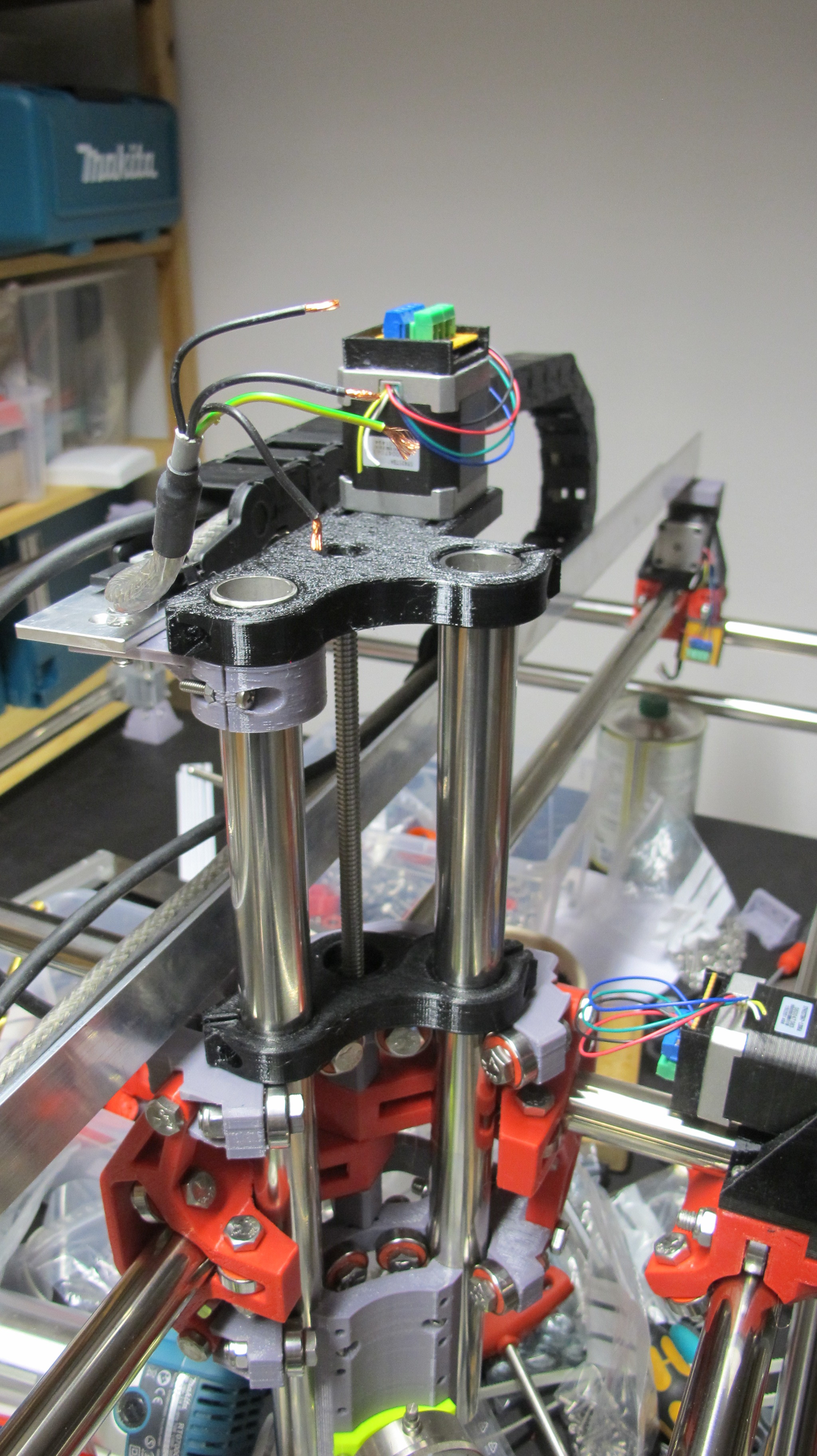

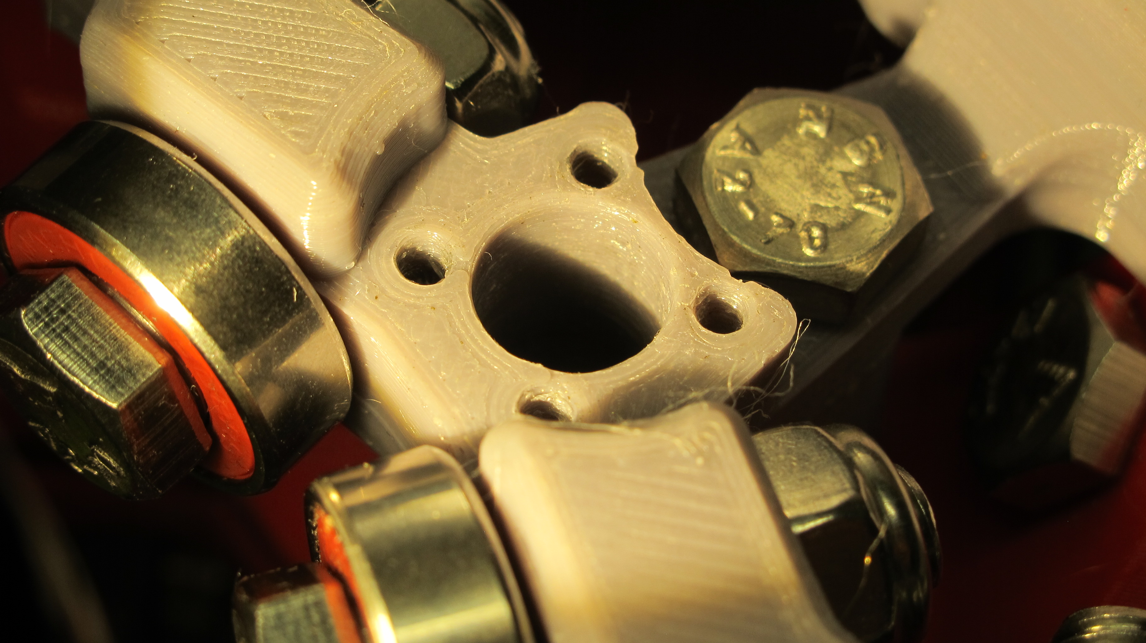

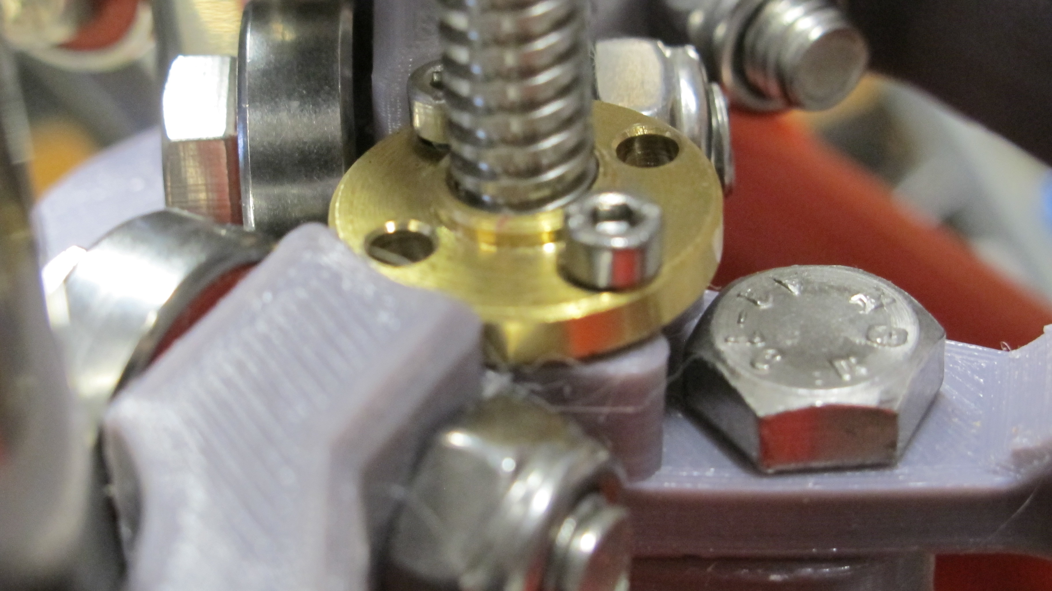

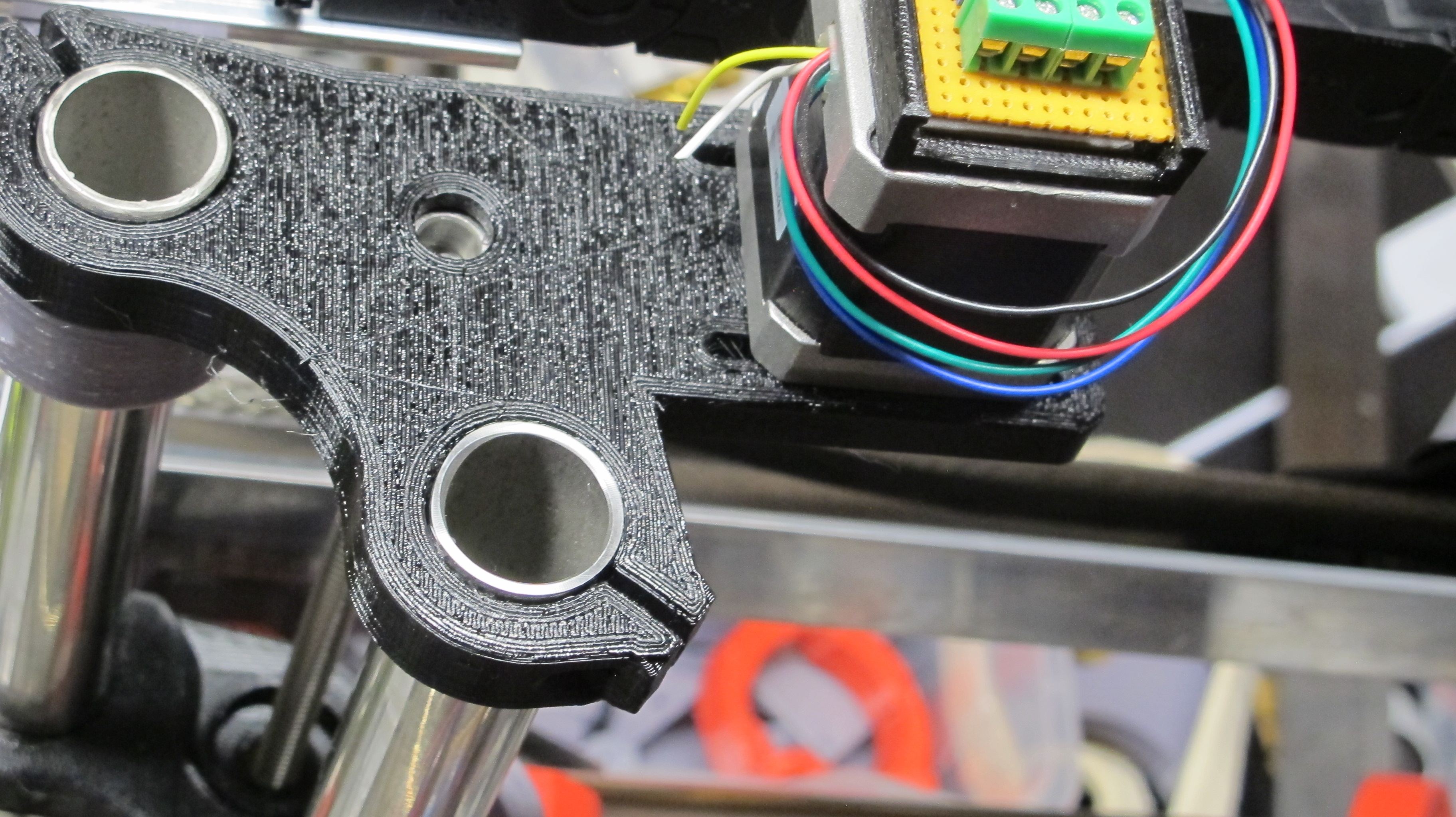

Sure. Was too late last night, but here are some views.
JFTR: The motor carrier is an add-on that was recently published first in a german fb-group, now also on thingiverse, https://www.thingiverse.com/thing:3995280?fbclid=IwAR2eK8lzJtmHILVtkiflsdhh-iEAh-Sv7XChA5PCbfhzpy24v-Y0gfa7R1Q,
see also https://www.facebook.com/groups/722641598074003/permalink/993798957624931/
But that is not the reason for the mismatch here.

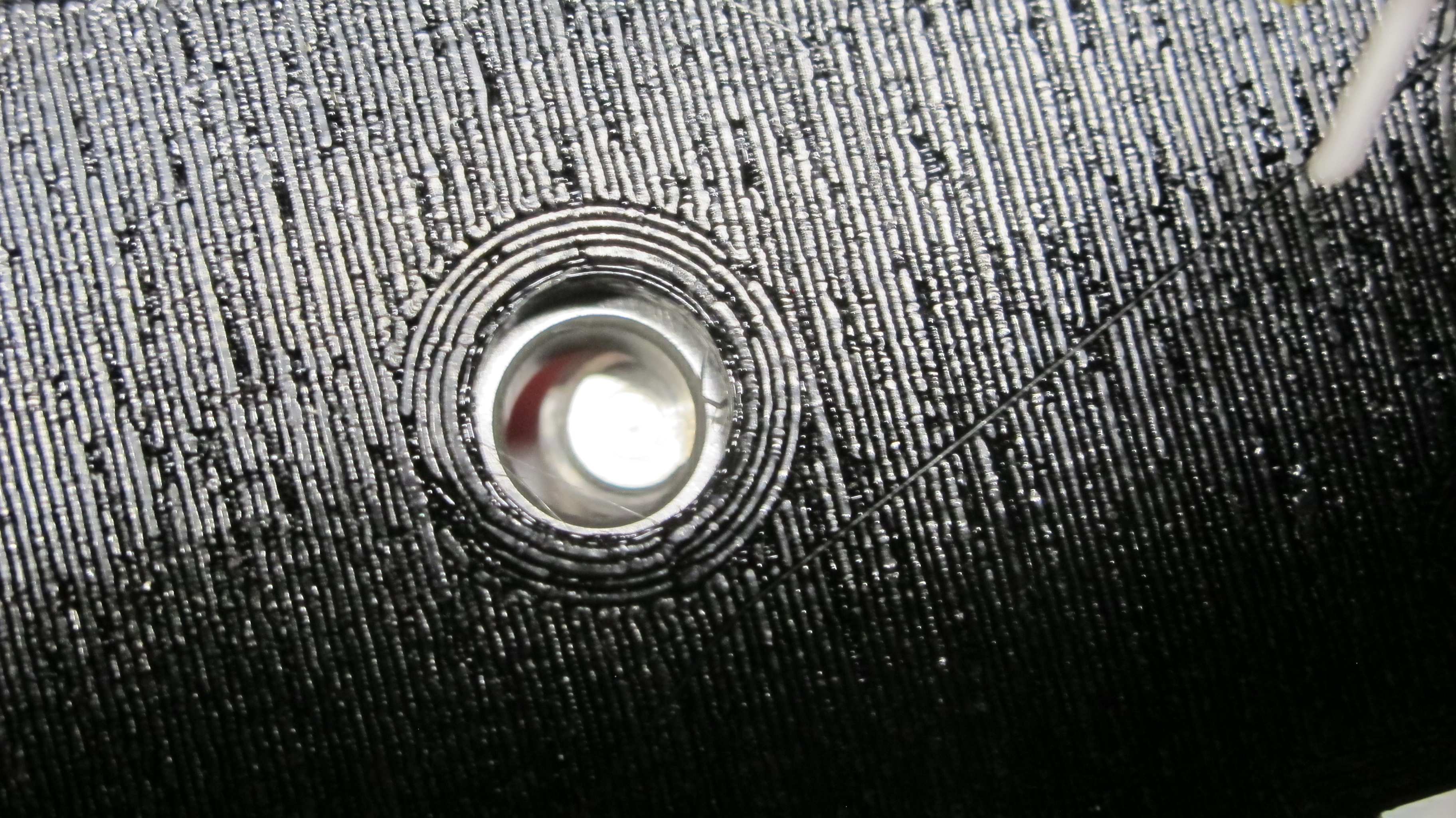

Sorry for the poor focus in the upski-, err, upspindle view.
Cheers,
Ulli
Not sure how that top piece is supposed to work, but you really don’t want the cable chain attached to the top of the z like that. It will cause issues down the road.
Okay, went and looked at the thingiverse page.
One, it looks like your z is waaay too tall. That’s a lot of stuff sticking out above the bottom black piece. Two, there should be a bearing in that black piece, and three it looks like your bearing in the top black piece isn’t centered. Your top down shot shows this.
The “black piece” is there just to keep the tube array up. Its regular place is just below the coupler/timing belt gear. When moved completely down, there are just a few centimeters of tube left. Of course, there wiill be a bearing in the lower black part. Right now it isn’t to show the misalignment I have here. The bearing in the top part is in the right place, it is the lead spindle that is off axis.
That might just be the angle of the camera.

Re the centering of the top bearing again: The viewing angle is a bit odd in the from-the-top view, that’s why I added the view from below which shows it much better.
And: correcting the top part above the nut (of course less than “snugged down”) is less important here than the invisible part in the gantry array. Ideally, the leadscrew should run up and down without any deviation from the ideal axis through the nut’s thread.

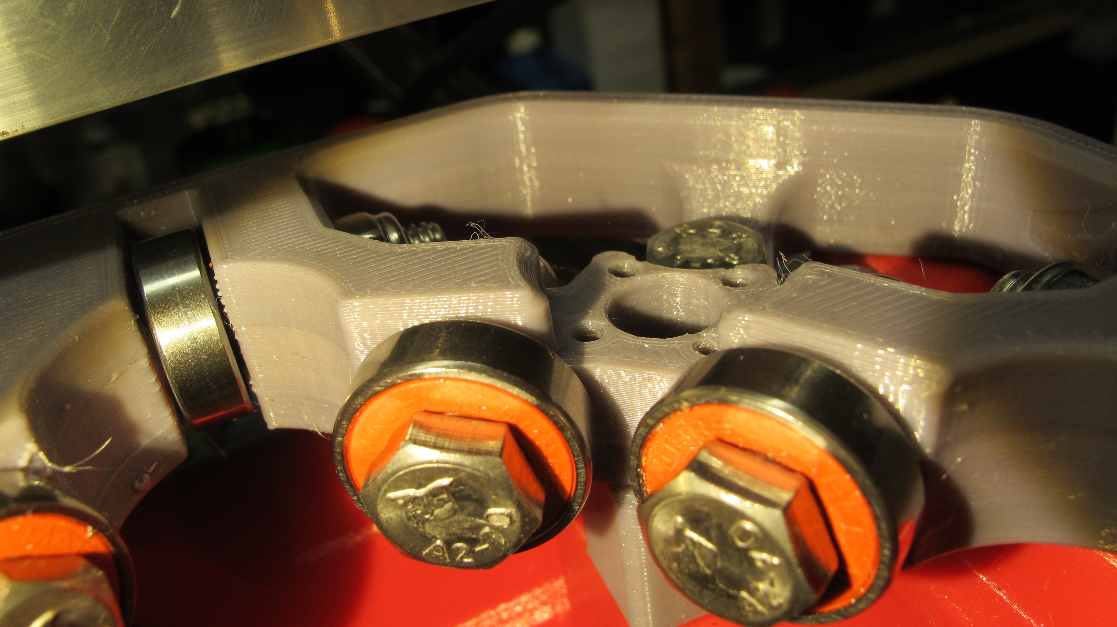

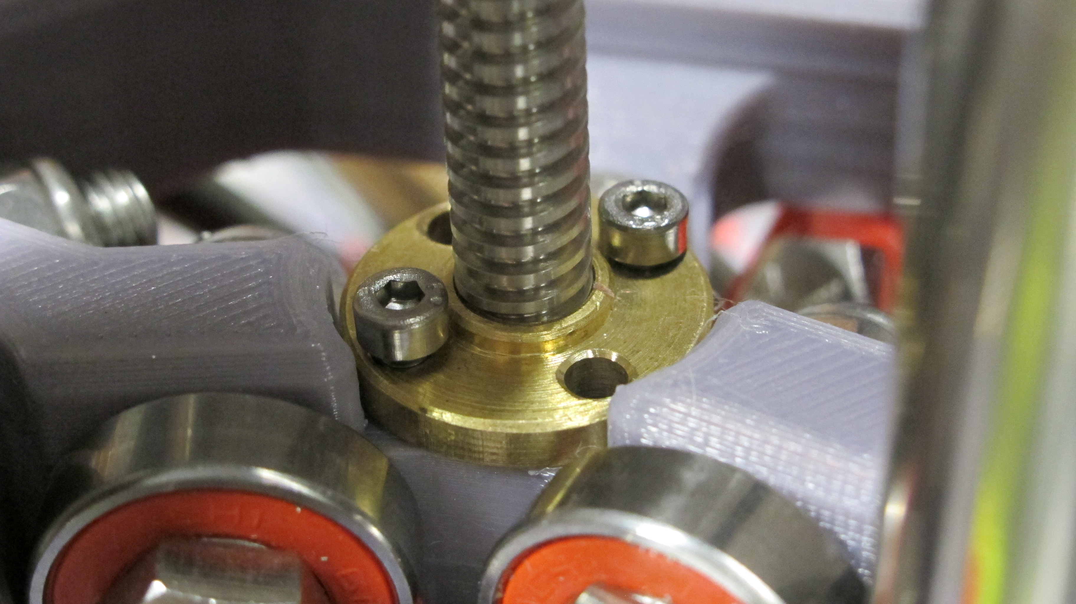

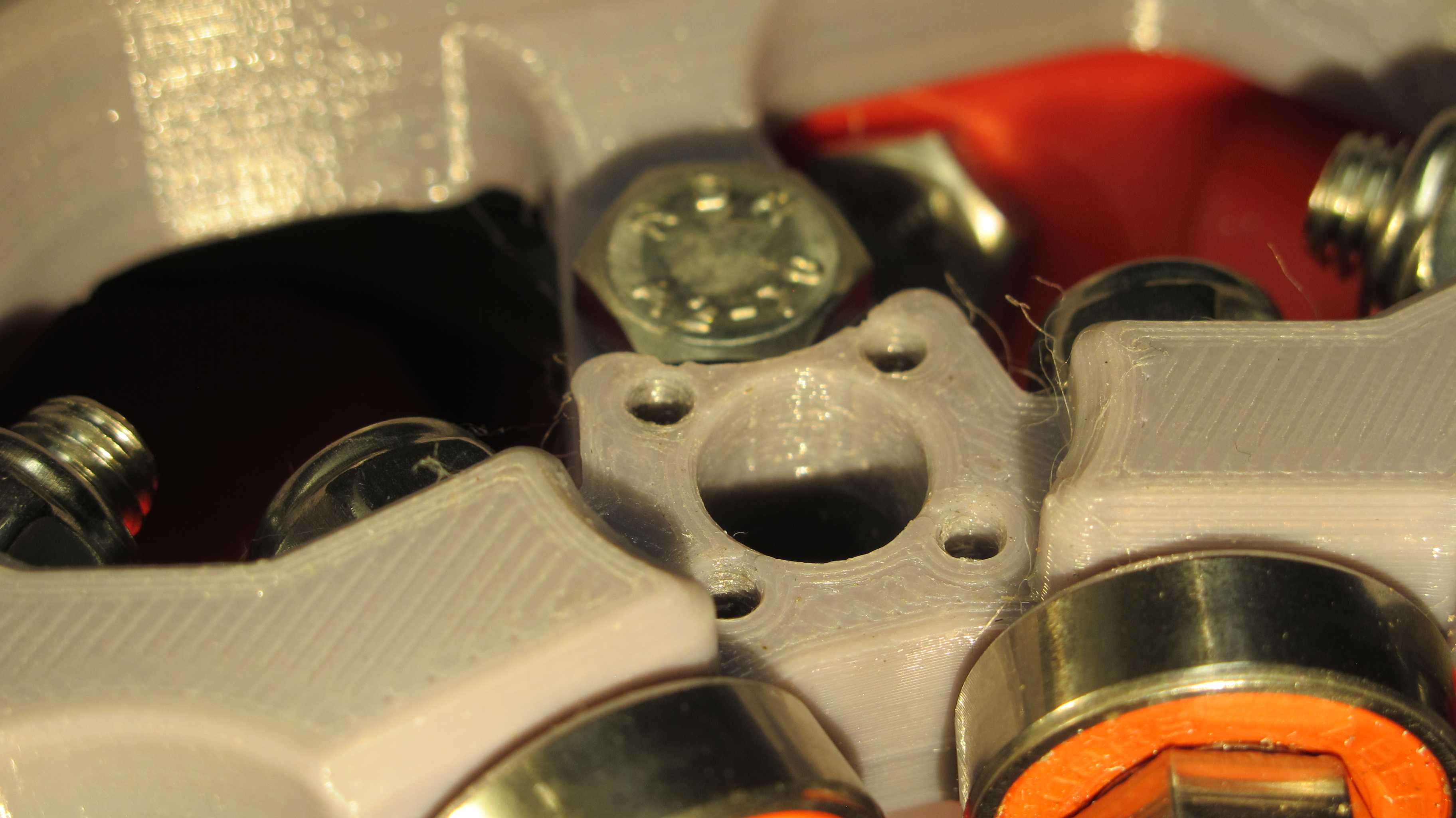

It looks like there is an asymmetrical gap between your first and second pictures.
If the top of the xyz part is not flat where the leadscrew nut sits then the nut will want to cock sideways a bit and the leadscrew will not be straight when it’s unsupported. With the coupling on the top end of the leadscrew, the leadscrew will be held vertical but the nut will want to bind if it is tightened down, or even the weight of the z axis could push it enough to make it stick. Usually lube is enough but you could also try shimming or sanding the area on the xyz part where the nut sits.

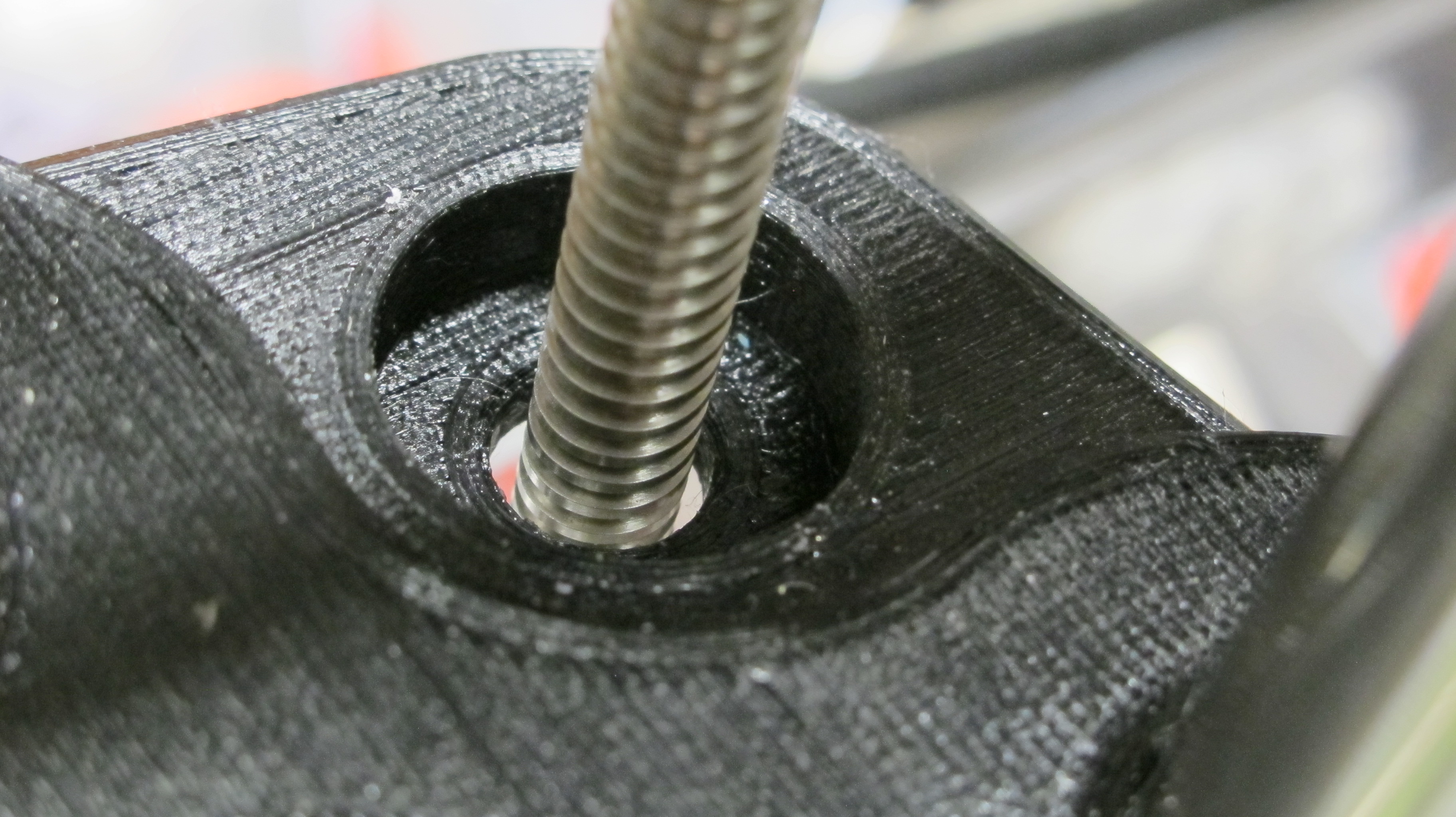

Jamie, congrats, you’ve got a very sharp and trained eye or two! Just came up from the workshop after taking the pictures below. I used a piece of thin (0.2mm) shimming feeler gauge tape to lift the lower side of the nut, et voilá, everything looks fine and moves smoothly.
After taking off the nut, I saw that its bed is a bit asymmetrical, thinner on the hanging side. Maybe due to the printing / slicing / ion storms, whatever. It is difficult to picture that, here are some attempts.

I think just sand it. A shim would work but has more chance of getting loose and jamming everything up. Sanding (or an Xacto blade or something) is a clean, low-risk finished product assuming you can reach all the areas you need to reach.

I was thinking coarse sandpaper with your hand. Coarse meaning 220 or lower. Sand a bit, test fit, then sand more, test fit, until you’re done. You won’t accidentally generate enough heat to melt the plastic.
Success.
The seat of the nut is a pretty narrow niche. So, accessing it with sandpaper was not really the way to go.
The next step was to use a medium coarse file. Better, but did not reach the concave recesses of the nut’s resting plane.
What do I have a collection of sharp chisels for? Not only for woodwork, scraping the PETG off was a charme - very fine layers came off, a narrow and a wide tool led to a perfecly planed and trimmed surface, and the leadscrew aims directly at the top bearing’s opening now. Smooth rotation, goal reached.
