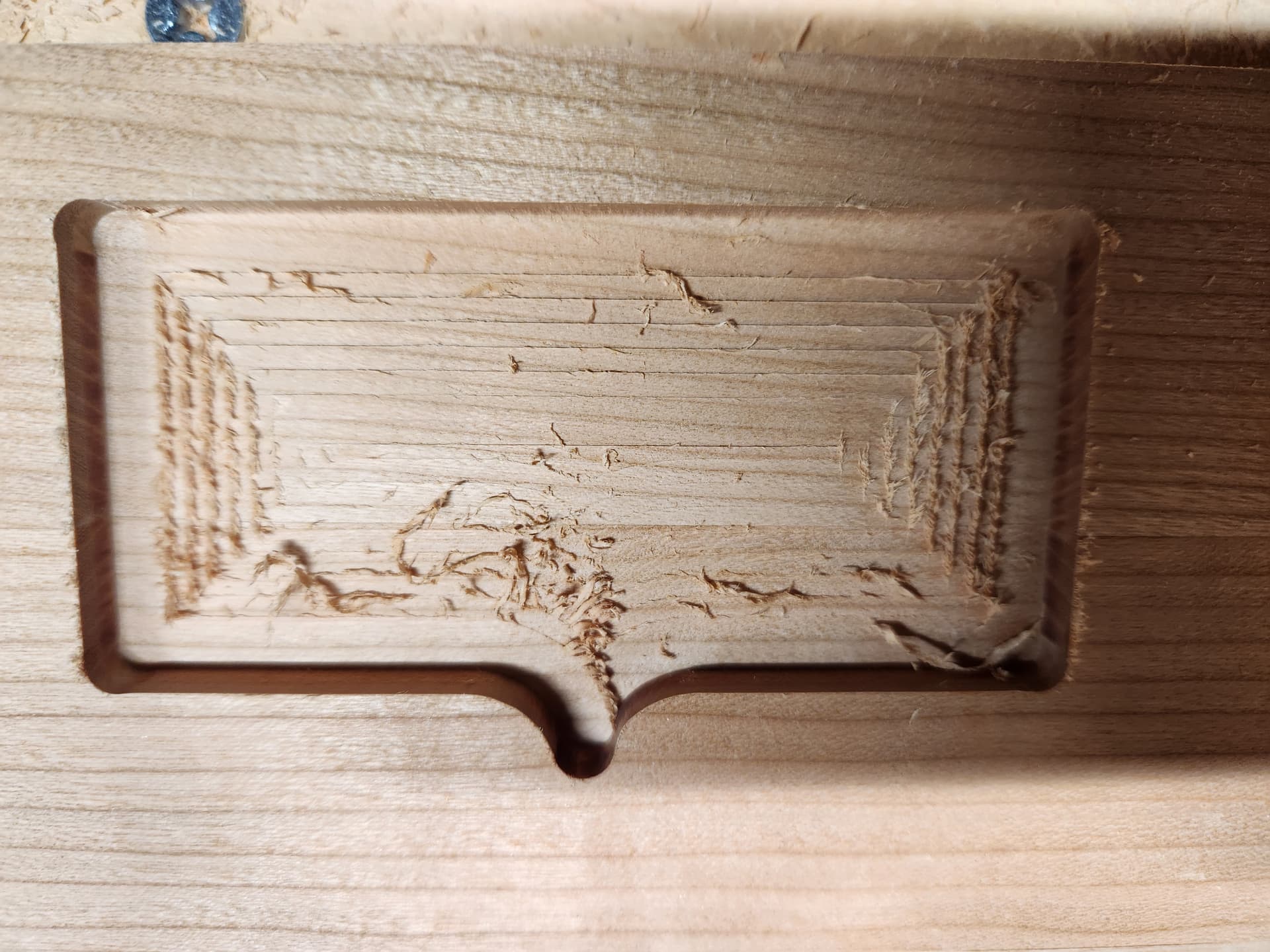

I think I know what is going on here, but wanted to verify. You can see in the image that the pocket is getting deeper as it does each pass. It starts at 4mm in the center and the edges are close to 7mm deep. I am using a 1/4" single flute spiral upcut bit. I noticed some burning and think a dull bit is grabbing when it starts the next step over and the upcut bit is pulling down and loosing steps in Z. I changed to another used bit and it went away for a while and then came back. I bought a similar, but 2-flute bit locally (the only thing I could source locally) and was able to run for ~50mins with no issues. Most of the topics with skipping steps I have seen are X or Y, not Z, so I wanted to check if this is plausible or if I should be looking for another cause. This is a MPCNC primo, ~16 x 21" work area, feed rate of 800mm/min X,Y and 300mm/min Z. DOC 4mm.

Okay, all the rest does not sound wrong, this should still not be the reason. I cut with a dull bit for ages, what is going to happen is that your parts do not have a nice edge any more, but that’s it more or less. Or it is going to skip steps, but pulling down would be a first.
As you said: Check the grub screws, that is absolutely a possibility. Besides that I am all out of ideas after having had like, one… :sweat_smile:
I agree with this. How firmly is the workpiece attached to the spoilboard? I’m wondering if it is lifting. An upcut bit can do that.
Thanks, I will check for issues with grub screws and the coupler. The workpiece is held down well and is also quite heavy.
This is why I thought an upcut bit could also pull the Z down, either skipping steps or causing something to slip.
Yea, I mean it’s going to apply downward pressure but if that is causing skipped Z steps, there is something else going on.
Also check that the bit isn’t pulling out of the collet. I’ve had that a bunch before and it causes the exact symptoms described.
Thanks for the ideas. I will take a look and report back what I find.
I check the grub screws and gave them a tighten, but they seemed to be pretty good. I ran another pocketing job and it worked fine. Not sure what is going on, but I am about to upgrade my primo to an LR4, so I probably won’t put too much more time into this one. Thanks again for the ideas.
This issue followed me to my LR4. Turns out it was the bit slipping in the collet as @jono035 suggested. I marked the bit and sure enough it had pulled out several mm.

I am going to add another solution to this one. While remaking this tray, I cut the first pocket fine but while it was cutting the second one, it started going deeper again. This time it turns out that the router had gotten pretty hot and the PLA holder must have softened and stretched out, so the router was slipping down. Now there is no gap in the holder, so I will need to reprint it.
