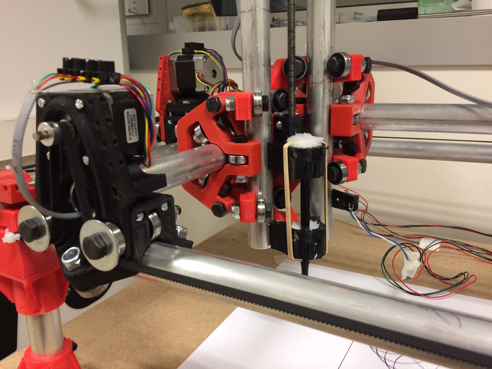

Hello,
About Z axis and these Z endstops, something is not clear to me. Min endstop (for homing)should be downside /on the table, and then the positive move of z would be up?
Or Z endstop min should be on close to the lower part of z tube for example, switching Home when Z goes up, (as on picture joined) and the positive move of Z would be down?
As it’s both Printing (work moves z up) and Milling (work moves Z down), I’m a little confused here…
Anyway, it’s start to work really fine, i’ll send more pics and vids
Fred
I’m sure you’ve seen me say it a few times, but really, leave the endstops out of it for a while. There is plenty to learn without dealing with endstops. It is extremely easy to position this machine by hand to exactly where you want it to start.
Physically move the machine to exactly where you want 0,0,0 and hit start. If you use endstops you need to worry about moving them for every single thing you do. Endstops are only efficient if you are doing multiple parts, or only ever doing one task (printing), z touch plate is useful for multiple bits in milling but does nothing for printing.

Ok ok, I was thinking of using the endstops for homing quickly and easily after startup, then run whatever needed, as I won’t be the only one to use the machine. Coworkers here seems really eager to test it, especially the milling part.
