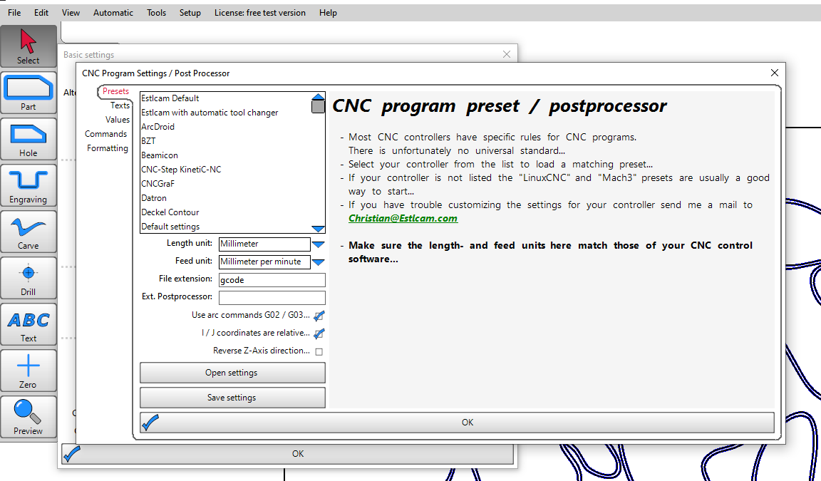

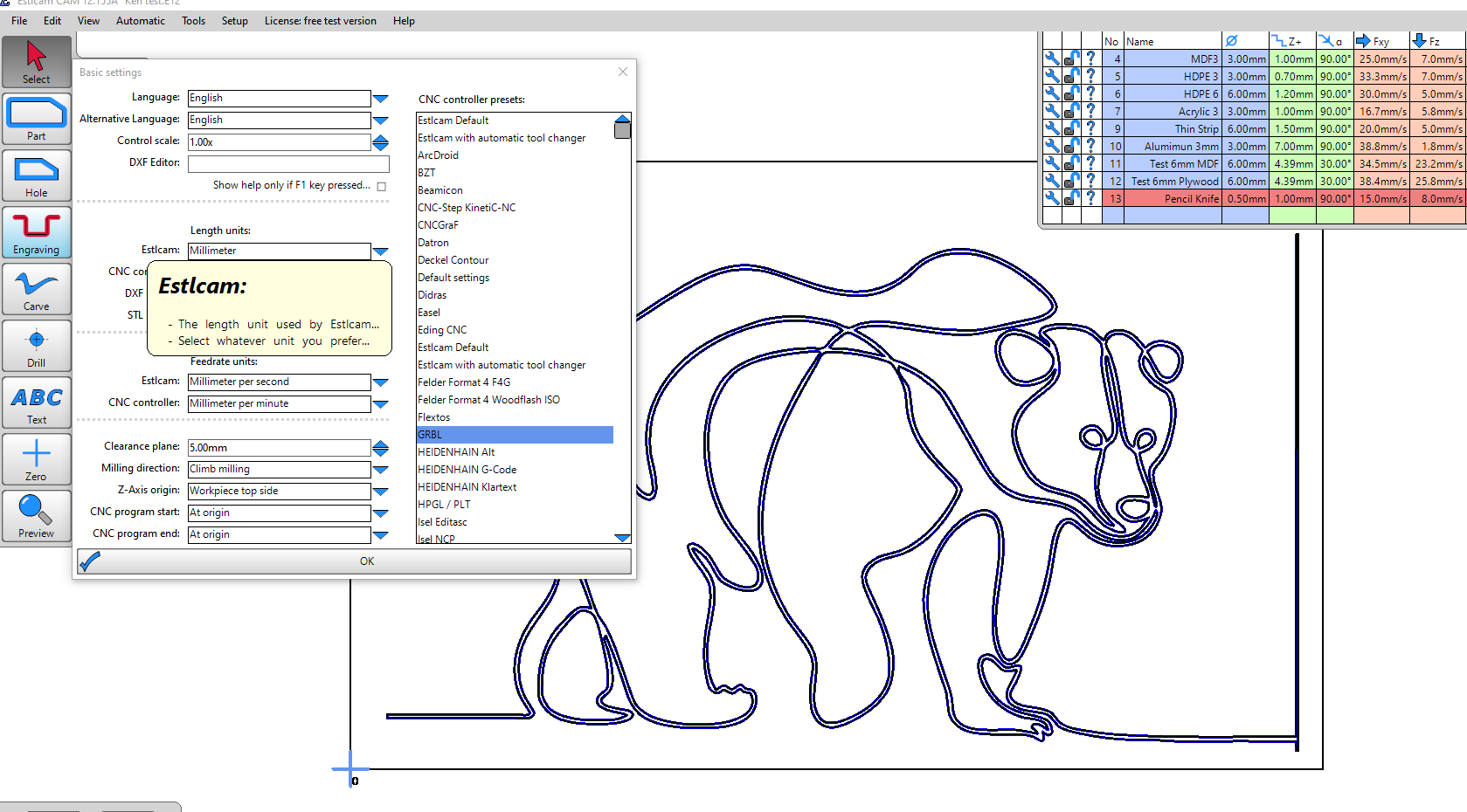

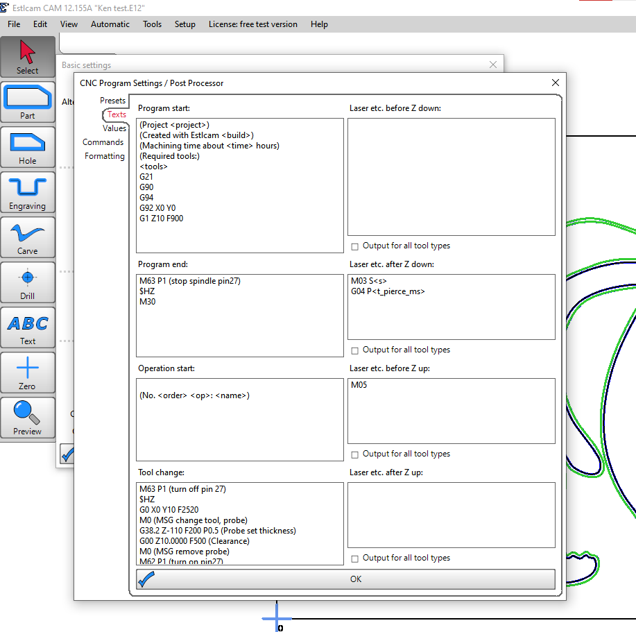

When I run the crown GRBL gcode from V1 engineering machine runs fine but when I do my own pencil gcode the Z goes down for some reason - Can someone please help me out to figure what I am doing wrong in my setup of Estlcam .Thanks

You never set 0 for Z, your G92 only does X and Y.
Change this into
G92 X0 Y0 Z0
Then 0 will be where your pen is at the moment you run the code.

Thanks - I added this and it works
G92 X0 Y0 Z0

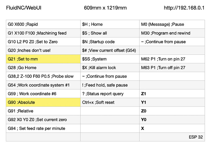

Just a thought. I found it helpful to add";" and a brief note to remind me what each command code does. I know it may seem silly but just after a while you get to know each quickly without but helps in the beginning:
Here is your same commands but with added notes the the machine does use but for us humans.
G92 X0 Y0 Z0; Set current position to zero
G21; Set units to mm
G90; Set to Absolute
G94; Set feed rate per minute
G92 X0 Y0; Set current
M0 (MSG Attach probe); Message pause
G38.2 Z-110 F200 P0.5; (probe down set thickness of 0.5)
G1 Z10 F900 M0 (MSG Remove probe); Move to Z10 F900
M62 P1 (If used start spindle pin27 )
I made this cheatsheet and keep next no my machine and computer as a help.
Would appreciate the experts to add or correct to my sheet. :grinning_face_with_smiling_eyes:
