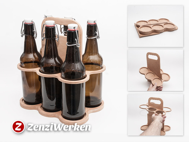

Getting some easy projects out of the way might be helpful, just to get the common, easy problems figured out first. If you haven’t already, drawing the crown, first from Ryan’s gcode file and then from doing the EstlCAM work yourself, is a really good idea. Then make a 6 pack holder from 1/4" ply and decide if you’re ready for this project. Just my $0.02.

Can you point me in the direction for some of the easy projects, specifically the 6-pack holder?

Not necessarily easy, but a skill builder, for sure. The slots are for a specific thickness of board, so the whole thing should be scaled for that thickness, or finessed after it’s cut.
