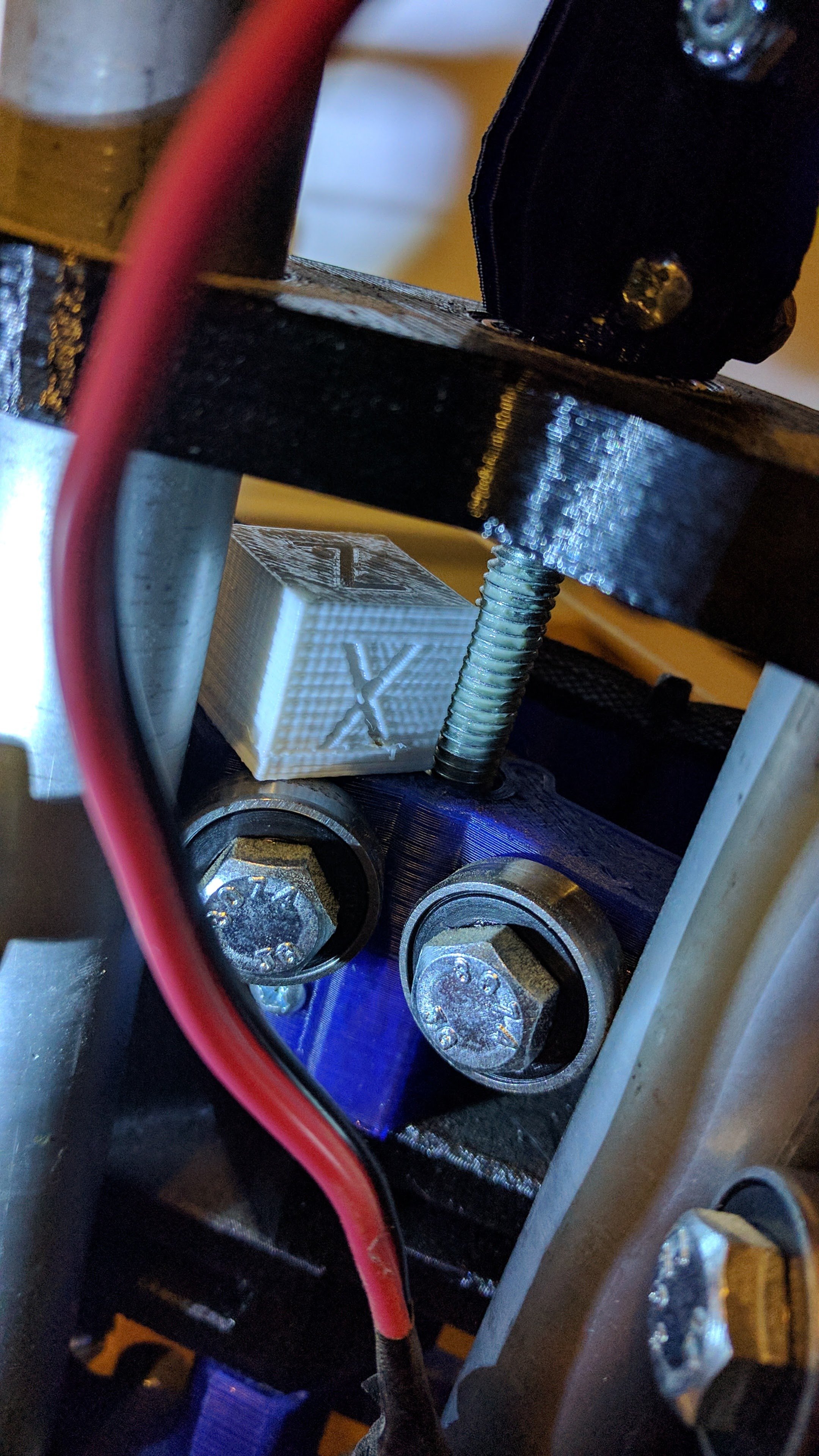

I’m decently bad banding in the z direction. The spacing of the bands lines up perfectly with the leadscrew, so I’m thinking it has to be related. I think the leadscrew is slightly bent and is causing the extruder to wobble once per revolution. Has anyone else experienced this? Is there a good way to fix it (I could maybe find a way to straighten the rod)? Most of my printing is structural, and since this is mostly a cosmetic flaw, I don’t care too much.
[attachment file=“32779”]

Could be a bent rod, or it could be crooked in your coupler.
The other thing is one side is always more true than the other. I ship them as they should be used. I spin them in a drill. I send them with the coupler nuts on the end that should be down and the other end should go into the coupler. I am sure you don’t remember how I shipped it so you might want to take it out and chuck it in a drill and find which end spins more true.
I get the highest grade my supplier offers before stainless steel and test spin and run the nuts up and down each one. You should have a true end.
Thank you. I’ll flip it around tonight and see if that solves the problem. You’re correct, I didn’t pay any attention to where the nut was on my screw, so there’s a 50% chance I installed it the wrong way.
