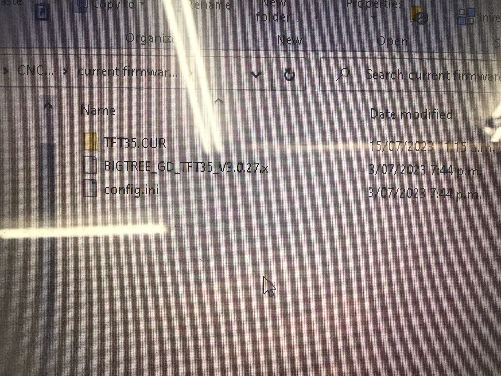

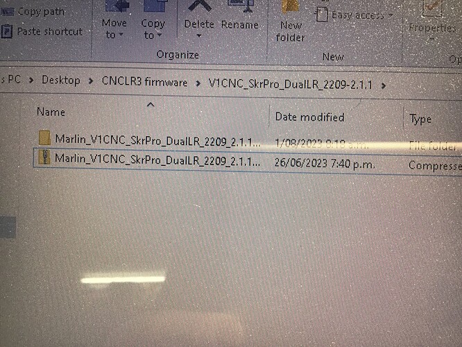

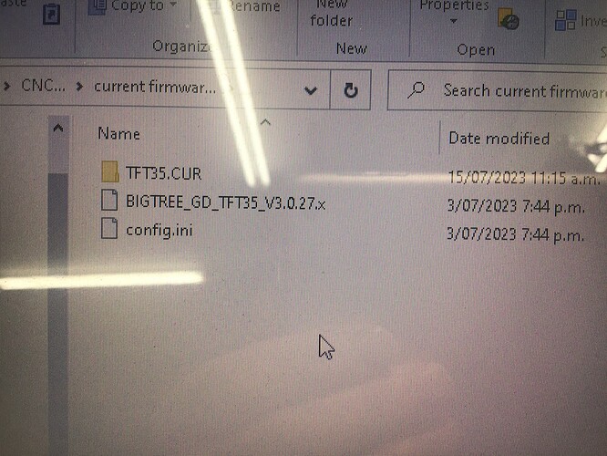

Hi all I have been trying to get my z probe working. I know it is some thing simple I have done or not done.my board is SKR pro and firmware Issa in pic
My probe works if I use M119 but I cannot set ZAxis
Are you usins G38.2 Z0?
That is a pic of your screen firmware not the board firmware.
Sorry getting a bit frazzled
No I am not using the G38 code where do I input it
I am using estlcam 11 , I would like it to set the z0 every time I use it thanks
Check out this page. Read your way thought and you will get to a section that has the different gcode to set in estlcam for start, tool change and end. This will have you probing each time.
If you just want to see it work then go to the terminal and type G38.2 Z0. The LR3 will start going down until it hits the probe. If you are just hitting the button for home then its going to go up and hit the endstops. Because we home the machine this way we have to use G38.2 to do probing. The gcode on the milling basics page has that. Make sure you are on the lowrider tab when you get to that section, then copy and paste it into estlcam and make sure you save afterwords.
