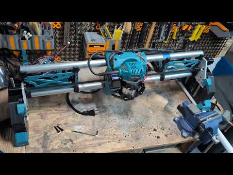

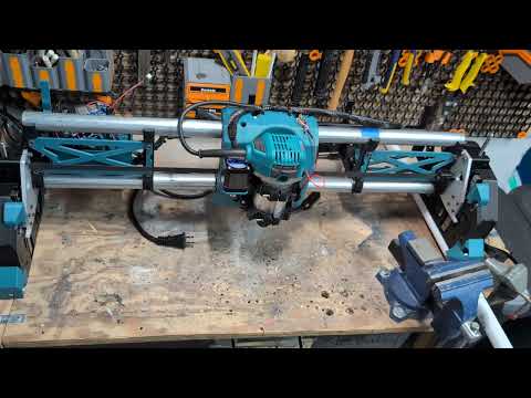

First off, my apologies for not starting a new thread previously. I jumped the gun without reading the rules and deserved the “smackdown” I got for it!
I’ve been 3d printing for a long time but this is my first foray into CNC. My build is a brand new LRv4 with a Jackpot3. It’s not permanently mounted yet, but I’m doing some bench testing to be sure motors are turning the right way and everything is happy before buttoning up the control box. I’m using only the FluidNC UI with all the default settings.
X axis works perfectly. Y axis is not ready for full testing yet, as the belts aren’t strung up, but the motors turn fine. The Z axis, however, is exhibiting some strange behavior. I can jog the two axes up and down ok (most of the time, more later). Homing is where things fall apart. It works fine maybe 30% of the time. The rest of the times, one side stops mid sequence. The motor that stops appears to have lost power since I can rotate the Z screw by hand at that point. The only way I have been able to recover is to cycle power to the Jackpot. I switched the motor and end stop connections at the board, and the problem shows up on the opposite motor. You can see the action in this video:
I’ve checked extensively for binding or interferences and so far found none. I have also verified that the XZ plates are parallel and the X axis tubes are level. In this video you can see smooth motion through the Z axis range when jogging 10mm at a time. In this case, the Z motors and switches are plugged into to their normal connections. When I go to move 25mm, trouble starts. Downward motion is fine. When moving up, Z1 starts to have trouble, while Z0 moves normally. Z1 stops with a grinding noise. No error is thrown. A second25mm command and both motors move normally again, although they are no longer in sync. The grinding appears again on the third 25mm motion. Homing brings them back into sync this time. The rest of the video shows a repeat of the same issue.

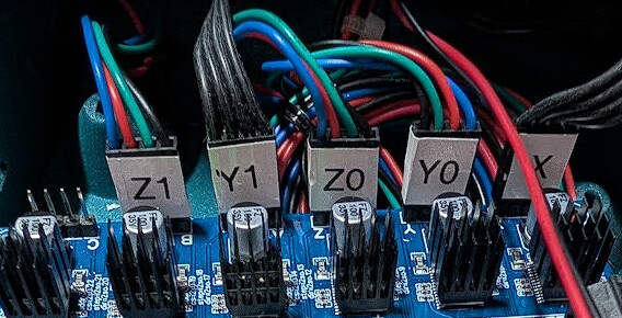

Again, I switched the Z connections, motors and end stops, at the board and the problem moved to the other side.

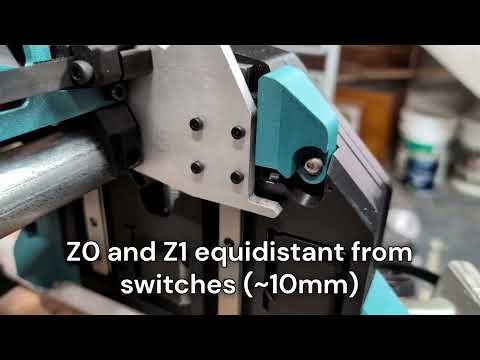

I will note that the Z tensioner screws are in place, but loose, in all but the last video (you can see them sitting on the table). I did go back and run all the same tests with them completely removed. The results were the same.
At the risk of influencing opinions, it seems to me that since the same problems move from one side to the other when swapping board connections, that indicates that the board itself has an issue. Everything else remained the same.
Any advice would be appreciated!

This sounds an awful lot like a loose wiring connection, probably at the motor wire/extension cable connection. Did you use an S-bend at the connector, as shown in the documents?
@Britt SuperLube. I wanted to use lithium but didn’t have any at the time. I can see that maybe helping with the grinding noise, but not the stopping during homing problem.
@Bartman I was thinking that as well, but if that were the case, the problem would stay on the same motor when I swap connections at the board. Instead it switches to the other one. If I can put the motor on another port without changing anything else and it works, that would indicate that the wiring and motor are ok. Good suggestion though!

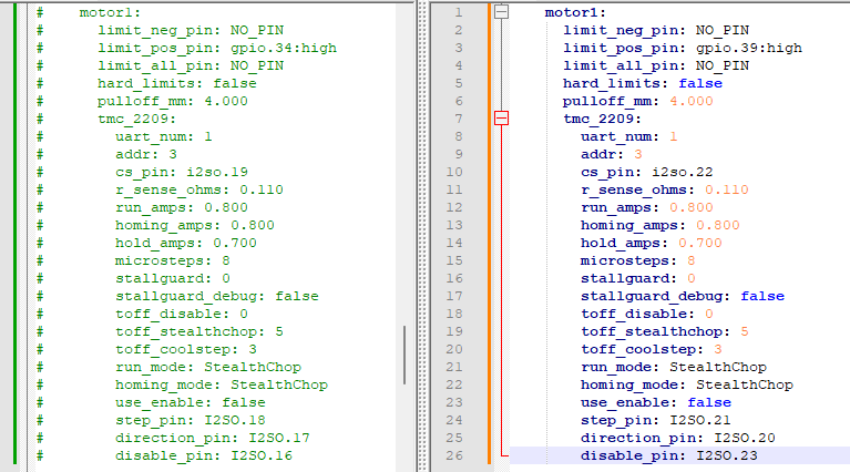

Here is a config with Z0 switched to the C driver and the endstop on gpio.39.
config.yaml.zip (2.0 KB)
Here is a config with Z1 switched to the C driver and the endstop on gpio.39.
configZ1-C.yaml.zip (2.0 KB)

Well, unfortunately neither of those config files worked. With either one, I could move X and Y, but Z won’t budge.
Using your basic idea, though, I grabbed the default yaml here, commented out the lines assigning Z1 to B and replaced it with the data for C (at least I think I did!).
Using this configuration, I could move Z0 but not Z1. So again, I swapped the motors at the board, and now I can move Z1 but not Z0. Basically, whichever motor is on C won’t move at all. Here is the config I used.
config.yaml.zip (7.2 KB)

The Z1 motor is plugged into B. Did you move it over to C and try the new config?
Be sure to power down first.
Yes :+1:
Post your $SS output. That will show anything awry in the config.
I pulled four $SS outputs. One for each of the config files we’re working with. I plugged Z0 and Z1 into the ports expected for each. I’ll put each one in a separate post.
  1. The default config.yaml. Z0 = Z, Z1 = B

MSG:INFO: Motor0]
MSG:INFO: tmc_2209 UART1 Addr:0 CS:NO_PIN Step:I2SO.2 Dir:I2SO.1 Disable:I2SO.0 R:0.110]
MSG:INFO: Neg Limit gpio.25]
MSG:INFO: Axis Y (3.000,2443.000)]
MSG:INFO: Motor0]
MSG:INFO: tmc_2209 UART1 Addr:1 CS:NO_PIN Step:I2SO.5 Dir:I2SO.4 Disable:I2SO.7 R:0.110]
MSG:INFO: Neg Limit gpio.33]
MSG:INFO: Motor1]
MSG:INFO: tmc_2209 UART1 Addr:3 CS:I2SO.14 Step:I2SO.13 Dir:I2SO.12 Disable:I2SO.15 R:0.110]
MSG:INFO: Neg Limit gpio.35]
MSG:INFO: Axis Z (-147.000,3.000)]
MSG:INFO: Motor0]
MSG:INFO: tmc_2209 UART1 Addr:2 CS:NO_PIN Step:I2SO.10 Dir:I2SO.9 Disable:I2SO.8 R:0.110]
MSG:INFO: Pos Limit gpio.32]
MSG:INFO: Motor1]
MSG:INFO: tmc_2209 UART1 Addr:3 CS:I2SO.22 Step:I2SO.21 Dir:I2SO.20 Disable:I2SO.23 R:0.110]
MSG:INFO: Pos Limit gpio.39]
MSG:INFO: X Axis driver test passed]
MSG:INFO: Y Axis driver test passed]
MSG:INFO: Y2 Axis driver test passed]
MSG:INFO: Z Axis driver test passed]
MSG:INFO: Z2 Axis driver test passed]
MSG:INFO: Kinematic system: Cartesian]
MSG:INFO: STA SSID is not set]
MSG:INFO: AP SSID FluidNC IP 192.168.0.1 mask 255.255.255.0 channel 1]
MSG:INFO: AP started]
MSG:INFO: WiFi on]
MSG:INFO: Captive Portal Started]
MSG:INFO: HTTP started on port 80]
MSG:INFO: Telnet started on port 23]
MSG:INFO: Probe gpio.36:low]
I see 2 of the 4 $SS posts show each axis as: TMC driver not detected - expected 0x21 got 0x0]. That only happens if you have the USB connected before you power up the Jackpot. You have to power up before you plug in the USB.
Well, I’m gonna have to go ahead and disagree with you there on that being the only way.
I loaded the yaml, disconnected USB, cycled power, waited long enough for the WebUI to re-establish connection, then plugged the USB back in. Opened FluidTerm, sent a $SS, and that’s what I got. Went back and redid it twice for both configs just to be sure I did it that way.
