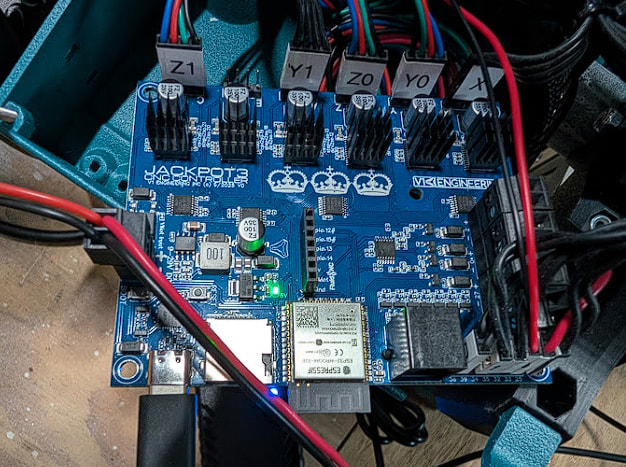

Z axis problems - new build

Sorry nothing crazy is poking out at me but lets start with the basics. 2 things to try.
Might as well use the jackpot firmware erase and reflash load up the fresh files, just to be sure.
next would be to move your Z enstops down more. The first video shows you homing super high up and it might not be triggering well enough because it is hitting the stop.
The Z not working in the C port…we can look at that later but we can also try moving the Z endstop plug…but try the other two first.
You’re right about the end stops being too high, at least on Z1. The hard stop was broken! So I lowered them a bit even before reloading firmware.
So after loading firmware I jogged Z through it’s range a few times, homed it several times. It looked really good! :grin:
Right up until it didn’t. :tired_face:
Z1 stopped at the switch during homing just like it did before. At that point I could rotate the lead screw just like before. And just like before, cycling power got it going again, only for the next home sequence to fail again the same way, so I stopped there.

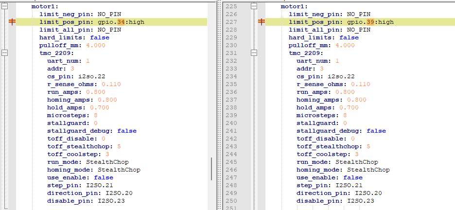

I’ve swapped the z motors and switches at the board several times and the problems always move from one to the other. That’s what leads me to believe the board is the issue. If a cable, motor, or switch was bad, I would expect the problem to stay on the same component.
I’ve tried building a yaml with Z1 moved to C, but I’m not sure I did it right. Do you have one I can try?
configBCswap.zip (1.6 KB)
This one should do it.
I am not seeing anything crazy in the schematic. I routed the A port nearly the same.
First thing I did tonight was compare your BC swap yaml to the one I made, and the only difference was that I had moved the end stop switch and you didn’t. But that didn’t really tell us anything except that I did a halfway decent job of interpreting the code. :slight_smile:
So I fired up the machine to check it out before loading the new config and got no motion at all. I could connect via wifi to the WebUI and via FluidTerm via USB, but that was it. The data on the settings tab looked like it had reverted back to a Fluid default or something. There was data there, but nothing under the Name or Meta flags where I would expect it to say LowRider and 11-01-2025 RyanZ.
I loaded the new config through FluidTerm and rebooted. It took a couple of attempts to get it to take, but it eventually did. In the process, I sent a few $ss commands to grab some data. Guru Meditation Error? :flushed_face: Holy shnikes! I haven’t seen that since I had an Amiga 500! :old_man: What is going on? You can see the results attached. At another point, the $ss output was clean, but the WebUI said “Alarm” in the status window with no other information. The terminal output from that is also attached. Maybe you can tell me what was going on there?
Anyway, eventually I got it running on the new config, Z0 on Z, Z1 on C. But again, Z0 moves, Z1 does not. So I swapped them, and Z1 moves, but not Z0.
Just for giggles, I then swapped Y0/Z0 and Y1/Z1. In this case using C for Y1. As a cautionary move, I set “Y” (which is now connected to the Z motors) to 1mm moves. The two Z motors moved together as intended. Y0 moves when I issue a Z command, but Y1 does not. I then swapped Y0 to C and repeated the test. Now Y1 moves, but not Y0.
Basically… anything I put on C doesn’t work. I didn’t bother checking the end stop switches. When this all started, I was 90% certain there was a problem with the board. Now I’m 100% convinced.

No, nothing has changed. B is problematic, and C doesn’t work. The only error I’ve seen in webui terminal indicates a lack of an SD card. Which is true. Please tell me that’s not what’s causing this! :slight_smile:
Assuming that’s the same procedure you linked back in Post 27, I have tried that, but I di it again just to be sure. Here are the results, using the preformatted code option which I just learned about! Buckle up. This is gonna get long.
To verify everything was as I left it yesterday, I fired it up and checked a few things. Luckily, no Guru Meditations or Blue Screens of Death or whatever UNIVAC called an unrecoverable error. Whew.
Here’s how the motors are arranged:

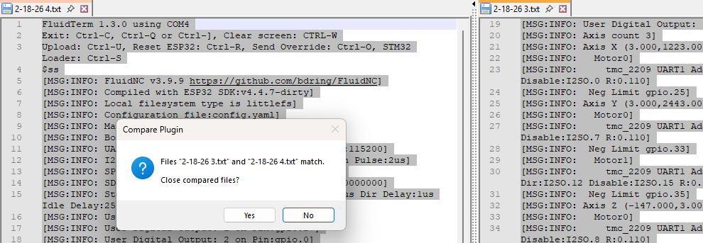

Here’s the startup log:
FluidTerm 1.3.0 using COM4
Exit: Ctrl-C, Ctrl-Q or Ctrl-], Clear screen: CTRL-W
Upload: Ctrl-U, Reset ESP32: Ctrl-R, Send Override: Ctrl-O, STM32 Loader: Ctrl-S
$ss
[MSG:INFO: FluidNC v3.9.9 https://github.com/bdring/FluidNC]
[MSG:INFO: Machine LowRider BC swap]
[MSG:INFO: Board Jackpot3 TMC2226]
[MSG:INFO: UART1 Tx:gpio.16 Rx:gpio.4 RTS:NO_PIN Baud:115200]

Right. For good measure, I disconnected from the website terminal and fired up FluidTerm on my laptop, $ss, and away we go…
$ss
[MSG:INFO: User Digital Output: 2 on Pin:gpio.0]
[MSG:INFO: User Digital Output: 3 on Pin:gpio.2]
[MSG:INFO: Axis count 3]
[MSG:INFO:   Motor0]
[MSG:INFO:  Neg Limit gpio.25]
[MSG:INFO:   Motor0]
[MSG:INFO:  Neg Limit gpio.33]
[MSG:INFO:   Motor1]
[MSG:INFO:  Neg Limit gpio.35]
[MSG:INFO: Axis Z (-147.000,3.000)]
[MSG:INFO:   Motor0]
[MSG:INFO:  Pos Limit gpio.32]
[MSG:INFO:   Motor1]
[MSG:INFO:     tmc_2209 UART1 Addr:3 CS:I2SO.22 Step:I2SO.21 Dir:I2SO.20 Disable:I2SO.23 R:0.110]
[MSG:INFO:  Pos Limit gpio.34]
[MSG:INFO: AP started]
[MSG:INFO: WiFi on]
[MSG:INFO: Probe gpio.36:low]
ok
