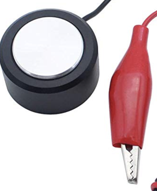

I look into this forums and many videos but I could find the exact wiring position, I have a MKS Gen L V1.4 (using Marlin/Ray firmware) and a cheap probe I bought for 5 bucks, the probe has two wires (probe and Alligator clip) the board has a Z- and Z+ slots with (S - +) pins, I have the stop end all in connect to (S and -).
1- Which pins and slot should I use Z- or Z+ ?
2- Probe and Alligator in which pin?
I got this code in the forum/thingiverse link so I have to insert this in the beginning of the g-code of the project? Z19.3 is the hight of the probe. It means every time I run a g-code I have to insert this lines?

Z-, (-) and (s) pins. Don’t connect to (+) or you can damage the board.
For G38.2 to work, I think you need to enable that in the firmware.
Check with M119 first to see that this is working.
Hi Jeffeb3, where should I find in the firmware G38.2 ? The M119 is to check if G38.2 is working? I could not find this command related to G38.2 in reprap webpage.
http://marlinfw.org/docs/gcode/G038.html
Looks like G38_PROBE_TARGET.

I think you need to configure the z probe. There’s a ton of information here:
But I think you really just need to enable Z_MIN_PROBE_USES_Z_MIN_ENDSTOP_PIN and FIX_MOUNTED_PROBE.
Hi Jeffeb3, just return… I uncomment both lines in Marlin, I was looking in other topics and found one with your answer:
you wrote ‘‘G92 Z1.4’’ for the height of the probe, in my case is 19.3mm. I can’t figure out where should I insert this value in Marlin?
Try to find youtube videos but no one specific to MPCN.
G92 Z19.3 is what you want.
@barry99705, yes I understand, but where should I put this? I can not find in the firmware. Maybe is not in the firmware, sorry I am completely lost :frowning:
Have a look at the milling basics page. I have an example starting gcode in there. You can do it in the firmware but I prefer being able to easily change it per job.
I wii take a look, what you say is that I should put this in the g-code instead of the firmware everytime?
You have options, I prefer Gcode.
