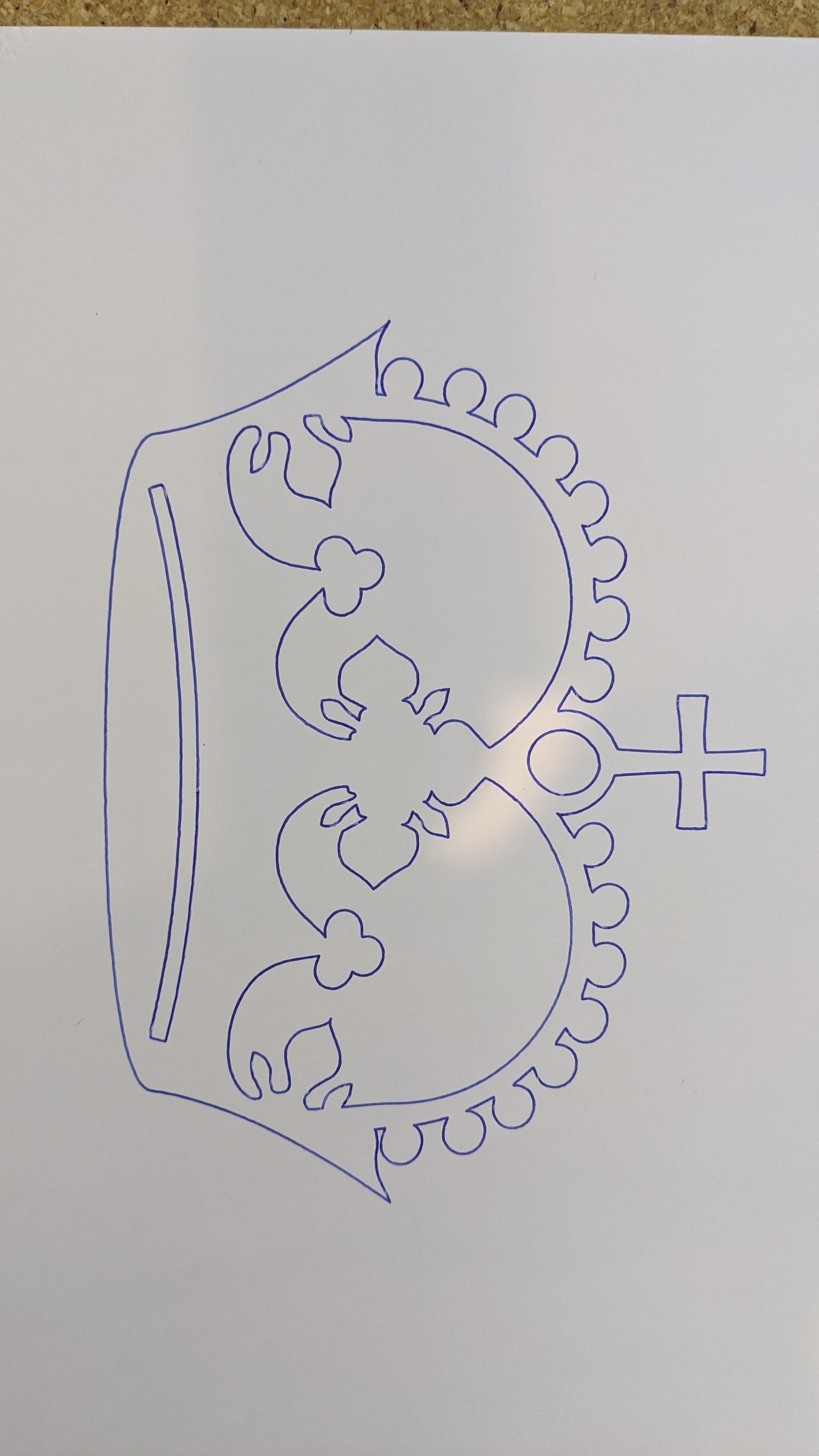

IT WORKS! IT WORKS! IT WORKS!
So definitely the connections at the board. I found I needed to press a bit harder, plus I added a small dab of hot glue on the plastic parts to keep it from popping out; something we do on servo wire extensions for rc planes.
I raised the z axis up a bit and ran the crown test and ran fine.
Now on to more test and practice!!
Successful crown test
