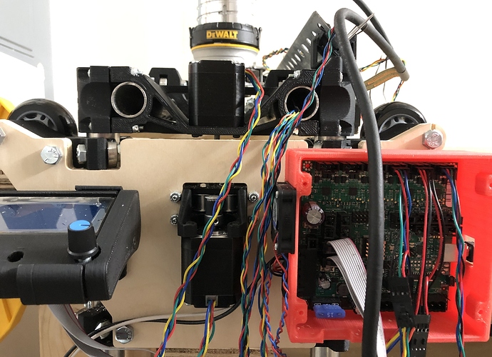

So I have combed through a lot of other posts with similar problems, but haven’t found one with results that help my situation. The rolling part of the structure is level, but the cross piece that holds the z motors is not level which makes the x axis bars not level also. The z bars are in the notches, I have loosened and retightened everything a few times. It still slopes downwards toward the x motor. Any other ideas on how to make it level? Reprint the parts? I got mine from Ryan so I figured they should be good. Is there a way to measure or test them to see they are printed correctly? Any ideas help. Thanks.
First pic is the rolling structure level, last pic is the bed level, and the middle pic is across the x bars.

My first guess is that there is some builtin twist in the long pipes and it’s causing the top to not be flat. Can you loosen the holding on those pipes? They don’t need to be tight, AFAIK.
There’s a first time for everything, but in the thousands of posts I’ve read, I haven’t ever seen Ryan’s prints to be at fault.
Both sides of the x pipes have about the same amount of sag to the right, so it seems like a slightly off print could be a possibility. I rolled the x pipes when I loosened everything, and they seemed to roll pretty easy without changing any angles.
One idea I had was to waller out the holes for the left wheel, so it could sag to bring the gantry back to level, but I’m concerned it would cause the lower z brackets or something else to drag on the bottom of the 2x4 frame. It’s not off by as much as it was before I lossened and re tightened everything, but I would like to get into some engraving so having a perpendicular gantry will be essential.
The gantry should be coming all the way down and touching on both sides. It looks like neither side is touching. Ryan will know what to do.
The only way I can get both to touch is by pressing down hard. Obviously not a solution.
I’m saying that is another symptom, not the solution. Sorry for the confusion.
Oh totally. I knew what you meant. No worries. Just trying to see what I haven’t considered yet. It seems like it would naturally want to sag to side that has the x stepper. Maybe I can try to loosen everything, and put a corrective pressure on it while tightening the screws. Perhaps that would pull it back to level?
Can I see a top down shot please.

1-The Z rails not under the XZ part’s notch (little tiny notch at the top).
2-The corners or Z brackets tightened incorrectly causing misalignment.
3-T8 nut being too tight and forcing the lead screw the wrong direction.
As Jeffeb3 pointed out it should very easily sit on the YZ rollers. If it does not try loosening the corners, t8 nut, and the Z rail tension bolts.

Try leaving it loose. Most issues are from over tightening.
I think I have been through every post about three times looking for ideas on what to check. I can grab a top down shot after work. The notches are sitting flush on the z tubes, I could have overtightened it, so I will check that, and the lead screw is loose. I can double check the z rail tension bolts and loosen if needed.

As far as corner tightness: you suggest only tightening enough so that the z tubes dont fall out?

As Ryan said, make sure the XZ Main and the XZ Side Belt and XZ pieces aren’t too tight. I had that problem in the beginning. I then loosened everything up until the Z rods fell out, put them back in and tightened everything just enough so they wouldn’t fall out. That definitely helped.

Yes, why would you need any more? These steer the Z tubes as well, are the tops the same distance apart as the bottoms?

One of the things I noticed early on, was that the z tubes didn’t stay plumb (parallel to each other) when at the lowest vs the highest gantry height. The bottom of the tubes would actually move closer to each other.
I was an aircraft mechanic for 2 decades, so tightening things down just comes naturally. To me it seems if it’s loose it’s gonna vibrate when cutting. I will loosen stuff and see what happens.

I agree Ryan, that’s why I tightened the screws. I figured with the corner brackets loose, the z bars were allowed to flex and sag inward.
Before we make any guesses lets just wait until you can try the first suggestions. We can guess all day but that just leads to a horribly confusing thread full of mostly wrong assumptions.
Top down pic.
So I spent about 3 hours loosening and adjusting and I think the original problem was from tightening the screws unevenly on the corners, thus making the outer piece of the z support “crooked”. By letting the gantry fall all the way down and bottoming out with the screws loose, gently tightening the upper screws and then raising it about 20mm to snug the bottom ones, and then snugging all the screws down very slowly and evenly, I got it all aligned pretty well. Thanks for the suggestions, Ryan you were right, it was the screws improperly tightened that did it.
